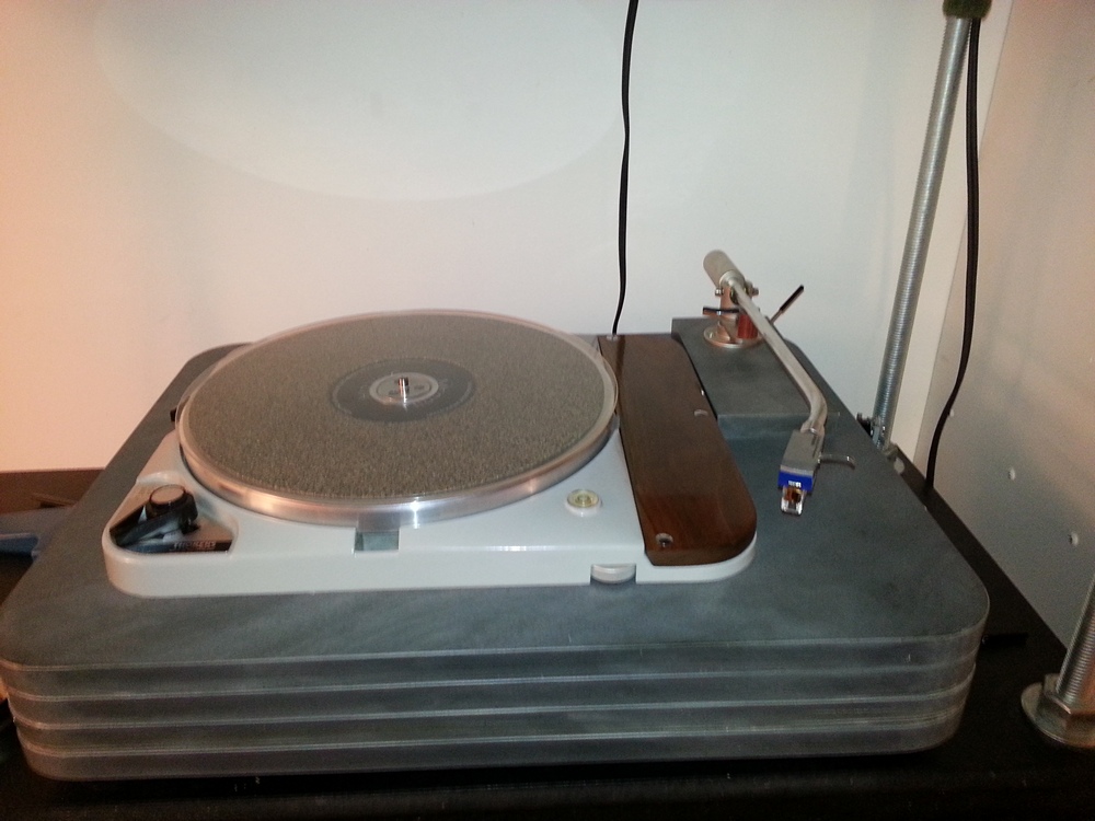

OT Comments about Arms, Cartridges, Pre-amps used with my TD-124s
The set ups the two arms reside in are so different it is impossible to make an entirely fair comparison. My TD-124/II is a rather quieter / more perfected machine overall than the TD-124/I that the SME clone resides on.
There is really no question at all that the Schick is a better arm, better damped, better bearings, better overall precision. Better sound.
The cartridge on the Schick is the top of the line Royal N SPU which is a substantially better cartridge than the Meister Silver which it replaced within hours of getting here somewhere around 18 months ago.
The Muscovite phono pre used with the 124/II / Schick / Royal N is several notches up the design and performance ladder from the Muscovite Mini II used with the 124/I / clone / Meister Silver, and there is 12 feet of interconnect between the phono and the line stage.
There are a number of issues with the 124/I relating to that POS zamac platter and the motor mounts which let a lot of motor noise through.
The 3012 clone is pleasant enough, but I suspect not exactly neutral, nor the last word in resonance free - the Meister does not shine quite the same way it does on the Schick. I would say it was money well spent given that it cost 1/3 what the Schick cost, and performs reasonably well. This arm seems to perform similarly to the stock 3012 but perhaps not quite as well. I think this arm has some HF colorations that could be damped with the addition of a little balsa in the arm tube. It is also quite possible that it is just revealing the considerable remaining warts in this TD-124. (Not to mention possibly that some of the bad things I hear could be the new phono stage which is a work in progress)
I can't really give a fair assessment of the clone arm on this TT, but I can say that the Schick was head and shoulders better than a restored SME 3012 Series II in a direct comparison around the time I first got the Schick and on the MKII table.
The second table set up is primarily what I use to develop new phono pre-amp designs so that I do not have to disturb the primary set up which serves as my reference.
Edit: Just switched to the reference set up, there is absolutely no comparison unfortunately.
Further investigation reveals that the MKII set up is cleaner sounding with the Mini, but the fundamental issue moved with the pre-amp. So more work is required.

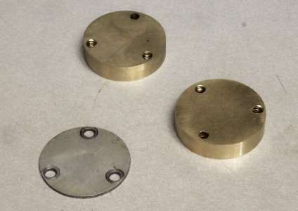

The photos tell the story well. The "flexy" end cap that the Thorens designer went with. On the examples I have there is always a slight outward dome shape to it. This may come after the turntable has some use. In the case of excessive and damaging vertical motion, (hammering) the flexy cap may become excessively dome shaped
Fwiw all of my TD124 players are of the original series (mk1) and serial numbers are not high. The raised interior of the cap is designed to force the gasket into direct contact with the internal chamfer at the end of the bearing housing bore. With some care at assembly, and care during platter assembly, it is possible to create a liquid tight seal at this point. but it is also fairly easy to have a seat where some oil seeps out the bottom of the cap.
One of the first things I did was to produce a massive rigid end cap.
With this fitted it is possible I may get a slightly different coast-down behavior than I would with the standard cap fitted. The flexy cap will certainly allow the thrust pad to flex and bend along with it. I thought it preferable to have absolute rigidity at the thrust point.
but then I haven't done any -snr- testing between the two bearing caps, so there may be more for me to understand.
-Steve
The cap really makes a huge difference IMO, I have a bronze one on the MKII, and stainless steel on the MKI.. Both run mild steel thrust plates and oem steel balls which ultimately I will replace with silicon nitride balls. IIRC the correct diameter is 8mm.
The TD124 main bearing uses a 6mm ball. this size is easy to source in very hard steels and in tungsten carbide. Somehow it is not so easy to find in si ni ceramic. the ceramic balls are readily available in .250 inch size. Which is .35mm larger in dia. than the 6mm balls. One might be able to live with that.

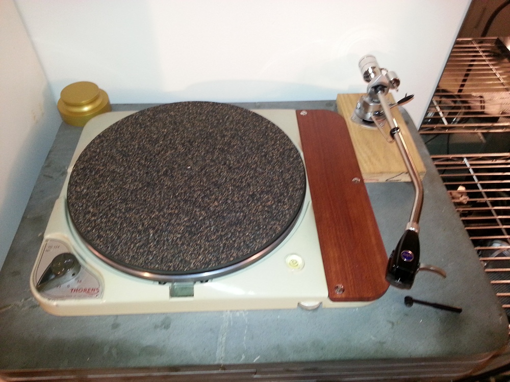

new coils from simone Lucchetti, follow-up
5/1/2014....I've had a couple of days to listen to 13943 using the new motor windings. Here are some observations about the operation and sound quality of the deck...
Above photo: 13943 on the rack. Plinth in use is for temporary utility. Tonearm: Zeta. Cartridge: DL103R SS ruby/FL and in a Uwe Panzerholz body.
13943 is in an open box plywood plinth, on the rack and playing records. No mushrooms. I've taken no measurements. When it comes to determining any increase/decrease in motor power or torque I can only note how quickly it starts up from cold, how well it maintains pace and what if any changes I hear to sound quality. During the motor assembly process and then the bushing/shaft alignment-tuning process I did notice that the motor did not vibrate quite so much as before with the older coils. This is a subjective observation based on holding the motor in hand while it runs. And also listening to the casing with a stethoscope as it runs. It does seem quieter.
From a cold start 13943 takes a couple of platter revolutions before the strobe indicates arrival at speed. When it does hit steady at 33-1/3rd rpm, it almost seems to snap in. Then, right after that episode the strobe indicates a slight amount of slowing over the next few minutes as it becomes finally steady. A few minutes only. It seems to hold speed throughout the day without any significant deviation from nominal.
Listening. It sounds just like a healthy TD124. Nice snap-to rhythm lines. It has a good sense of pace that seems rock steady. Nice open detailed and large sound fields. I've been listening to rock, classical and jazz so far.
Heat. It does run warm with the new replacement coils. Not burn-your-fingers warm,.....but warm.
