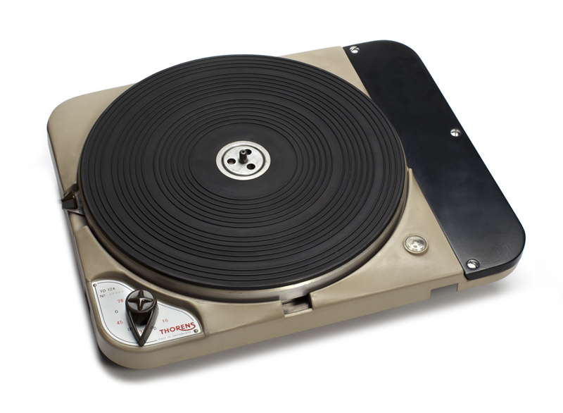

Newbie with a MK II saying Thanks!
Just a quick note from a newbie here, thanking you all for the detailed information regarding restoration of a Thorens TD-124 MK II. Since I suddenly seem to have one that's functional, serial #63138, with the original motor and second. gen. tonearm, I've got a LOT of reading to do!
Administrator
Joined 2004
Welcome to the forum! And welcome to the obsession that is TD-124.. :D
Is yours a very late TD-124 or very early TD-124/II? It's in that near transitional serial number range, but is probably a '124 if I were to guess.
Cream is the 124, gray is the 124/II as a quick way to identify the difference.
What arm is on it, and what sort of plinth is it in? Post pix? :D

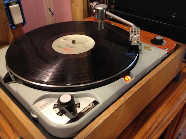

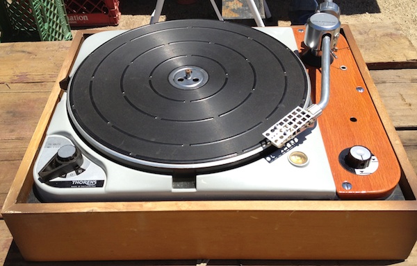

Hi kevinkr - This is a TD-124/II, gray, with the original motor. I'm learning as I go, but I've read about the "Pabst" motor and clearly I've got the original, not the Pabst.
The plinth is a joke. Apparently someone removed the turntable along with the mounting board, then dropped it into some plinth they just had handy. At least it protected the works until my friend in Arizona spotted it in a thrift store and bought it for me (think the price of a Big Mac).

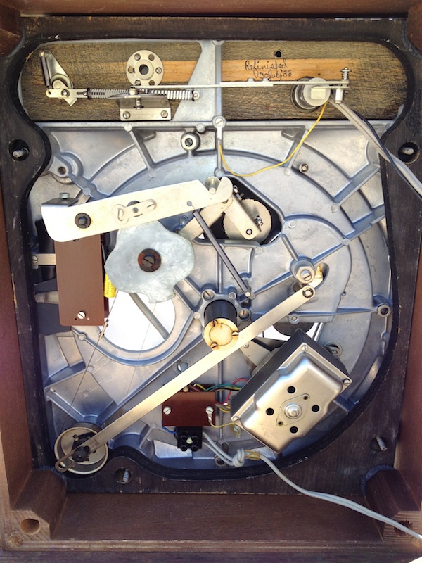

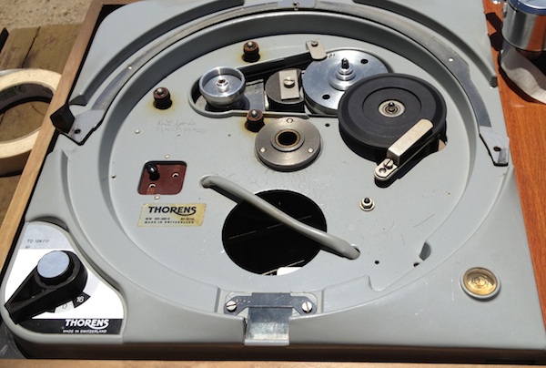

A few weeks back I was at his place, broke it down for safe transport, and brought it back to Kansas City. I took photos of it as I broke it down, and some more today as I cobbled something together to play one track on it. No more until I get into the motor obviously. Photos coming right up, once I do a little resizing.
The "Arizona" TD 124 photos
OK, here's what I know is missing on this find. (1) the arm rest; (2) the anti-skate weight; (3) the rubber bushing for one of the levelers; (4) likely a proper stylus for the un-marked Shure cartridge. I had a spare stylus for one of my Shure MK IIIs that came with a Dual, and as luck would have it, the thing fit, so that let me to a test drive.

Administrator
Joined 2004
Hi Missouricatman,
Looks very mint, and will be great when fully restored. The TD-124/II (and 124) were sold sans plinth, and arm, usually with undrilled arm board.
The plinth you have is undoubtedly original and one of the common versions out there. It is not as terrible as you think - but is a candidate for replacement with a nice slate plinth or CLD based plinth. There are a number of plinths sold on eBay that would be a definite upgrade..
The rubber mushrooms under the leveling knobs should be replaced as should the bushings supporting the motor, since you have a TD-124/II you need a kit with six bushings. I specifically would recommend going to Schopper for a replacement belt, the mushrooms and motor bushings.. Jec965 on eBay sells a great motor bearing kit - replacement is easy, just remember to oil impregnate the bearings first.
Use straight 20wt oil for lubrication, what I have found works best so far is Three In One Electric Motor Oil 20 SAE.. (See earlier posts) Look also at the discussion about rebuilding main bearings, and various cautions.. Great bearing.
Be glad you do not have the replacement Papst motor, it is generally inferior in performance to the E50 unless powered by a 3 phase drive such as the Siemens Micromaster MM410 or similar.. (Should be very good with 3 phase drive, may try this some day if I can get my hands on one.)
This is the later Thorens arm, not sure that it ever had anti-skate, but in any event it is nothing special. (Not really bad either) Depending on budget, plinth and other concerns you have eventually want to consider a 12" (sometimes referred to as a 16" arm back in the day) such as the Schick I am using. Vinylengine should have the specifics on your arm. Something like an AT-33 series LOMC should be a good match on this arm, avoid high compliance carts due to the significant arm mass.
Something you probably already know - you have a great friend. :D He scored you a near exemplary example of the TD-124/II, and as you are probably aware these command pretty high prices on eBay and elsewhere these days. You've got the heart of a first class vinyl playback setup, with some work the performance can be exceptional. I'm am pretty confident based on exposure that my set up can hold its own against some very expensive competition. :D

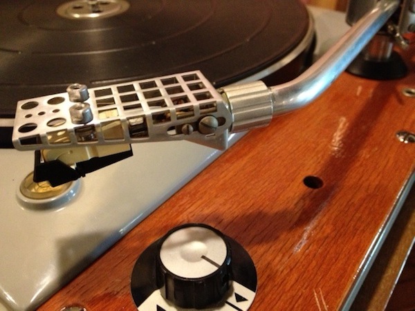

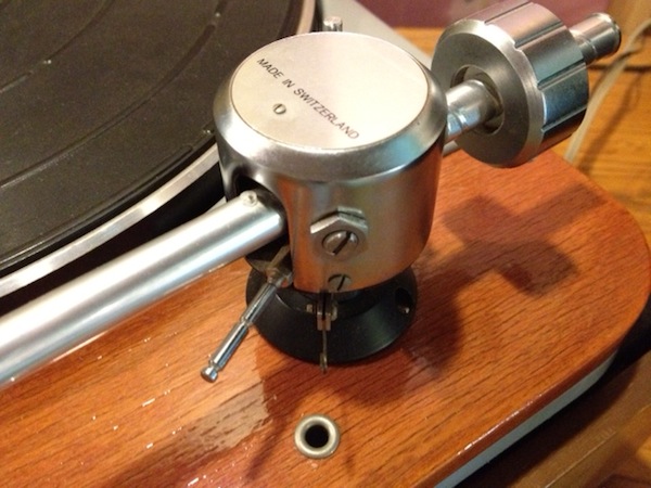

Hi kevinkr. Yes, after a little more digging, I discovered the plinth I have is original. Odd that they'd put something out that pretty much makes accessing the adjustable feet impossible. I have some woodworking skills, not to mention a neighbor who's capable of making cabinets, so my guess is we'll be working something out to replace it. Same goes for a plinth for my Dual 1219.
I've seen what Schopper's got as well as Jec965 and agree that's probably the best way to go. This arm does have anti-skate, used a counterweight (I believe two one gram weights) on a nylon string. Everything for the anti-skate is there, just not the string and counterweight, of course. (see attached photo) I pulled the specs on the arm from VinylEngine yesterday. I agree there are much better arms out there, but until I get past issues that keep me from actually putting the turntable into service, it'll do the job. Thanks for all the info.
