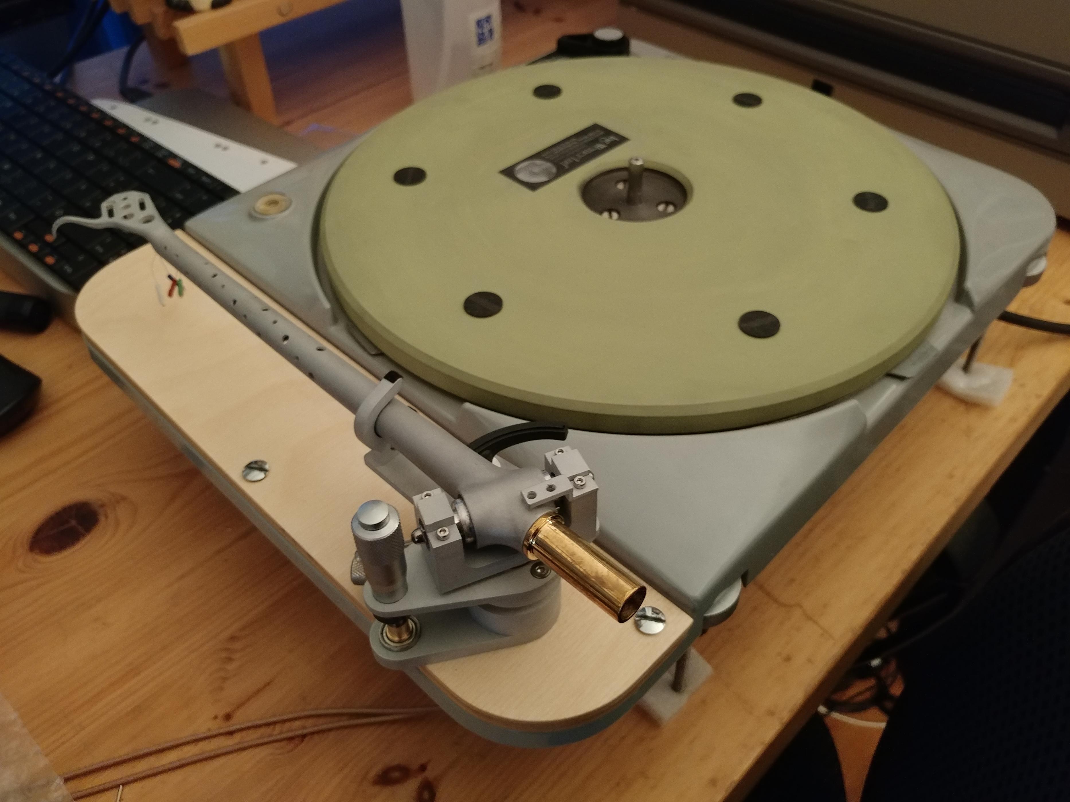

I still have not tried to attempt the chassis bend yet. I have been busy and decided to work on the plinth and motor. I have a quick question. What have people used to clean the metal parts of the motor? Can I use Brasso? The shield between the motor and pulley is very dirty. I was going to drop the other parts in carb cleaner. m
Hello mbergerooo,
Before you bend the chassis, you may want to look at the tone arm board mounting surface above the bent area. If it is flat, don't bend the chassis!
The flatness of the tone arm board mounting surface takes precedence over bends in the chassis.
If the tone arm board mounting surface is flat, the chassis may have warped during the die casting process.
Use a 12" steel scale as a straight edge.
Sincerely,
Ralf

Hi Ralf,
I did measure down from a straight edge on the platter. The armboard casting may not be off by very much at all. I am waiting until a drop it into the CLD plinth I am building now. That will help me nail down exactly how much of a problem I may have.
I also have woodworking skills and may just shape my armboard to compensate for the casting issue. But only if it doesn't look terrible.

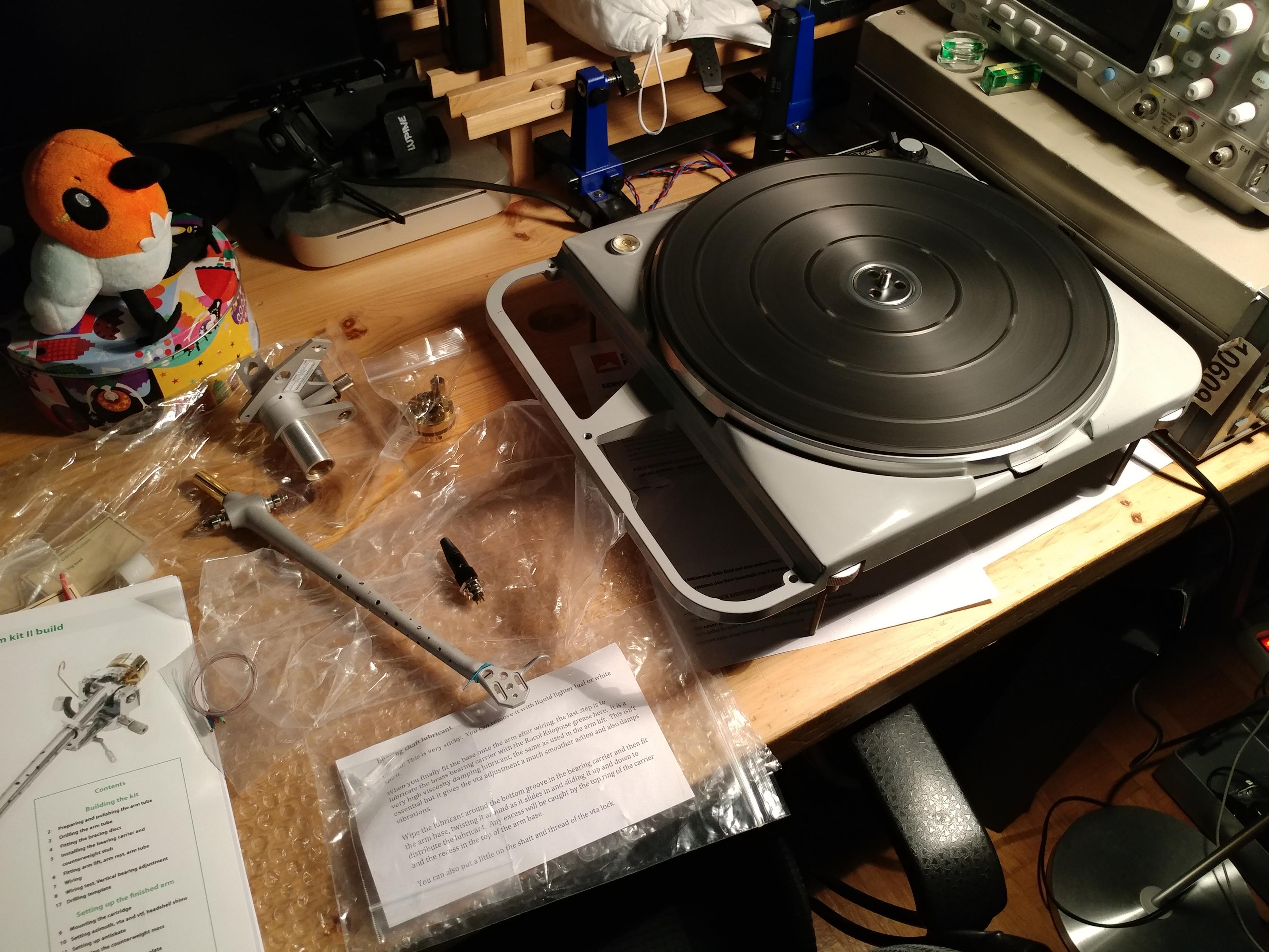

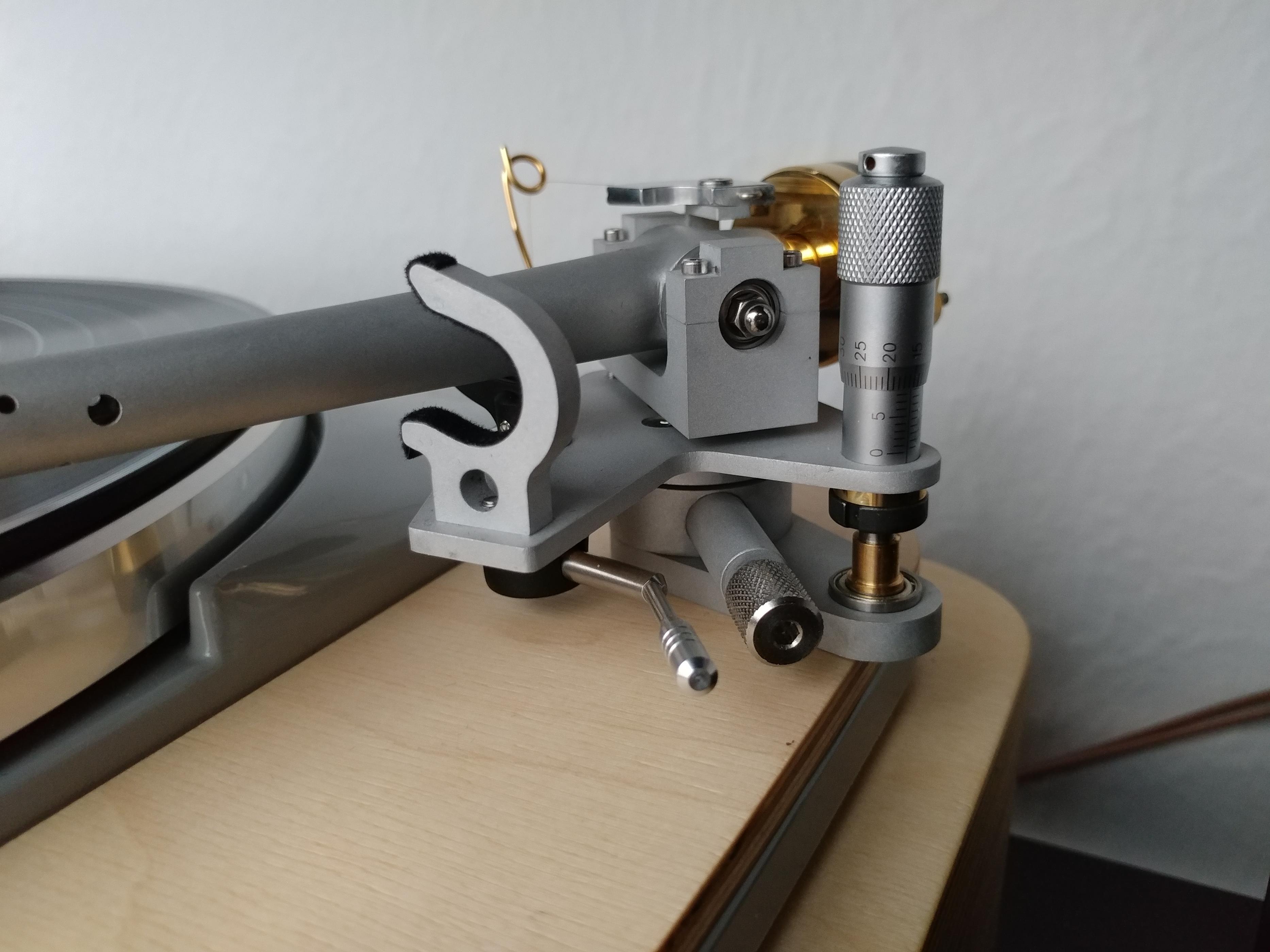

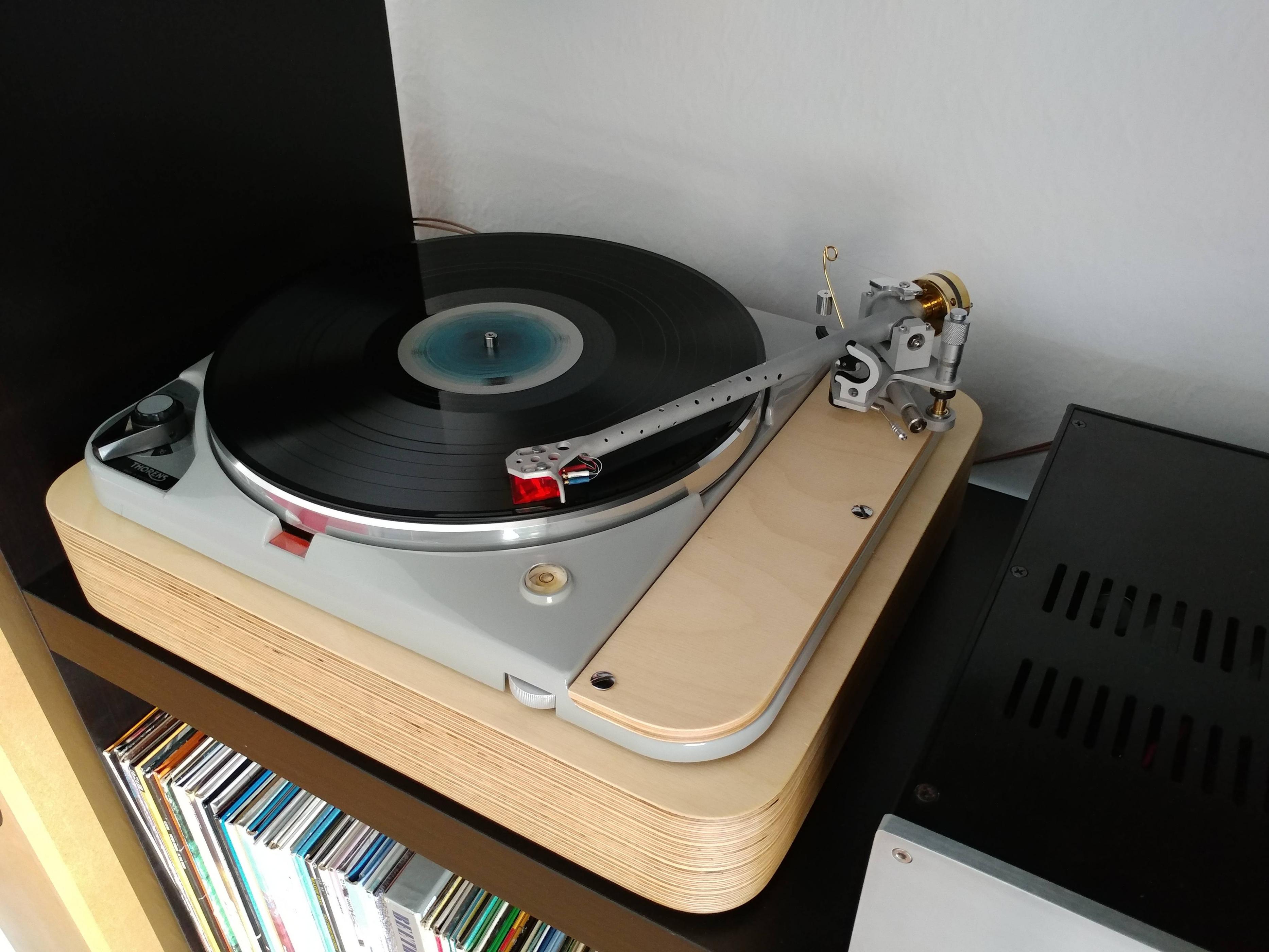

Check it out, I finished my Audiomods Classic II Micrometer tonearm kit build today!
It sounds even better than it looks.
I recall using an Expressimo modded RB250 on my first TD124 to very good effect. I imagine one of the Audiomods arms would be considerably better soundwise, but also much more accommodating for vta/sra. The string and weight anti-skate seems like an entirely good idea.
Credit must go to Rega (Roy Gandy & crew) for creating this beautifully cast armtube. Such a casting will not be cheap to tool up for. Many thousands of dollars must be paid to the Tool & Die firm that produces the molds.
I wonder what Roy Gandy thinks about this implementation of his precious little brainchild!

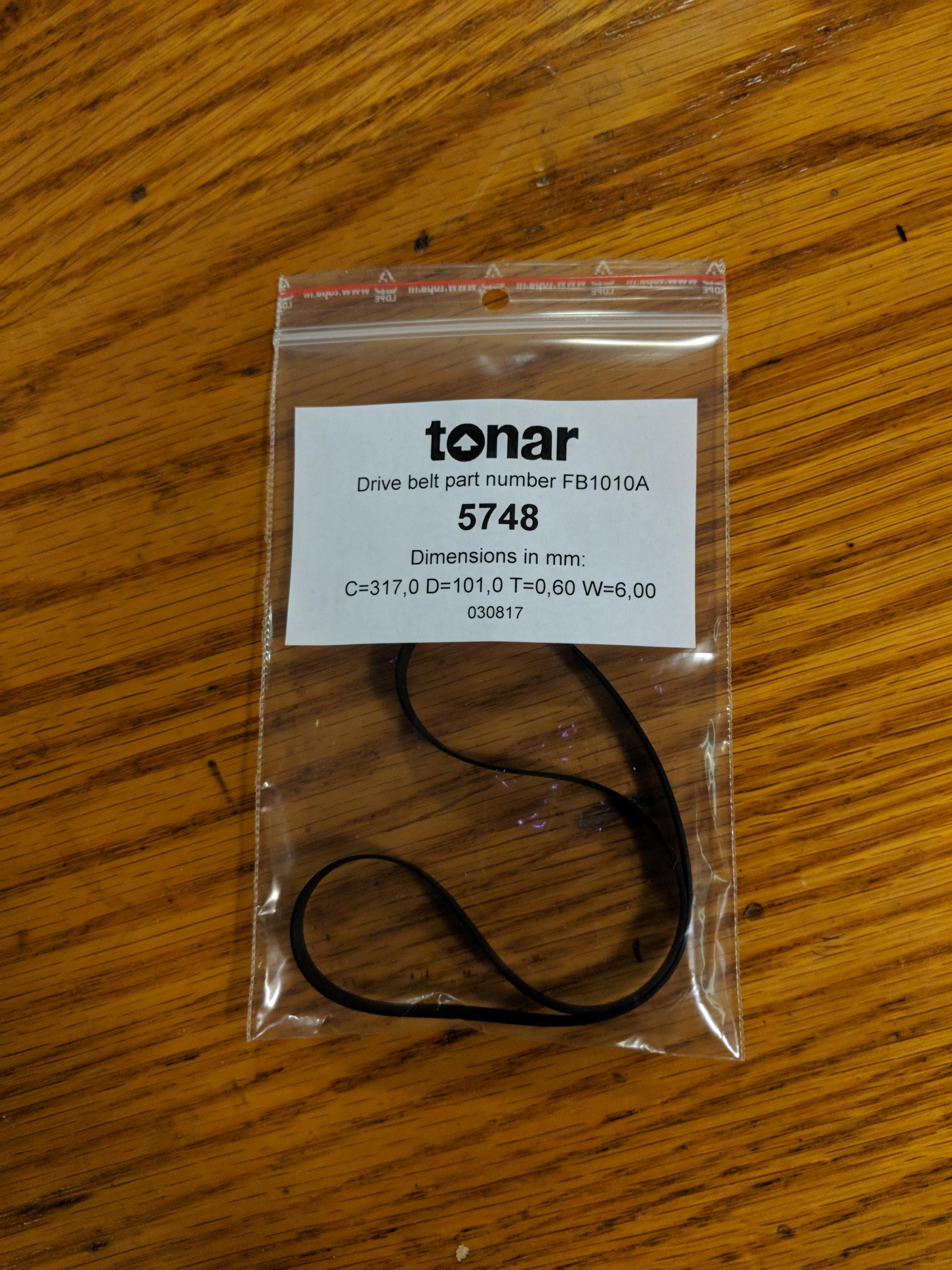

On a positive note, I found a very quiet belt. I sourced it through these guys. Thorens TD124 Top Platter upgrade - Retrotone
I bought the top-platter from them and as an afterthought decided to see if they had belts. The sourced them from someone-obviously. Exceptionally quiet! I rebuilt the motor at the same time and it was about as noisy as it had been with the old belt on it. A few days later the new belts showed up and magically the table is now almost silent. With ones ear 2 inches away there is NO noise with all the platters spinning away.

Interesting on the upper platter. Machined from solid stock (alu, we presume) and much heavier than the original part. Their ad suggests that this is intended for use on the TD124 that has the lighter Zamak platter. However I'm interested in it for the iron platter as well. I imagine the standard bearing can handle an extra couple of pounds just fine for this.
How did the upper platter fit? Same as the original?
Does it spin true?
Does the clutch lever lift this heavier upper platter? Does it require adjustment of clutch clearances? (I'd imagine it does)
Looks interesting. Oh, and good news about the belt:) Thanks for posting.
-Steve
The platter spins true although the spindle hole is slightly oversized so the top-plate can center itself over the lower platter. I did not have an original platter so I can't compare the two. The clutch seems to work fine. There is a minor scraping sound while the platter is lifted off the driven one. No adjustment was needed. The contact has nothing (I believe) to do with the height of the lift. I believe it is that the diameter of the reproduction is closer to the cast iron platter and if it is not centered exactly, the lower platter just "kisses the upper one as it rotates within. I do not have the lower platter bolted to the spindle yet and that may well fix the problem, minor as it is.
Still playing with it though. I'll keep you updated.

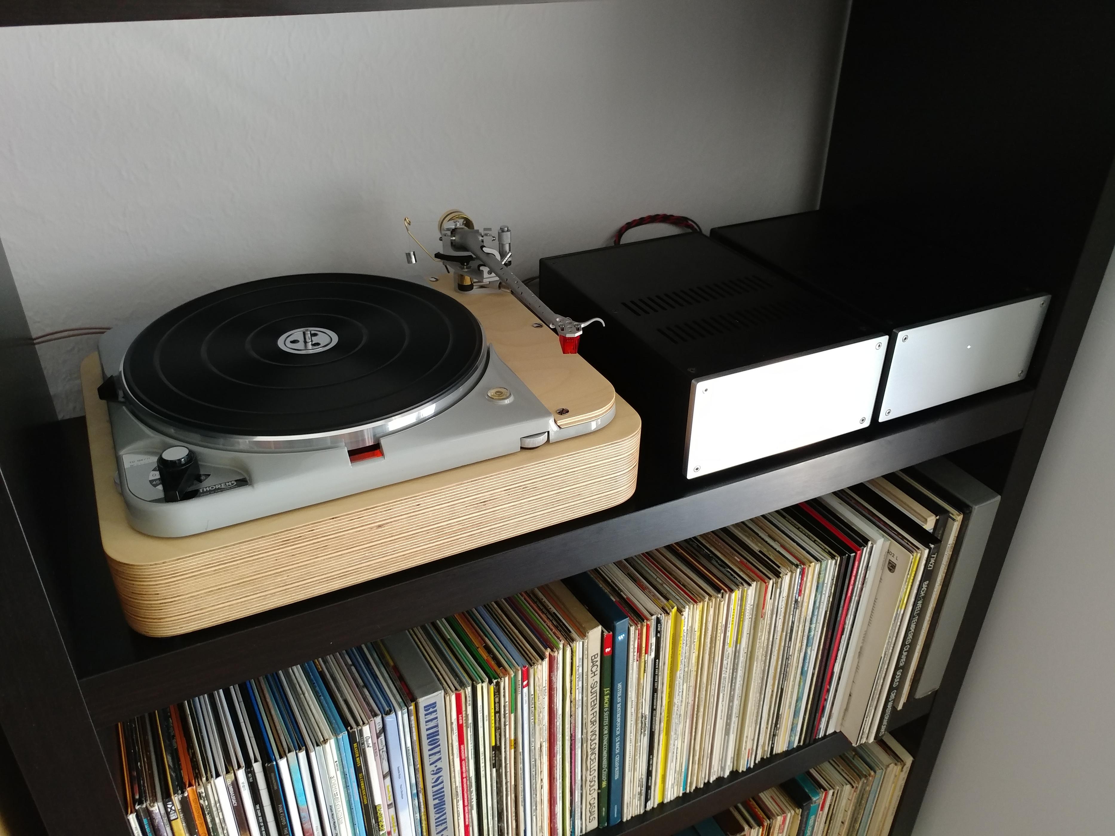

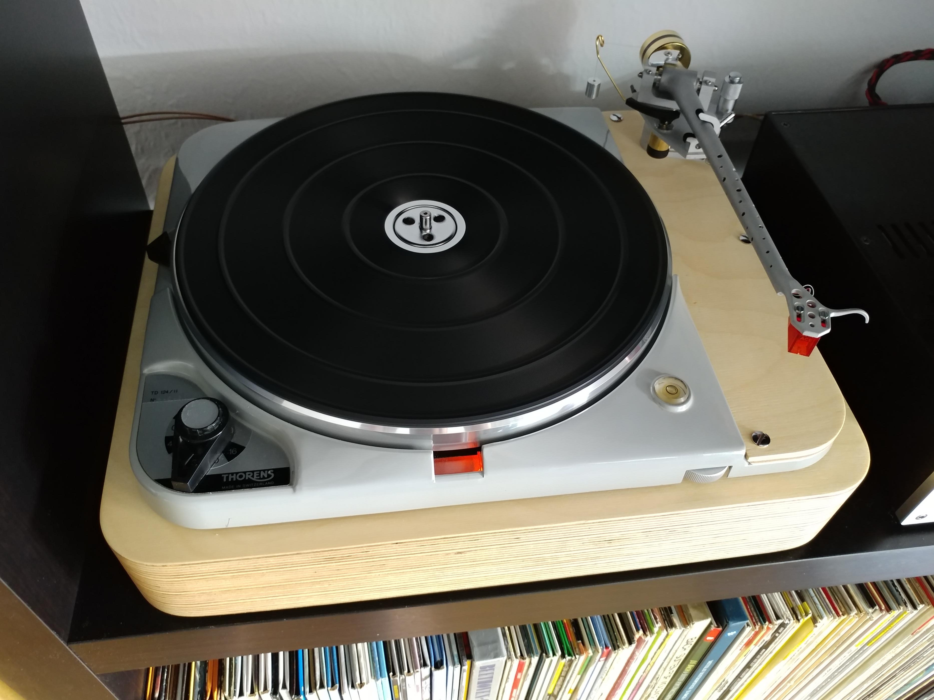

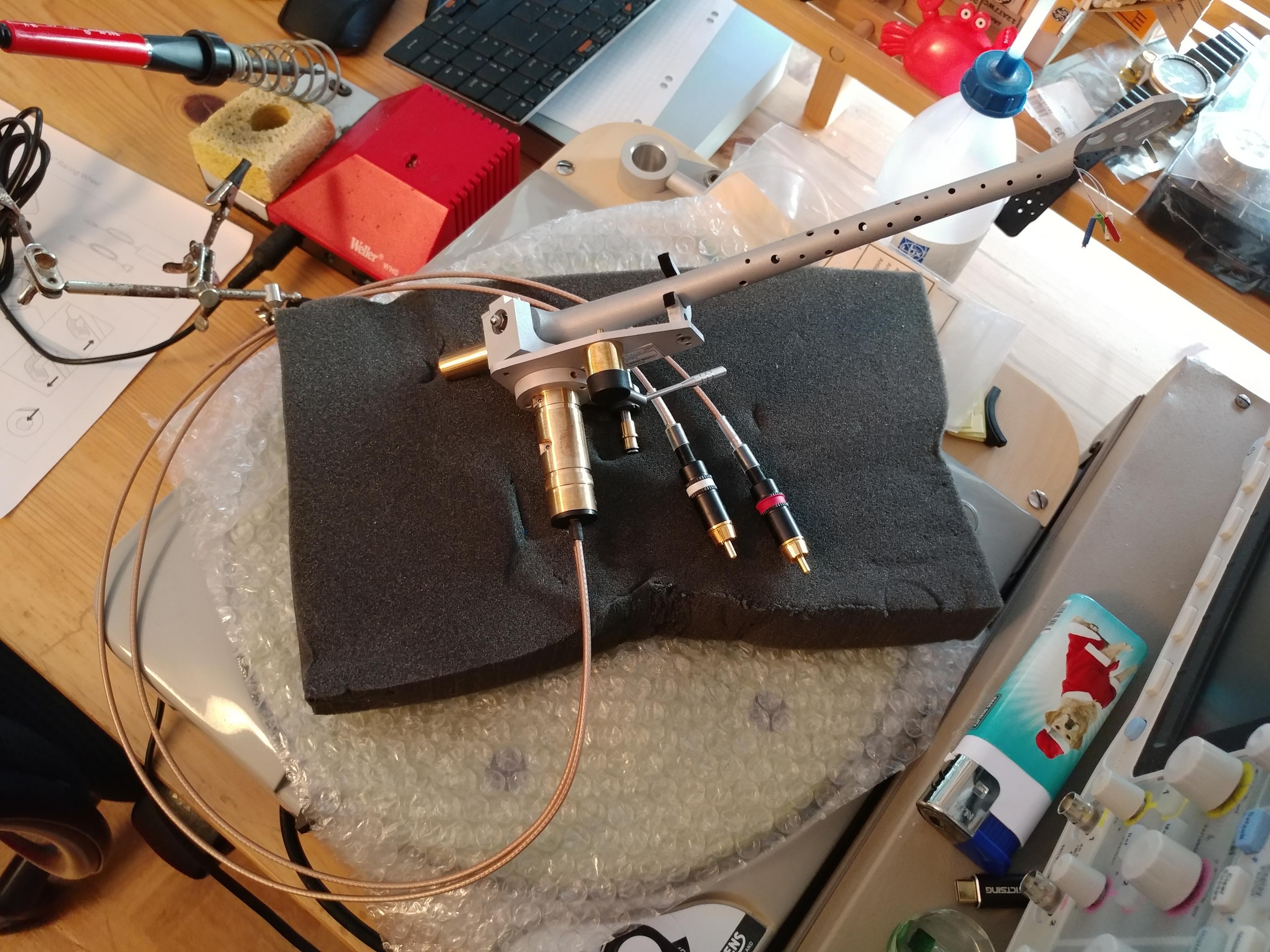

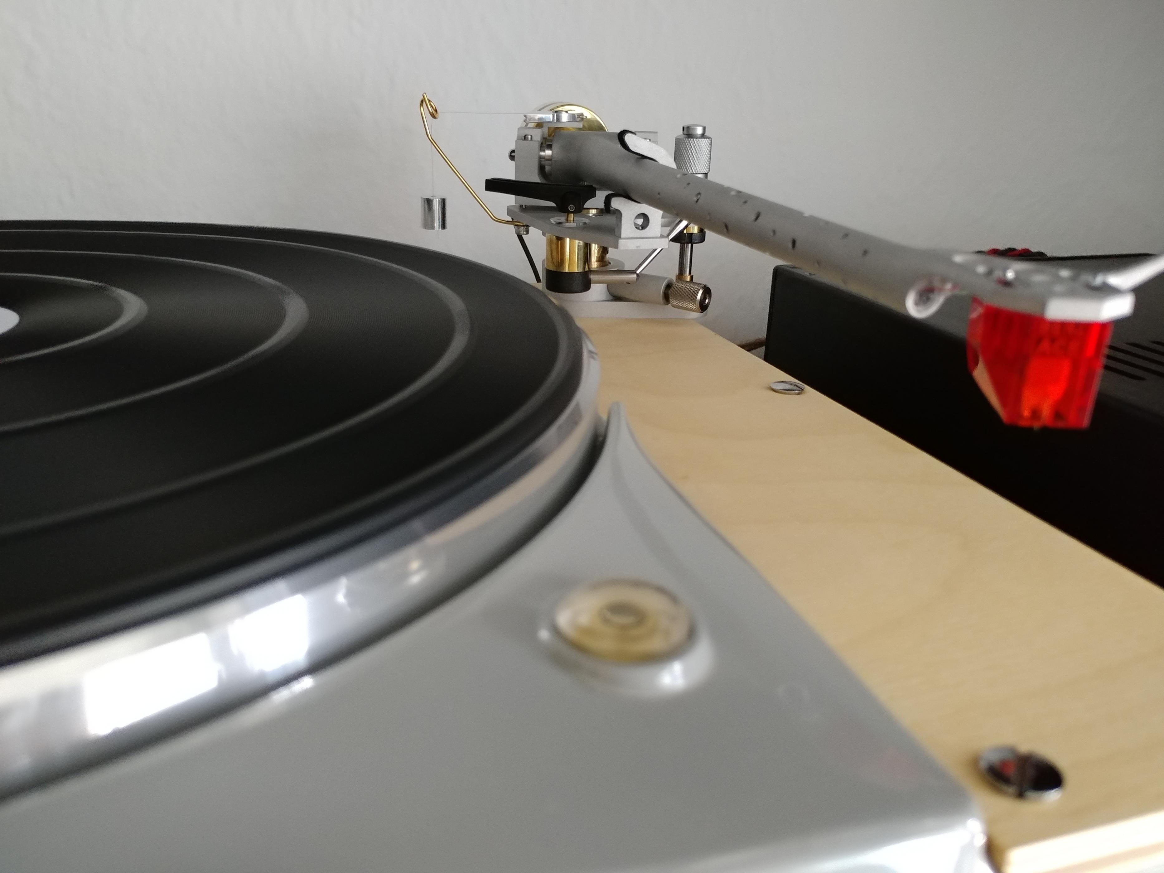

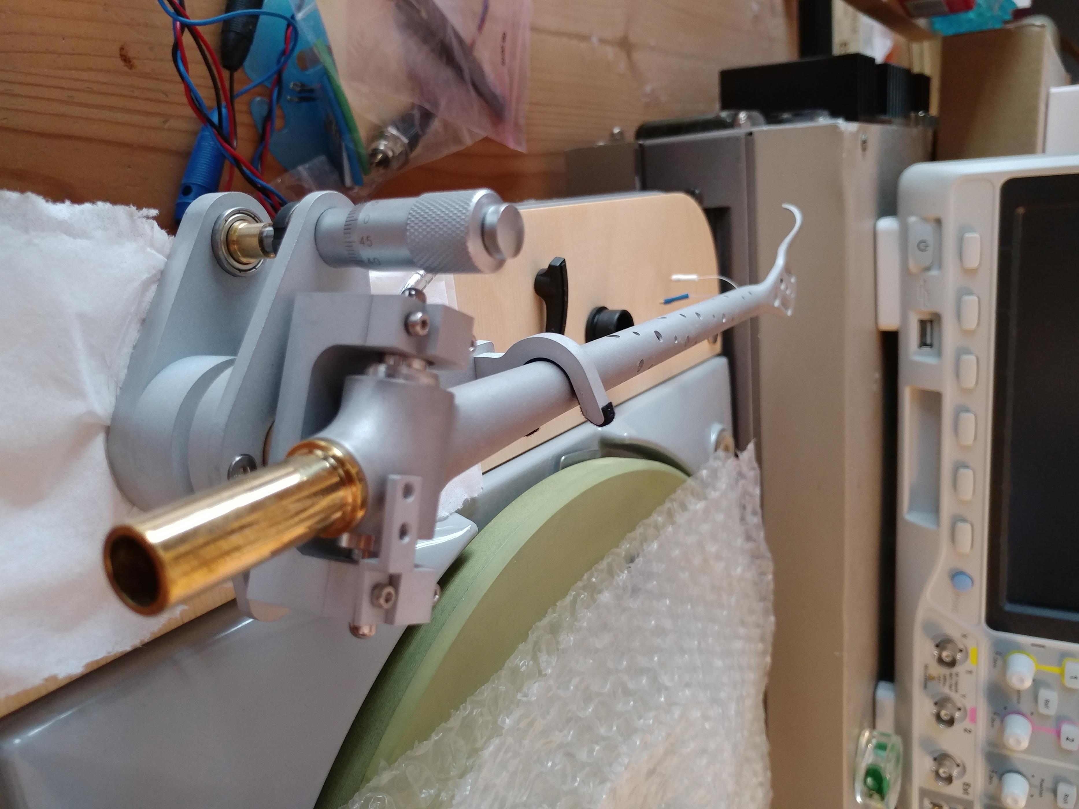

The audiomods tonearms are built around a modified Rega armtube, correct. If I'm not mistaken, all other parts except the tonearm lift are made by Jeff Spall, the man behind audiomods. He's a pleasure to deal with btw.
I figured the matte (sand blasted) finish would blend in nicely with the grey lacquer of the TD124. And together with the oiled birch multiplex plinth and armboard it turned out nice indeed, methinks. Sort of an understatement, pimped by the arm's bronze parts.

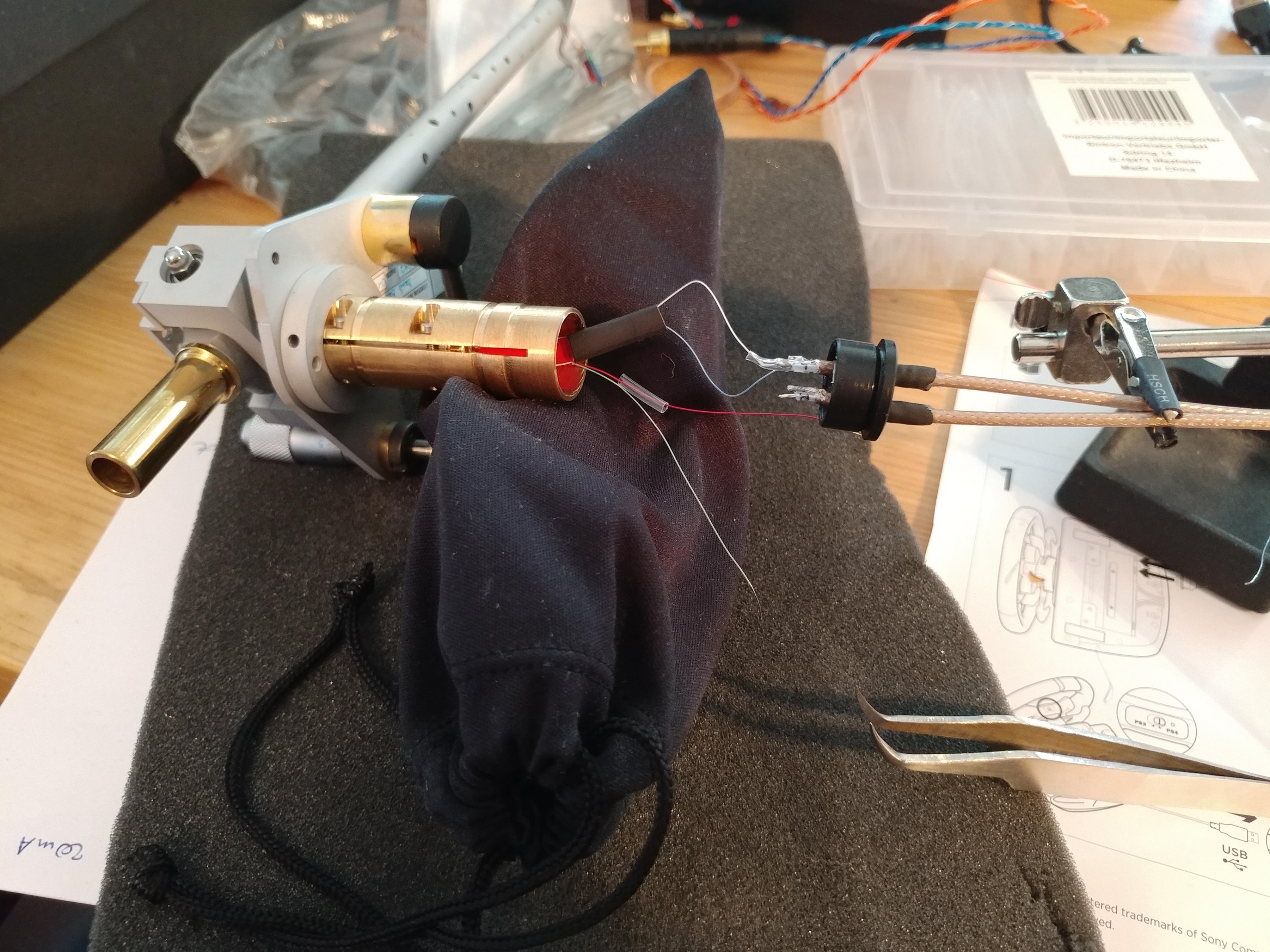

Putting together the arm kit was good fun, safe for the soldering of the tonearm wire, that was a bit fiddly.
I feel like the audiomods arm handles the TD124's pace and impact very well. I haven't spent that much time with it yet, but I believe I prefer it to my overhauled SME 3009 S2 improved (steel knife bearing) arm. It sounds less vintage and more in control.

It appears to a well made bit of kit, and I am sure it was a lot of fun to put together. I have little trouble accepting that it is superior in performance to a 3009 S2 Improved even with steel knife edge. I've had the misfortune of owning 4 of the S2 unimproved of various vintages (three simultaneously) and found it to be hopelessly out of date, it was just mediocre in terms of detail retrieval, overly polite, and uninvolving. The 3009 came close to ending my interest in vinyl. Despite the many common components and shared design the 3012 is much better.
The stock swiss cheese head shell is a huge liability IMO, replacing it with a Yamamoto, Ortofon, AT, Orsonic or other head shell results in an immediate improvement.
