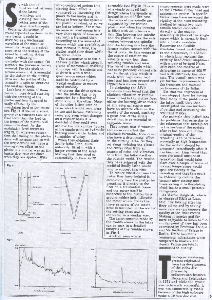

I dug up some section views of the Thorens, Linn and Garrard bearing types. I thought this might help to visualize parts of the recent discussion. I note that the Linn bearing is very similar to the bearing type used in the Thorens TD16x, TD14x and those that came later. Except Thorens, for its bottom plate, tended to use a swaged-on plate for those belt drive models. And this makes giving maintenance to the thrust pad quite a bit more difficult....but possible.
I note that the Garrard brg does not use a ball and thrust plate. Instead it appears to be two flat, or nearly flat, smooth surfaces one directly over the other. The scheme there must be that both upper and lower thrust pads must mate to have a low coefficient of friction and, presumably, a steady source of lube.
The TD124 bearing should be familiar to all in this thread.
-Steve
Nigel, are these notes available online?
Somebody somewhere might as I think they were sent to the Gramophone. Word for word what Ivor Tiefenbrun of Linn stated were in this Garrard presentaion. Linn reinterpreted the 1/10000" as for Garrard it was squareness at the bearing thrust on the 301. The 401 has a soft dome that allows a less tight spec which new owners Plessey wanted one guesses ( it's their style ). In about 1960 there was a fire at Garrard. Plessey a failed 1930's radio maker who went on to do defence work lent Garrard a factory. Out of kindness it became a buy out. Alas the dead hand of Plessey took control as it had when they last failed in the consumer market. Didn't take them long to poke off the USA importer who had just got Porsche their first big USA title in the 1973 Garrard Porshce. The result B.I.C a rival product.
