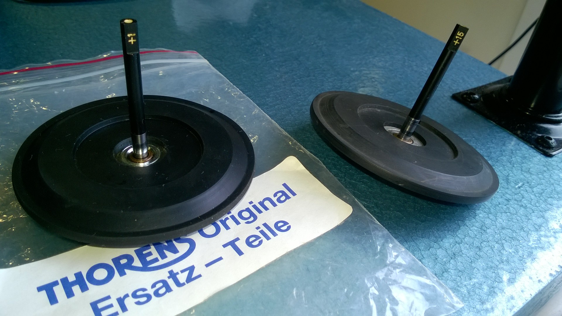

For idler wheels there are a few sources to choose from.
A few different sellers are offering silicone O-ring wheels. I'm trying one from AudioSilente shortly when it arrives tomorrow. However for a new oem replacement Schopper has a nice one.
Above is a photo of one of these Schopper wheels I installed to a TD124 last summer. I was impressed with the quality of the wheel. It spun true for concentricity (as needs to be) and also for vertical runout which many oem wheels sometimes do not.
Price was in the "not cheap" category but I think worth it for someone wanting to put one back together as the factory built it.
Included with the 'kit' was their "Idler Wheel Noise Reduction Kit" which is composed of a plastic cup that fits snug over the axle to form a seal and holds a supply of lube beneath the wheel as it operates. And a thrust washer is put in place directly over the axle in the cup. Plus a small vial of Schopper's lube. The negative to that kit is that if you pick the turntable up and tilt it too much the lube will spill out the cup and get oil all over the idler wheel and inner rim of the flywheel. and that is bad, bad, bad. So it goes with a caution. Otherwise the "kit" looks ok to me.
-Steve
