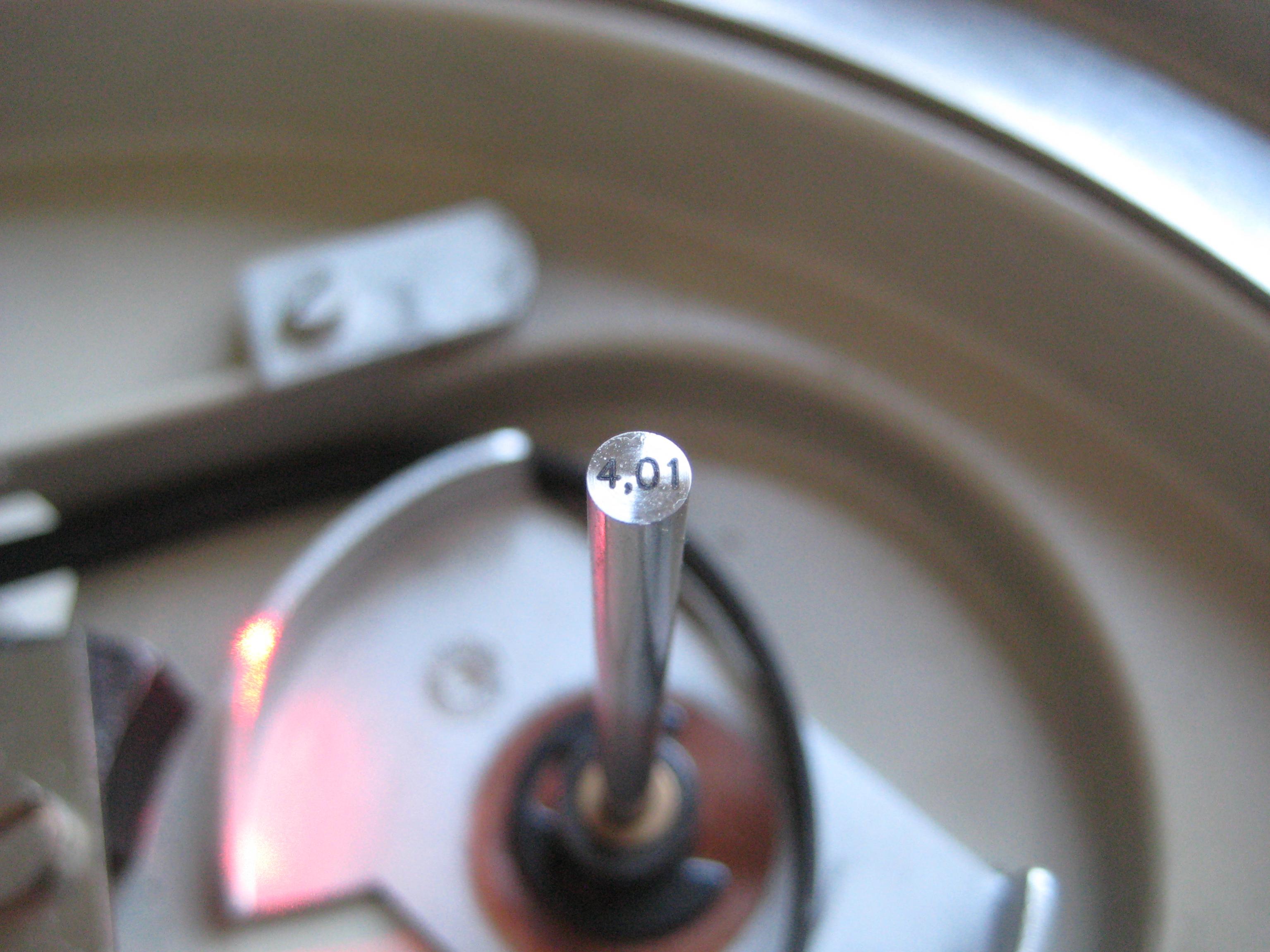

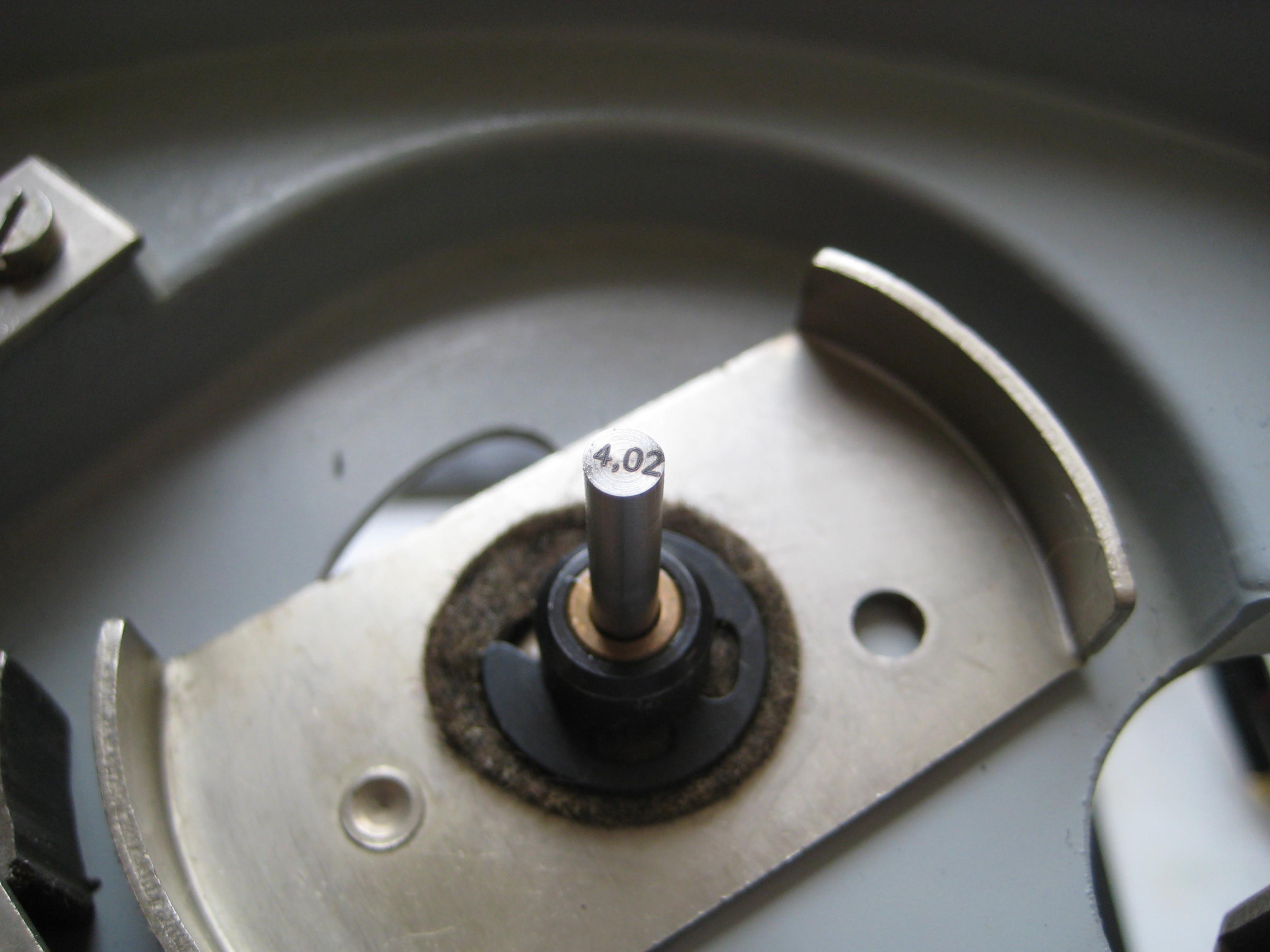

Ok watch out for the small bronze ring is often overlooked or lost during revision work.
Ouch, I now know why I am having problems with my older 124, (speed adjustment) it was definitely missing in the collection of parts I bought when I was restoring this table. It had been stripped of almost everything but the motor and intermediate pulley. For some reason I felt compelled to rescue it, a decision I have not regretted as it is definitely the less finicky of the two I own.
Anyone know of a suitable replacement?

Kevin no problem, I can make this ring for you.
Is that something you do on a regular basis? Mine has also disappeared. I would love to be able to adjust the speed
