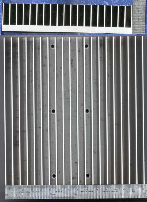

Not for thyristors, something else, dont know what. The weight was a couple of kg's. Not that huge but very handy.Christer said:
You mean a heatsink from an RC!!!? How big is that? Or maybe
it wasn't a heatsink for the thyristors?
