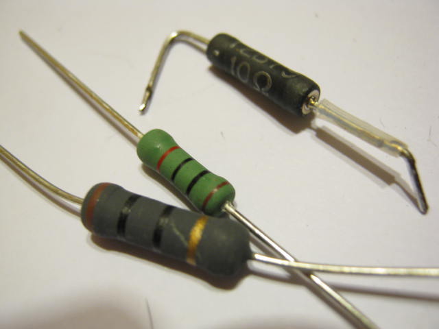

I'd be very wary on this: Recent bench testing a 50W amp threw me out: mysterious unexplained anode current variations. Fault: Dont' use cheap low ohmage metal film/oxide resistors for the cathode current sense in amp output stages. Although x4 overrated; the film & oxide resistors have very poor impulse properties. Both these resistors in the pic (left +centre) have been impulse strained and read wrong values and yet not a single scorch mark can be seen.
The solution in this amp example is use a Dale 10R 2-3W wirewound (on the right) available from Mouser.
I wouldn't go haphazard about using cheap film types for criticial positions. One could be looking for a fault quite soon after fitment. A hefty transient spike from a fridge or another appliance is quite enough to punch oxide and film resistors.
