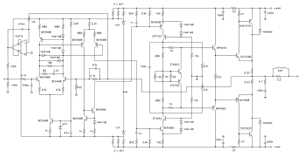

It has been posted earlier, but here it is again:
Steven

Hi Dave,
If you send me your email address, I will send you some other drawings of the 8000A. These come from the service manual, but are too big to post in the forum. Quality is not that good, but they contain also the protection parts of the circuit, not shown in the previous drawing. Maybe these circuit parts are confusing you.
Steven
Hi Dave,
I have just recently fixed the power stage of one channel on an Audiolab 8000A that I purchased.
Beware of short-circuit readings from in-circuit measurements on this amplifier. I used a very simple in-circuit transistor tester, and found that many of the devices gave collector-emitter short indications. When removed from the circuit most tested OK, it was the passive components around them giving false readings. Remember that this amp uses many local feedback loops for predictability and that confuses simple test measurements.
