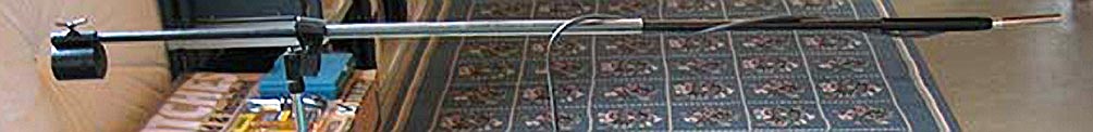

Earl why so overcautious? That's the test configuration:
Looks more like a horizontal summing localization experiment set-up to me.
