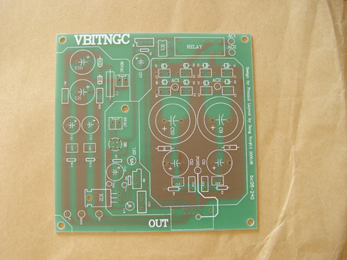

Allexx said:There is mistake on the diagram in post #9. Collector and emitter of T6 must be reversed.
Oooops ...I'm a dope. Sorry folks drawing error, the correct version is this one.

What is the purpose of T7 and T9 in your design?
And what is the purpose of R7?
And have you tried the protection? So have you tried to short circut the amp? Is D5 and D4 is enough to protect the output FETs?
T5's Uce is double of T8's Uce. Is it causing any unlinearity or distortions?

I am not sure if T7/T9 are necessary. To me, they are nothing but DC shifting devices to make sure that T5/T8 work in roughly the same Vce. the downside of having T7/T9 is that you then are forced to either a) accept rail losses or b) use higher rail for the VAS section.
I would go away with T7/T9.
Also, i would use a MOSFET in place of T4 to have similar thermal characteristics as the output stage.

I have posted a low power version of this design that uses MJE350's instead of the BC327's in "another quasi-complimentary design" thread but there are 2 main reasons for T7 & T9 in this higher power version.
1. To remove excessive voltage from T5 & T8. There is 18 mA running through each of these and if T7 & T9 were not there then T8 would have around 85 volts across it (1.53 watts) and T5 would have 170 volts across it (3.08 watts). These devices would then have to be something different (MJE350) and these would run very hot.
2. By leaving only a few volts across T5 & T8 the second stage is faster and more linear.
The reason for the seperate rail is to lift the available voltage drive for the output stage by 6 volts or so. Without it the amp would clip on the positive waveform before the negative cycle clips. This is not due to the amps topology but the requirement for the output FETs to have at least 4 volts gate to source before they turn on. Under power conditions this requirement exceeds 6 volts. I know I am wasting some voltage in the input stage (across the 4k7 resistors) but once I added the seperate rail I chose to leave more voltage for the second stage constant current source.
You can't really use a mosfet for T4 because this is actually wired up as a diode. In practice I have found that the location of this is more important than it's tracking characteristics. Once the amp settles ( a few minutes) the bias does not vary by more than 20% or so, and for a PA amp this is quite acceptable.

Hey edl, you posted while I was typing.
I tried to setup a normal constant current source with 0.6 volts as a reference for T6. I could have used two diodes on the base here, but I used a transistor (T4) as a diode because it's easier to mount and thermally tracks better. I gues you could use any constant current source here provided there was thermal tracking for the output stage.
I think I answered the reasons for T7 & T9 and the higher rails in my last post.
Without R7 there would be over 90 volts across T2. With R7, T2 only has around 60v....ooops maybe R7 should be 27K, anyway you get the picture.
Cheers

Oops edl ...about the Vce on T5 & T8. No real problems her with linearity etc, T7 & T9 help to resolve that.
