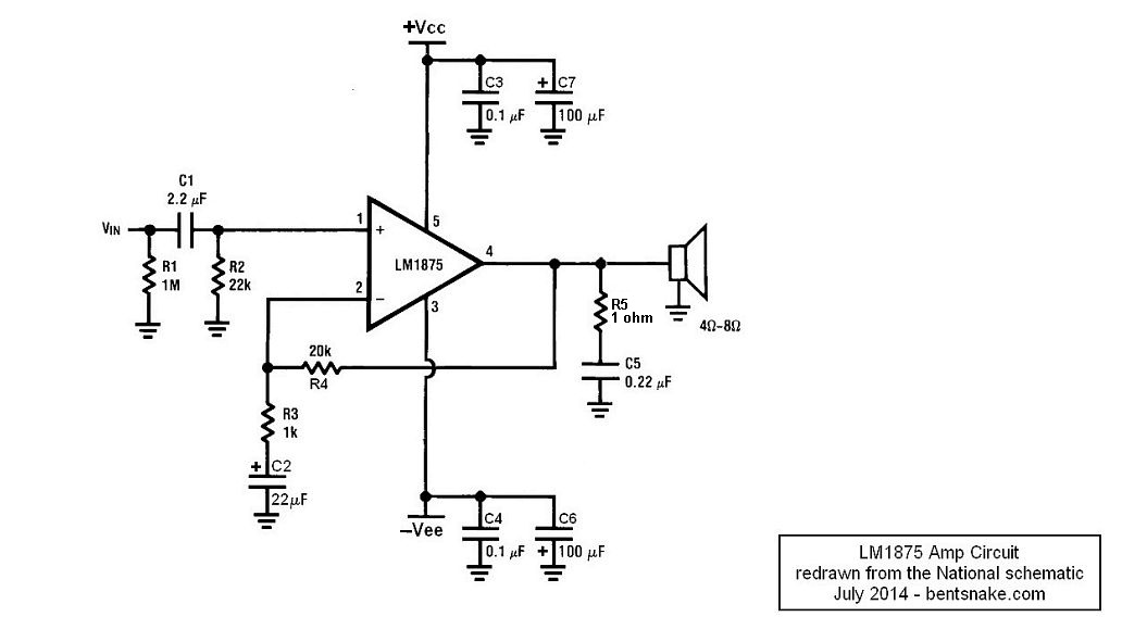

req help in choosing audio amplifier IC for DIY home speaker system

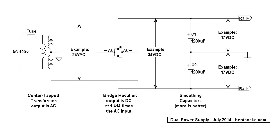

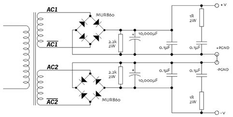

1. Regarding the power supply for the amplifier, I didn't looked into much details, thought to do after fixing the amplifier ic.
Initially thought if we may use the 65w, 19.5v laptop power supply. Is it ok or its better to go for transformer based linear power supply?

50% of the chipamp performance is dependent on the power supply, 40% on layout, and 9.95% on parts. The actual chip contributes about 0.05% of the total performance of the design.
Not really, but close enough.
Also, the major contributor to sound quality of the entire system is the speaker and the room. Car speakers depend on cabin gain in the small space of a car, in a room they do not perform very well at all. And they are not 90dB in there either, think 86-87 or about the same as a regular domestic speaker.
You might be satisfied with such a system for a few months, till you actually hear a decent system. Then you'll wonder why you didn't plan it a little better.
