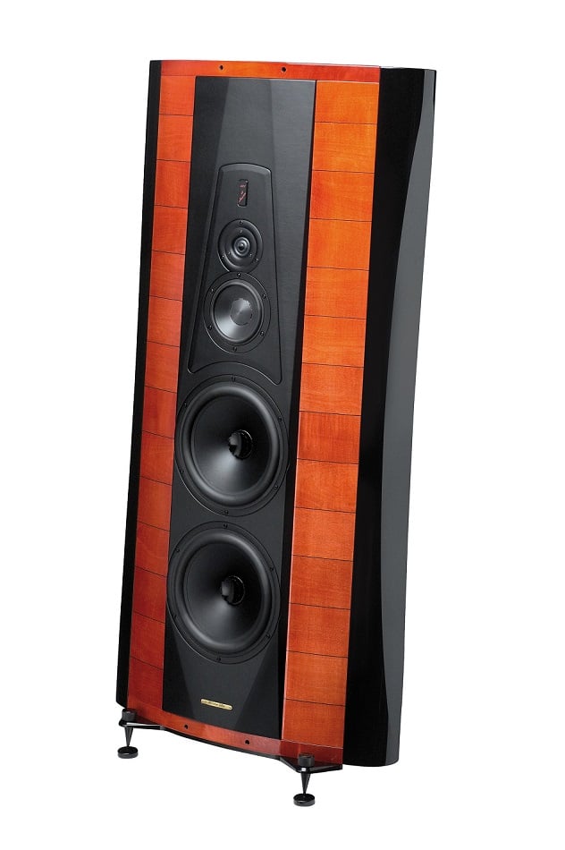

Sonus Faber Stradivari.
Also, I really DO like the sounds of them. I wish someday to have the space to make my own and then listen to my own wide-baffle designs! :)
I chose to mimic a wide-baffle design, though only a 2-way myself.
Certainly not as large as the Strads, but still 'big'.
