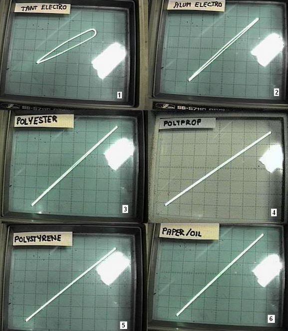

One of the few interesting and useful measurements of capacitor quality I have ever seen below. Hysteresis is essentially what you get with a non-linear lossy system, IIRC. Of course the actual drivers and inductors are less than perfect too, so a balanced approach is in order, IMO.
