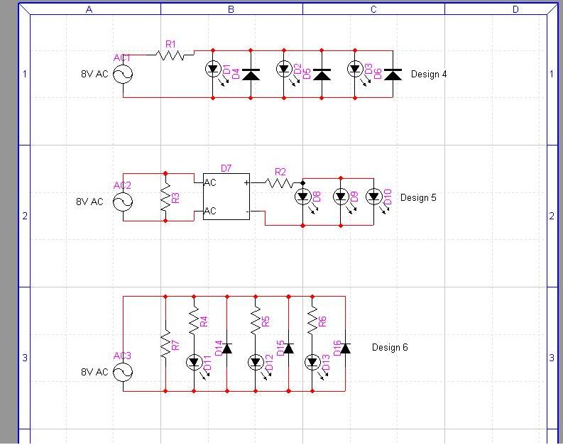

Parallel LEDs
Each LED in parallel requires a separate dropping resistor. LEDS do not all have the same forward voltage drop and if you parallel them directly, the one with the lowest forward voltage drop will hog all the current. It is better with multiple LEDs to have them in series, specially if you have loads of voltage to run them, which it appears you do. With an AC source, use two strings of series LEDs in inverse parallel and you can get away with a single dropping resistor.
Note that you must have some sort of inverse parallel diode, either another LED or something like a 1N4001 because LEDs cannot tolerate very much reverse polarity voltage, only about 3V each. By having inverse parallel series strings, the two strings protect each other.

Well, I've taken in to consideration what you guys mentioned and here are a couple more schematics I came up with.
In designs 5 and 6, R3 and R7 (respectively) are there so that the AC source "sees" the same load as three bulbs wired in parallel (or does it matter?).
Design 5 is the simplest and seems to get the job done, but I don't know how wild I am rectifying the voltage at this point in the circuit (or, again, does it matter?).
I am using white LEDs, and I will be mounting them so they point at the diffuser.
I just noticed a potential problem with design 6, as D14, D15, and D16, as they are, could cause some problems. I would wire in a resistor in series with them of the same value as is used with the LEDs; also, I'm removing R7 (it seems like a waste of power...).
OK, let's get more technical. A standard white led has a typical forward voltage of 3.7V @ 20mA, which is about the maximum current safe for an unknown white.
As said, one series resistor per string to prevent current hogging and uneven illumination. To calculate the resistor,
R = (Supply Voltage - Led Forward Voltage) / Led current
(Picking the nearest standard value up)
For series LEDs, just add the Vfs, ideally the total Vf should be under 80% of the nominal supply volts to allow room for variation.
For AC, the options are a series rectifier diode (to block reverse voltage) or an inverse parallel rectifier or second LED (to bypass reverse voltage). If you're hypersensitive to 50/60Hz flicker, a bridge could be used.
For mains level AC, a cap is generally used (0.47uF for 60Hz 110V, 0.33uF for 50Hz 230V) to drop most of the voltage, with a 1k 1W series resistor to limit switch-on charge current in the circuit. Less total heat produced than dropping all the spare volts with a resistor.
You can diffuse the light better if so required by roughening up the led surface with sandpaper/emery.
Should add that with half-wave rectified AC or inverse-parallel leds you can safely double the led current over the spec DC figures.
