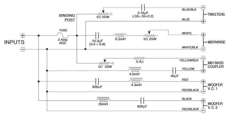

I have a turntable that is still used sometimes, and I don't want to stuff more wool into the speaker. The amp's max rail voltage is just under 100V, so I'm looking at using 2x330uF 100V bipolar electrolytics from Jantzen. Maybe bypassed with 6.8uF Jantzen std z-cap...
It's interesting that the polarity of the tweeters and mid-bass has been reversed. This is what the sales brochures called 'phase aligned' back in the day! ;)
When looking at the schematic for what values caps I need, I discovered an error for the tweeters. It says "3.16uF (.33+.33+2.2)" ...it doesn't add up! I have to open a speaker before ordering those caps. Oh well. I probably should replace the screws holding the woofers with bolts.

One of the woofer voice coils is marked 2 Ohms, in parallel with a 4 Ohms vc, so you're quite right about not wanting to decrease the impedance!
The schematic is correct about 3.16uF for the tweeters. It's made from three caps: 0.33 + 0.33 + 2.5uF (and not 2.2uF as written in the schematic). I'm replacing this with 0.47 + 2.7uF, because I can't find any 2.5uF caps from the good brands.

These are to be used in series with one 4 ohm voice coil and the other a 2 ohm voice coil, to block subsonic signals. There can in theory be up to 100 V AC from my amp.
To use electrolytic caps, I think it would be better to connect two large caps in series and reverse polarity (i.e. create my own bipolar caps). For the two speakers, I would then use 8 caps. Here are 12 for a good price: clicky link
