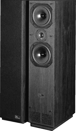

Just wanting to resurrect a project to restore a pair of TDL Electronics TRL3 Loudspeakers which stalled.
Everything was going well. I rebuilt the crossovers with a tweaked design involving quality inductors, poly caps, new resistors, and re foamed the mid/bass drivers.
I blew it as I didn't properly test the tweeters only finding out later that they are both dead.
Original tweeters are probably rare and well worn/expensive if available.
Are there any recommendations for similar new tweeters offering similar physical size and similar characteristics?
Here are specs:
Type: 2 way, 3 driver loudspeaker system
Frequency Response: 35Hz to 20kHz
Recommended Amplifier: 20 to 120W
Crossover Frequency: 3000Hz
Impedance: 8Ω
Sensitivity: 90dB
Bass: 2 x 172mm loaded polypropylene cone
Tweeter: 1 x 19mm soft dome
Enclosure: reflex transmission line
Dimensions: 900 x 200 x 375mm
Weight: 21kg

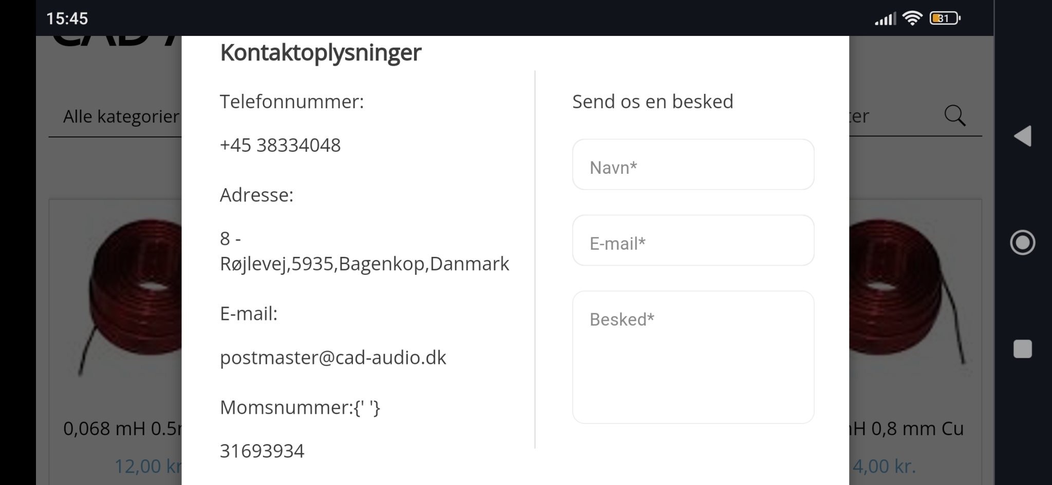

I suggest you write them an email. I imagine they will send abroad. They are a very old respected company.
Thanks, but I can't seem to find an email address on that CAD AUDIO WEBSHOP site. Can you help?
EDIT: I got it!
postmaster@cad-audio.dk
@CliffR52 Just click on 'Kontaktoplysninger' located at the bottom left of the site's screen (scroll down) and you'll open a box in which to write an email.
