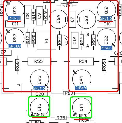

OK since im able to get MJE340/MJE350 transistors here in my country i think i will use them, but exacly whitch capacitors need to be incrased (whitch number in schematics)?
If you use 340/350 you don't need to. It's only when you use some uber-performing "upgrade".
Please note the nessesary of relatively large heatsinks for the MJE340/350 in the predriver - 168V by usual idle current between 10 and 15 mA means 1,7 until 2,5 watts loss power !!!
In the S-Leach they only have 1/4 of the 168V rail on each one. That puts them at less than a watt. Still, a little heat sink will improve stability of the q-point.
TO-126 beats TO-5/TO-39 in free air and on infinite heat sink.
Then you can use MJE340/350, at best from "ON" or "ST"
IME, the ST version of these parts has always been the best. Higher fT than ON, and better consistency. Cheaper most of the time, too.

requires you to use >=180Vce0 transistors wherever they can see the full voltage during operational conditions. If the transistors are cascoded to never see more than half the full rail voltage then >=100V devices can be usedThe power supply rails in my amplifier will be about -84 0 +84 DC!
You also need to look at the current rating at the elevated voltages these transistors will operate at and you must de-rate that current to suit the worst case operational temperature you believe will apply to your situation.
This de-rated SOAR design is absolutely crucial to reliability.

So now i have soldered almost all resistors and diodes to the PCB's.
Next im ging to solder are capacitors, but i have few questions about those "mica" capaciors used in leach original design :
Are they some special "high-end" tipe mica condensers, can i use regular mica condensers?
And what to do if i don't have exact nominal?
for example i have:
51pF instead of 47pf
200pF instead of 180pF
Can i use them in my leach superamp PCB's?

Will work fine. He recommends mica because they are stable. There are also high stability ceramics but people will still complain about those. There is also polystyrene or polypropylene.
The key element here is that they must be stable with temperature/voltage changes as they are used for either compensation or filtering, so their values must not change much. They should also be tight tolerance.
