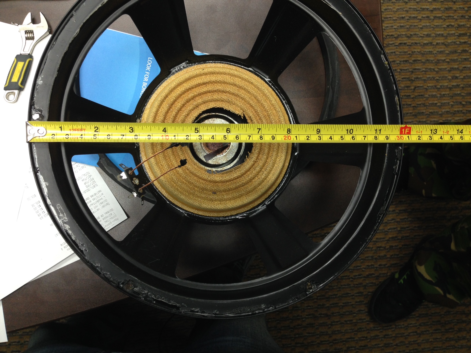

My apologies. I attached a photo of the subwoofer. I brought the box to my office and can't take of a picture of it now. I was looking at the overall diameter of the subwoofer, not the mounting hole dimensions.
