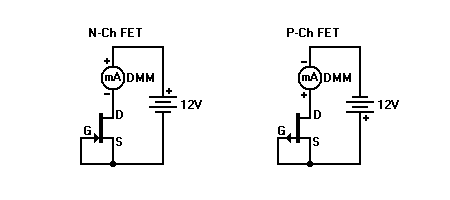

use this
9V battery instead of 12V as marked, will do the job
inform here what you got

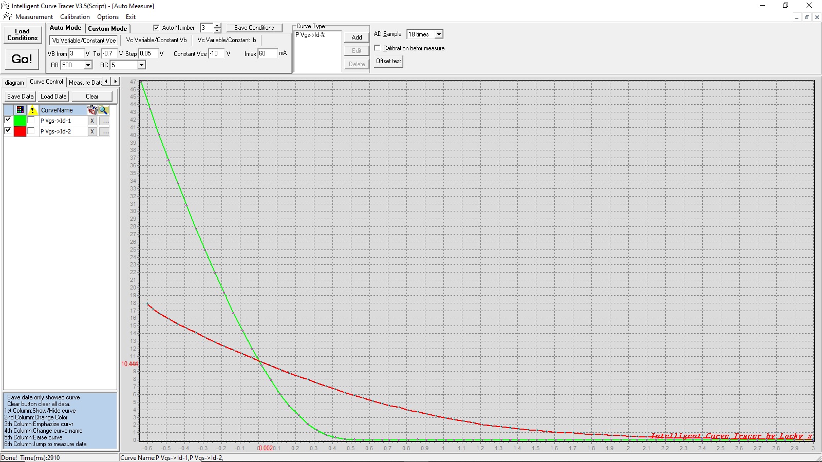

If I'm right, measurement above, suggested by my friend, reveals only one parameter, IDSS.
I had to pay for my lessons, I have bought some JFETs, measured IDSS, found to be O.K., then turned out fakes:
(JFET represented by green line is genuine one, red one is clearly fake.)
I'd like to thank everyone for their helpful replies. Especially on how to measure IDSS. The Jfets I purchased from Spencer in Singapore haven't arrived yet. Measuring them should be straightforward. My question, however, is more along the lines of how much variance between the N and P channel is okay? Also, spec variance for BL grade range from 6-12...what it optimal and what happens the further you from optimal. Does it increase noise? Does sound quality deteriorate?

A reasonable idss match is better than 10%, some like 5 % , or even tigher, but it changes with temperature, even holding them in your fingers changes the idss,
. You need to let them stabilize in your idss test for a couple of minutes, with no breeze, and don’t touch them , even changes in house temperature causes some drift, so measure them at the same time of day
The idss value you need depends on the circuit design.

The JFET matching tolerance required for any of Nelson's projects is 1mA
You can fact check that detail through the various threads here and over at First Watt / PassDIY.
