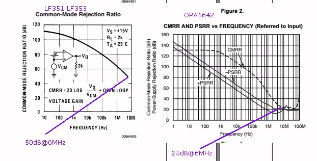

Funny enough, it's not too different from this very good op amp (with very similar GBW) http://www.ti.com/lit/ds/symlink/opa1642.pdf
CMRR is a frequency dependent measurement and not a "number." Please refer to a graph of CMRR versus frequency to know the difference between a very good op amp and that piece of antique junk 5532.
Derfnofred-
Okay, must agree 50dBCMRR at 6MHz and 25dBCMRR at 6MHz are so close to being the same the difference should not even be noted... I mean really, it is only 25dB. That should be considered as nothing so these are the same?

I wonder what the use of CMRR at 6 MHz is? An interesting choice of frequency for audio and op amps with appropriate gbw.
Wouldn't a much more sensible value be 50/60 and 100/120Hz and 1kHz and say 20kHz?
Well - I've only been in this gig for a few decades now, and that's where I'd start. Along with a filter to ensure the amplifier never saw RF.
Hey which op amp works well against those specs? (Flip back a page, the graph is there)

With all the radio and TV broadcast plus noise one must always deal with frequencies in the megaHertz region with filters and of course the feedback of the op amp which will typically have at least gHz transistors used in the build. Pretending "nothing above 20kHz" matters is just plain stupid. It is the bandwidth of the device being used to be the lowest frequency of interest. Out of band signals also cause numerous distortions when applied to a circuit. Who has not heard radio interference in an audio circuit? How did that get in there? Poor design and wide bandwidth parts.
I used the op-amp the lack of whit compared to the LF353, that OPA thing, saying great HF CMRR is not that rare in op amps. Not true unless looking at differential video amps. The NE5532 modern datasheets do not show a CMRR graph for an NE5532 because that would be one pitiful graph. If I come across this graph will post it.
