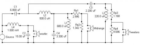

Thanks for the suggestions; I have an update. I'm attaching an image of the crossover.
It has a 2nd order filter with a 1.5mH coil and a 15uF cap. Fairly simple stuff considering the highpass is feeding 6 tweeters. But that's not my concern.
I'm still waiting on a cable from P/E before I can start doing any driver testing. But with a nonfunctioning woofer, how would one go about testing the impedance of the rest of the system? One driver at a time, or just with the coil hooked up?

Sorry for necroposting, but I have an update...
I installed the A30IR50-51F. I had to do a bit of unexpected shoehorn modding on the dust cover. I did not take it into account when I made my measurments. It really should have been a 10" and no more.
I like the depth, but the woofer's response extended too much into the midrange and actually competed with the mid driver. I added a 15uF cap in parallel to the woofer. It sounds a lot better now. I toyed with a .56mH coil and a 33uF cap , but it sounds best with just the addition of a 15uF cap.
A little extra bonus is that the bass is a bit tighter than I remembered it. It must have been the original woofer and not because it was a PR system, as I had suspected. Or my memory is a bit out of sorts.
I remember the "D" model having a "supertweeter" in place of one of the paper cones - basically just a hard dome tweeter that (assumably) extended the highs up to about 20K. But with my aging ears the way they are, I'm not missing much.
Mission Accomplished - I'd show pics but the ex has the camera right now. Needless to say, the new woofer takes up all available baffle real estate.

jdlech said:Sorry for necroposting, but I have an update...
Thank you sreten.
??? the c/o shows 15uF in parallel with the bass driver. You added
another 15uF ?
Tight bass is alignment, not the type of loading. I suspect your PR
is not tuned to below 30Hz which is what you want on paper.
Using PE's measured parameter and 115L to account for the
increase box volume of some acoustic lining of the box :
