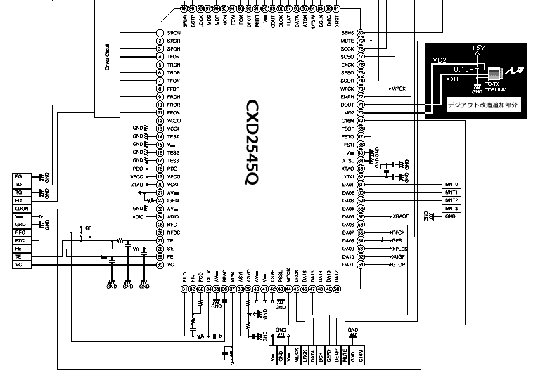

Thanks for your postings Ray. In the meantime I recieved the whole circuit from Alexander. Many thanks again.

Pin description for CXD2545Q:
LRCK = Pin45
DATA = Pin46
BCK = Pin47

According the Japanese datasheet for the CXD2545Q, it does not have an I2S mode and the data out on pins 45,46 & 47 is in what Sony and Philips refer to as the Sony format i.e. 48bit slots per L/R pair, BCLK/SCLK fixed at 48Fs and right or LSB -justified data with data valid on the rising edge of bitclock. With that in mind and the fact that the TDA1315 is an I2S only device, it is far more likely that the logic is converting the Sony format of the CXD2545Q to I2S rather than the other way round. It would also explain why Teac chose to use the 48bit slots when the 64bit slots were also available. Using the 48bit slots means one less HC164.
The delay after the switch seems very odd indeed in that it would make the data incompatible with any of the i/o formats accepted by the AD1893.
Well, I don't have a datasheet of CXD2545Q, so I relied on the output description of all the CXD25** of which I found a datasheet at Sony datasheet search.
The outputs of every CXD25** are exactly as you described (48bit slots per L/R pair, BCLK/SCLK fixed at 48Fs and right or LSB -justified data with data valid on the rising edge of bitclock). This just to be sure we're talking of the same format.

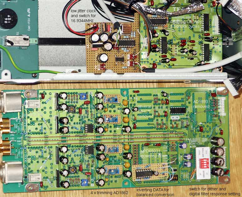

Everything works now
today, some weeks after starting this tuning adventure, I’ve come to a successful end.
After removing AD1893 as described in the posts above, I’ve set SM5843 into the mode where it directly accepts BCK, LRCK and DATA coming from CXD2545Q. This works very well, no glue logic (except switching circuit) is required between decoder and digital filter. Some minor distortions disappeared. But I have no idea how distortion performance is influenced by those 74HC**.
To make the signals provided by the digital input receiver compatible with the digital filter, I had to delay DATA by another 8 bitclock cycles. This is necessary because of the different word frame length of TDA1315H (32 bitclock cycles) and CXD2545Q (24 bitclock cycles).
Then there was a problem with the 16.9344MHz that must be switched. I’ve copied the switching circuit of BCK, LRCK and DATA which works well. And I’ve installed a TentXO which feeds the decoder and the digital filter. When connecting an external transport, there’s no benefit of precise clock and the difference in sound quality is apparent.
The output format of the SM5843 remains unchanged. I’ve omitted UPD65031 as well and settled for balanced D/A conversion by inverting one DATA line for each channel.
UPD65031 did some kind of signal conversion, maybe something similar to what is implemented in PCM1702 or PCM1704. Once I measured the output of one AD1862 (with UPD65031 still in its place). It measured perfectly even at low levels, but at signal levels higher than –1dB, even order harmonics increased to a very high niveau of about –35dB. There were no odd order harmonics at all. I guess the difference amp that followed the I/V stage has cancelled all even order harmonics.
Without UPD65031 guaranteeing low low level distortions, I adjusted every AD1862 as recommended in the datasheet. It’s great to see disappearing every distortion peak below the noise floor when adjusting the trim potis. With UPD65031 in its place trimming of AD1862 was actually useless.
For I/V and buffer I still use the original OPA2132 and NJM2114L. There’s no analog filter till now.
Of course I’ve added some Panasonic FCs, Oscons, small 100n Wimas and Micas. Output resistance is 75 Ohm, full scale output swing is +/- 3.5V.
I've attached a picture, because I know everybody likes to see pics :)
Fabian
