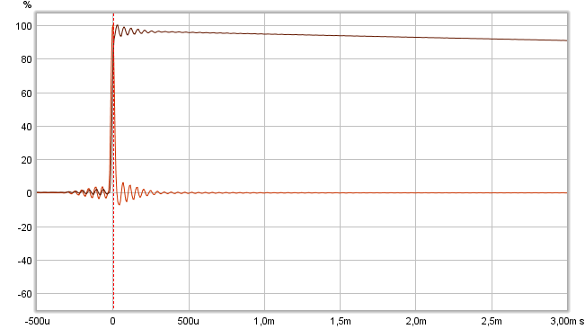

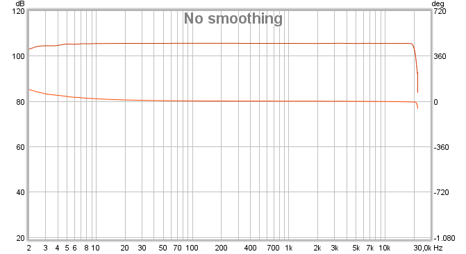

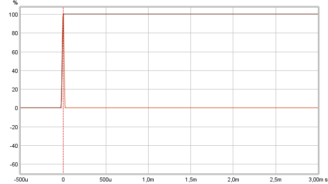

REW can correct soundcard or hole device chain automatic if you follow its help file or hints in post 1707, be aware in HF area calibration files is some sample rate dependent.
You can measure soundcard performance manual by hardwire loop I/O and run a measurement session in REW, below is a onboard ALC892 audio-codec measured without any other calibration file loaded so what we see is sum of I/O AC filters but we can't know what difference from perfect is coursed by input and what is output without use of another reference point.
Manual correction can be done with above loop measurement, get its IR centered with "Estimate IR Delay" and save measurement so it can be opened once more and offset the second one so SPL is at zero dB point and save this measurement as correction file for this particular soundcard loop at that used particular samplerate. Proof is on "ALL SPL" tab then "Controls" take the "first measurement" as A / (over) B where B is "correction lowered to zero dB", these two after push "Generate" button sum as perfect IR seen below.
If you adjust REW with soundcard calibration file its then reference flat between I/O so that any audio device placed in loop can be benchmarked be it pre or power amps but be carefull with power amps and use some resistor network at their output, also some power amps that are of bridge type have trouble because negative speaker connector is floating and has no in common with input ground.
Best precision in REW is probably not only loop back soundcard but have microphone preamp and power amp inside loop too and set as calibration file in "Preferences" "Soundcard" tab.

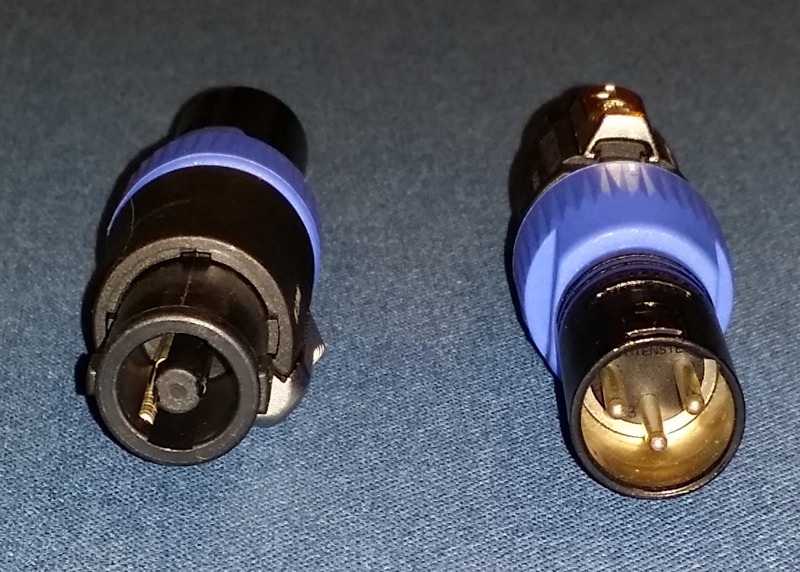

Agreed for sure. Wouldn't the microphone preamp (non USB mic) be included in the soundcard calibration, since the loopback is analog out back into analog in?
Adding the power amp into the equation is a step I almost never hear about...
I got these adapters in a few weeks ago to make that measurement....
I call them " Danger Will Robinson !! "
"Danger Will Robinson" :D scary vision for poor little sensitive mic/line input.
You right many have soundcards have universal input that in setting can be set as line in or microphone pre amp sensitivity, myself on preferred computer have only normal line in and in that microphone also need phantom power use a little cute Behringer mixer XENYX 802 to interface devices.
It worked perfectly !
My mackie interface is immune to the 48v DC on the ouputs :firefite:
I'm not sure that the Berhinger are protected against that mistake (others people should be careful) :rolleyes:
