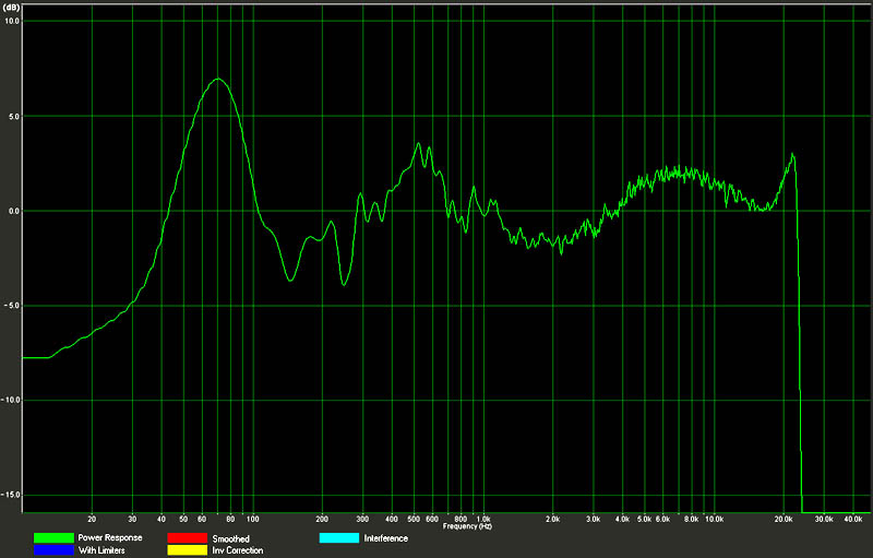

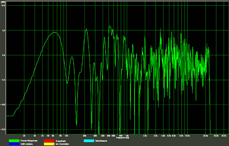

If you will make a RTA measurement you will get something like that.
attachment.php
But it is possible to find a measurement that is emulating our perception of systems behavior
and allow to remove almost any colorations, to allow to tune even different loudspeakers to same reference uncolored sound.
You were mentioning "averaging". It would be interesting to know your source for such idea : ),
but it was offered about 15 years ago, to use the Sound Power Frequency Response that is available from power domain integration (averaging) of sound pressure responses from an area of measurements.
And that allows to get such curve that is ready to use for detailed EQ.

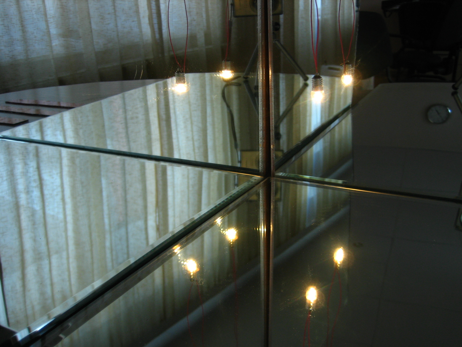

Thank you Raimonds! :)
Okay so I've been doing it mostly right.
I love the lights in mirror example. That is what I needed to see. I've just been a tad bit uncertain because I see some of these screen shots and mine never look that good. I tryed the 5cy filter on the IR and it worked! Thank you BYRTT!
I definitely have much more confidence in my measurements now.

Every sound source is emitting real power (Watts, Joules per second) that is being absorbed in an environment. And makes it little bit warmer : )
Each loudspeaker has its coefficient of efficiency that is relation between the electrical power submitted to loudspeaker and sound power emitted by it. It is around 4% for best loudspeakers in terms of efficiency.
The 15 years experience is showing that is very good to look on loudspeaker`s power response instead of SPL response in some point, for equalizing decisions.
The Sound Power Frequency Response is better describing the mutual work of 8 loudspeakers (1 real, 7 imaginary) as in mentioned optical example.
Its quality is so high, that it is possible to use it in direct eq filter synthesis just by inverting it.
Please visit "Knowledge base" of aplaudio website and take a look on paper "Equalizing loudspeakers".
It is possible to use software called Workshop to evaluate the sound power frequency response in very accurate and time efficient way. You can get pretty nice result in just 30 seconds measurement - 100 measurement points.
