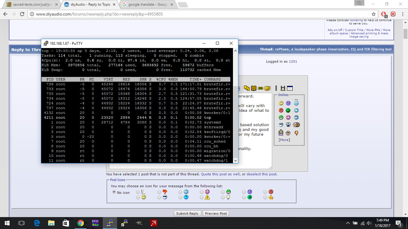

Im using a 3.2ghz processor. I have it set to 256 samples brutefir delay and Im using 8192 taps with a 5% impulse center(409.6 samples) so total delay is 665 samples or 15ms
I just logged in remotely :D (yeah, cant do that with an opendrc) and checked the processor and memory usage using the command "top"
hardly even breaking a sweat at 12.7% cpu usage and 3% memory usage.
this is with 10 channels/filters at 8192 taps each.
attachment.php
for the record, if there are no lipsync needs for home theater or live sound, you can run brutefir with no partitions (longer system delay)and it will happily run at 0-2% cpu all day
