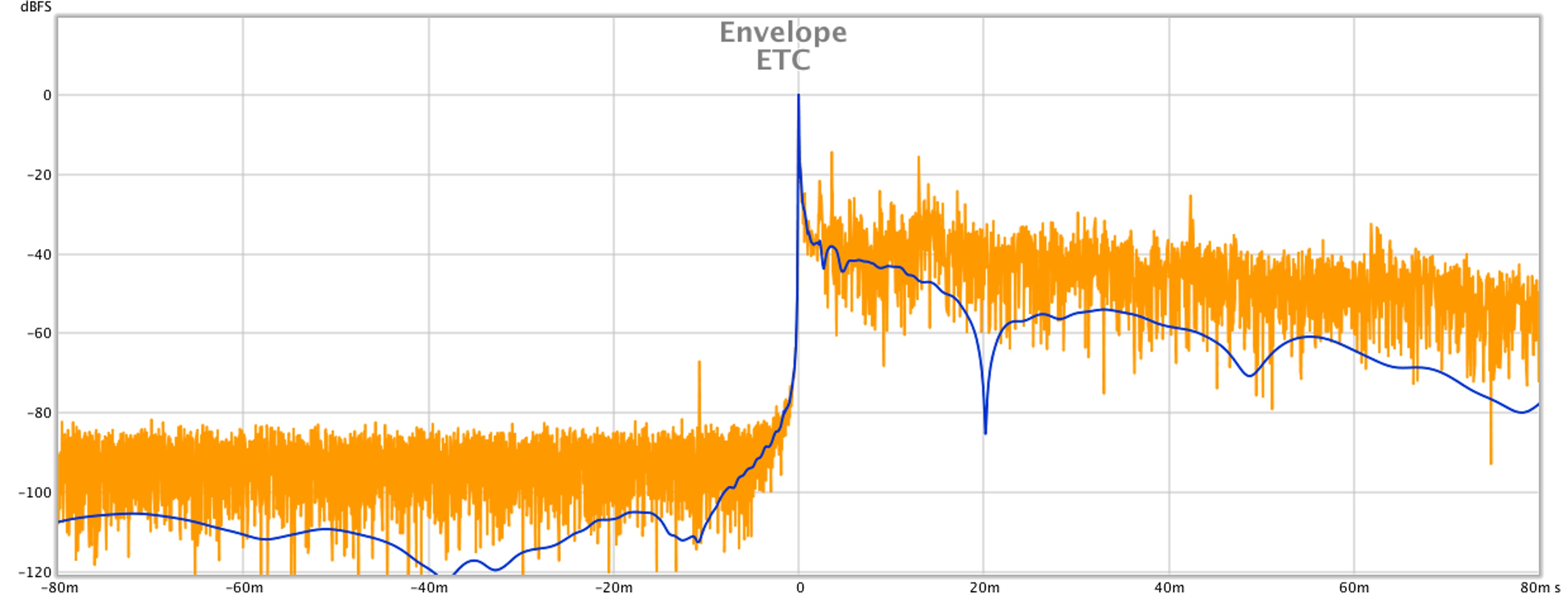

Another method for separating the characteristics of the signal produced by the loudspeakers from the noise added by the room is to use some kind of averaging technique.
Here is an academic view on the subject: https://www.researchgate.net/public...esponse_measurement_using_beamforming_methods

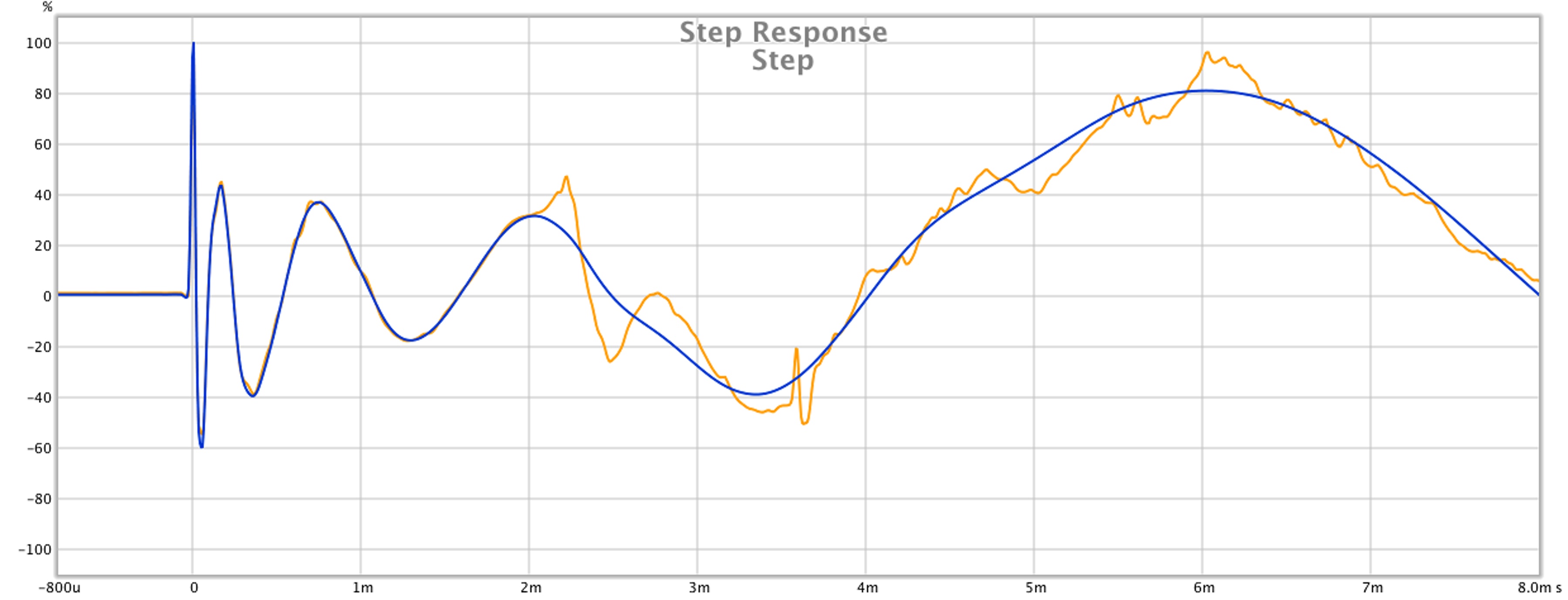

I am personally using a different technique, which consists in making 8 measurements at the edges of a parallelepiped (stretched cube), which is containing the listening area. I sometimes add a ninth point which is the center of this parallelepiped and is the sweet-spot. In my case, the parallelipiped is 0.8m wide, 0.4m deep and 0.2m high.
Using either the (A+B)/2 impulse algebra function of REW in case of 8 measures, or simply the A+B function, I add all the impulse responses, after having carefully centered each of the impulses in the time domain to make sure not to have phase errors when adding them.
This way, the noise of the room is considerably decreased and the remaining is the signal averaged at the listening position.

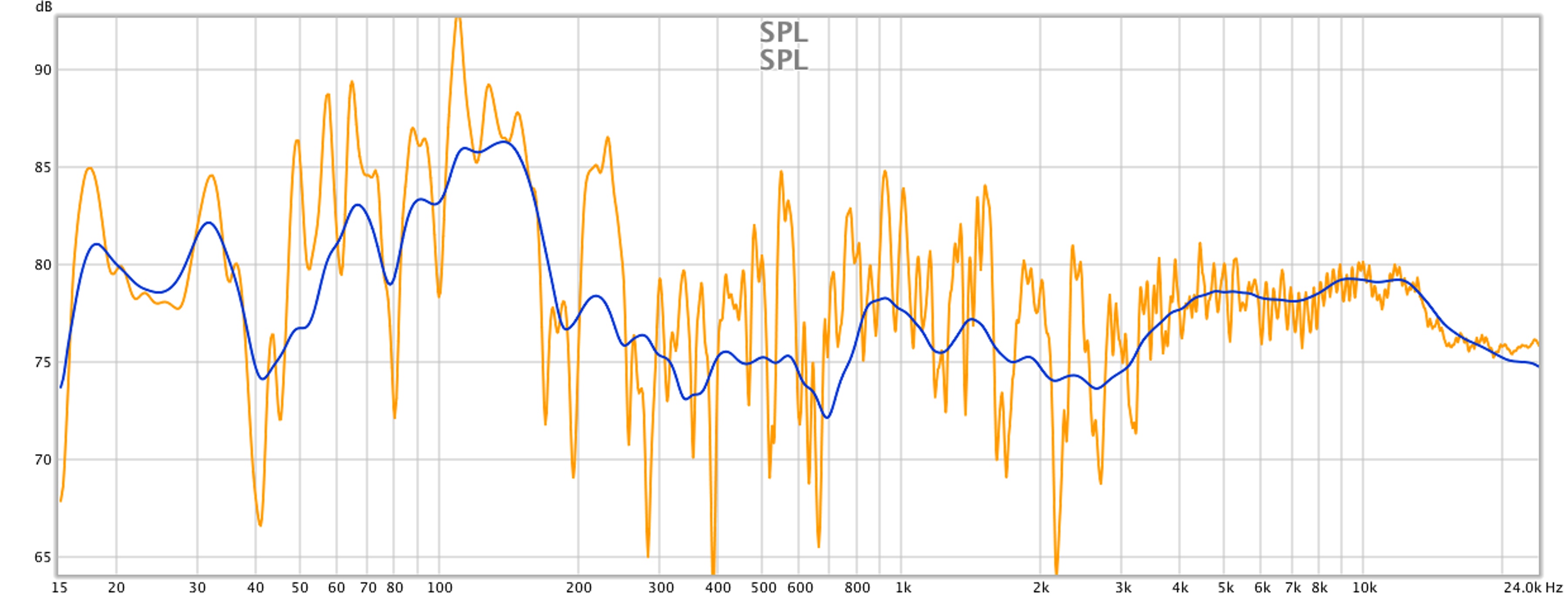

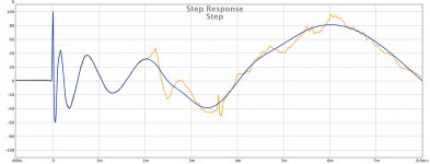

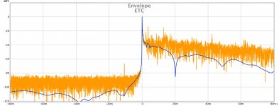

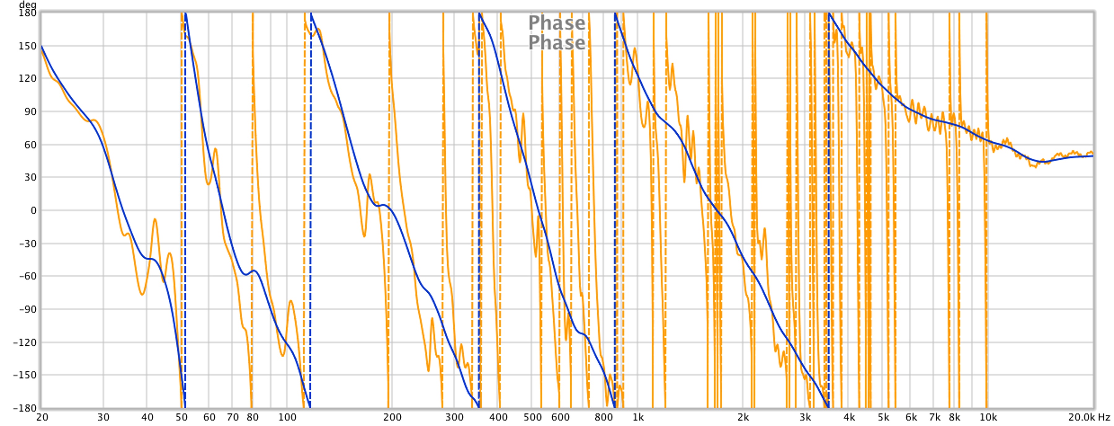

Here are some illustrations. In orange color, the measurement at the sweet-spot in 1/48th octave smoothing, without any Frequency Dependent Window. In blue color, with the exact same parameters, the sum of the 9 measurements, corrected for the amplitude.
You can observe that the phase signal for instance is much cleaner with this technique... On the ETC curve, you will notice that the early reflections of the sweet-spot measurement have been wiped out by the summation/averaging process. This is the reason why the signal is much cleaner.

That's indeed a good way to separate the sound from the speakers from the noise floor.
If I recall Mitch has a chapter on that in his ebook?
Hi Wesayso,
Yes you are right. He has a chapter on Beamforming, but a different one, based on the axis orthogonal to the LS axis, in order to respect the measurement symmetry which is key for Acourate. Although he does not seem to be a big fan of that, as he has the conviction that Acourate has a better algo to calculate the correction from a single measurement at the listening position.
In my experience, and with difficult loudspeakers (like wide-band Voxativ Zeth), this has not been the case, and I reached a much more pleasant listening environment with REW/rePhase and the averaging technique.
So it's pretty much up to everyone to decide what is worth for him/her. But I thought it was worth sharing
The beam forming measurement method I used is attached. It is a delay sum technique, which I found to work very well for suppressing midrange and high frequency reflections.

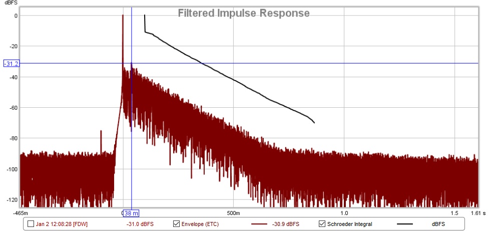

Hi all,
been trying to learn the workflow between Rephase and REW, and admittedly finally learn REW in general.
Until recently, I've been using Rephase manually with measurements made with Smaart, and have been pretty happy with results..
But REW seems to offer more ways of looking at the data, particularly in regard to cleaning up the impulse and step response...as well as measuring distortion, etc. And most importantly, it's more a language this forum uses
I'm working on a live-sound box, the Peter Morris DIY 60 found on soundforums. It's a 3-way horn loaded double 12" mid, and a BMS 4594HE coax CD.
I'm not at all concerned with in-room performance, and all measurements are made as reflection free as possible. Pattern control substitutes for the "room". The box is for 100 Hz up....and crosses at 650Hz and 6300Hz.
I've followed the recent advice on how to use REW's auto EQ capability for export to Rephase, and built some new FIR filters.

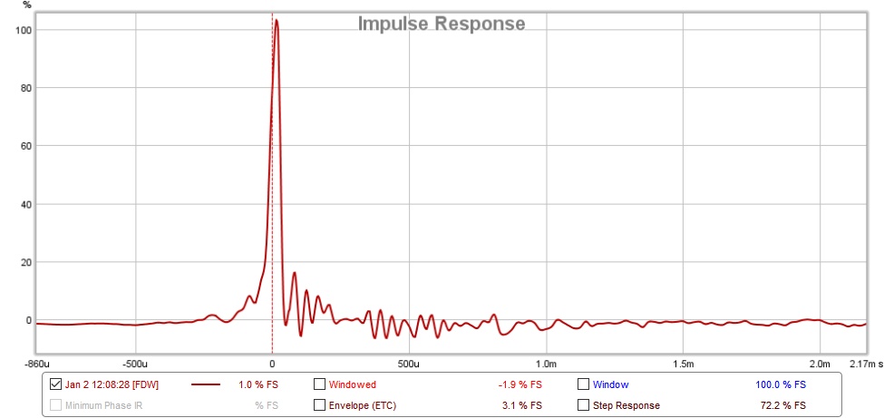

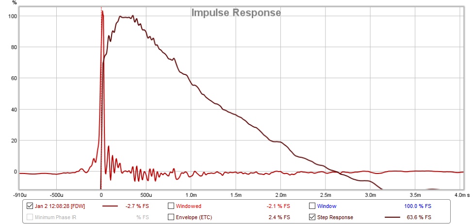

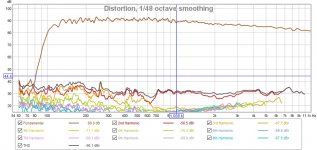

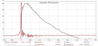

In line with Wesayso's advice to start with the impulse response, here's what I've got so far... first image below....
(btw, Ron, I went through the whole 2-towers thread as a primer on how to use REW...awesome project, super results, and gracious sharing of info..congrats and thx!)
A few questions regarding the impulse plot:
%FS is above 100%...how so? ("Plot responses normalized' is checked..)
The peak of the impulse is about 18 u sec off of where REW's 'Estimate IR Delay' puts it.... why so?
If I shift t=0 manually in experimentation, I read in the help file that the 'System delay' as shown in the 'Measurement info window' should shift by said amount...it doesn't...am I misunderstanding help?
How do I figure out what the two patches of 'fuzz' after the impulse peak, are telling me ? (The first patch right after peak centered at about 130u, and the next centered around 500u.)

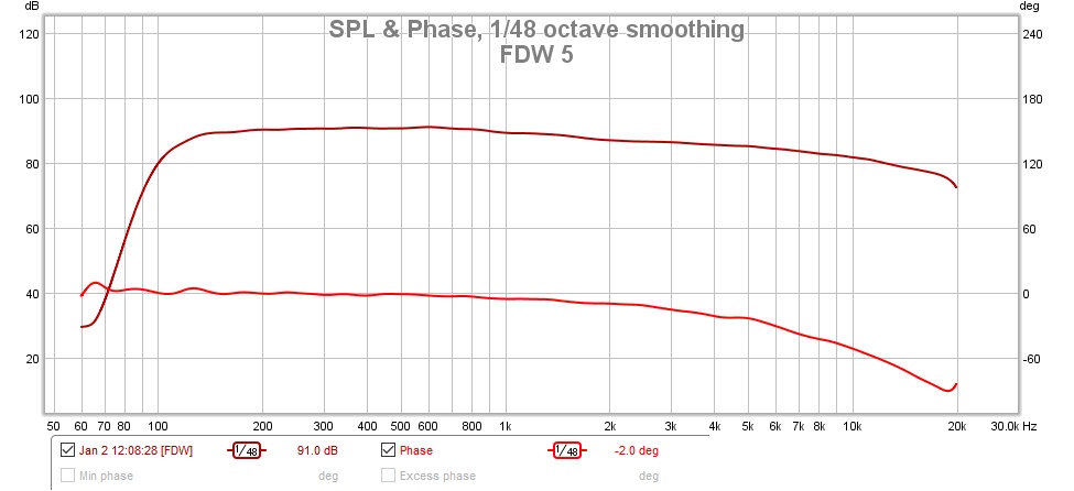

OK, SPL and phase next....
I got more SPL roll off from 1000Hz than I wanted, but I know how to fix that. (used default 1.8dB slope ...will move to 1.2 next build..)
What I can't find a way to fix is the phase rolloff on the high end.
I can get perfectly flat phase in Rephase, but measurements always roll off.
It seems to do with how REW determines t=0 again..
For instance, if I take the FIR file behind the phase graph below, and shift it 15 u sec in rePhase, the predicted curve is flat as a pancake.
But new measurement stays the same, as far as the rolloff...????
Nothing I do seems to be able to bring the phase rolloff up...
Last plot for now, step response....
don't want to wear out welcome asking too many questions
What causes the step to first rise after the impulse peak, taking about 200 u sec to hit 100% and then start falling? The first batch of 'fuzz' again?
I do thank all for any help given here...

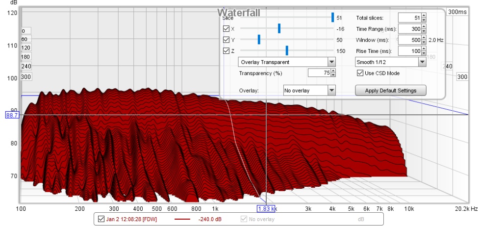

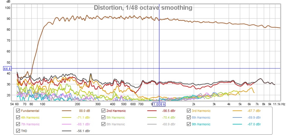

I've attached further graphs if they can assist...
