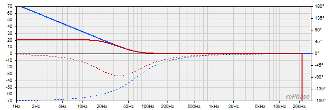

Regarding this second highpassfilter to add wih the compensate, in case of LT for a closed box.
Any recommendation of the steepnes / slope of this filter? Let’s say I want full output to 20Hz. Then I want to reduce everything below 20Hz as much as possible, without degrading sound. Ringing a concern here?
Minimum-phase or linear phase recommended for this highpassfilter?

The steeper the filter the longer the (pre or post) ringing, so you need to pick your poison here ;)
Looking at the excursion curve is generally a good way of choosing the steepness: no need to go overboard, especially considering the actual content in the <20Hz range.

I never understod that ”an additional filter...” was an high-pass. I was stuck in thinking about the extra shelfing for the bass I want. Compensate + shelf, not compensate + high-pass + shelf. Do you see? You’re with stupid.
Why is this a "high-pass" filter? The function makes things flat. Then, if you don't want it flat you add an additional filter which can be anything you like - thats how I understand it?
The "high-pass" referenced above was just an example for an other user - there is no mandatory "high-pass" to be added as additional filter.
Right?
Think the "WHY" is because else you ask for non practicable real world boosts in compensate mode, below blue is 66Hz sealed box compensate and at DC potential it will ask for +70dB :p then the red one is a little more practical asking for 21dB boost rolling that sealed box system off at a BW2 20Hz.
attachment.php
Fair enough. But is that "shelf" realized with a HP?
hmm, maybe it is - yes...
A filter with minimum ringing in time response has Q of 0.5
The good old record player rumble filters had 12 or 24dB/oct.
A IIR in front of all FIR filters should be considered. But even such filter will have delay as groupdelay
So IIR low pass & high pass, record with REW the response and then FIR to flatten the phase and SPL dips/spikes in the intended usable range? Is this what you are thinking?
Yes, if you ask me:)
Nowadays in digital domain LP filter is optional:)
:scratch1:...think above points in all directions and is very hard to interpret and understand, is it encrypted : )
I endorce your solution, Byrtt to straighten out the curve.
Actually just trying to point out that a 20Hz HP filter has been used for a long time to protect bass element from rumble. 12 to 24 dB/oct filter is common.
I forgot to mention the 0.5 Q applies to the IIR filter.
Use of IIR in low frequency is just to save latency. If the FIR filter is 200ms it is no need to bother with IIR in front.
The LP comment is just a comment about filtering RF pollution in analog domain. And certanly out of topic. Sorry
