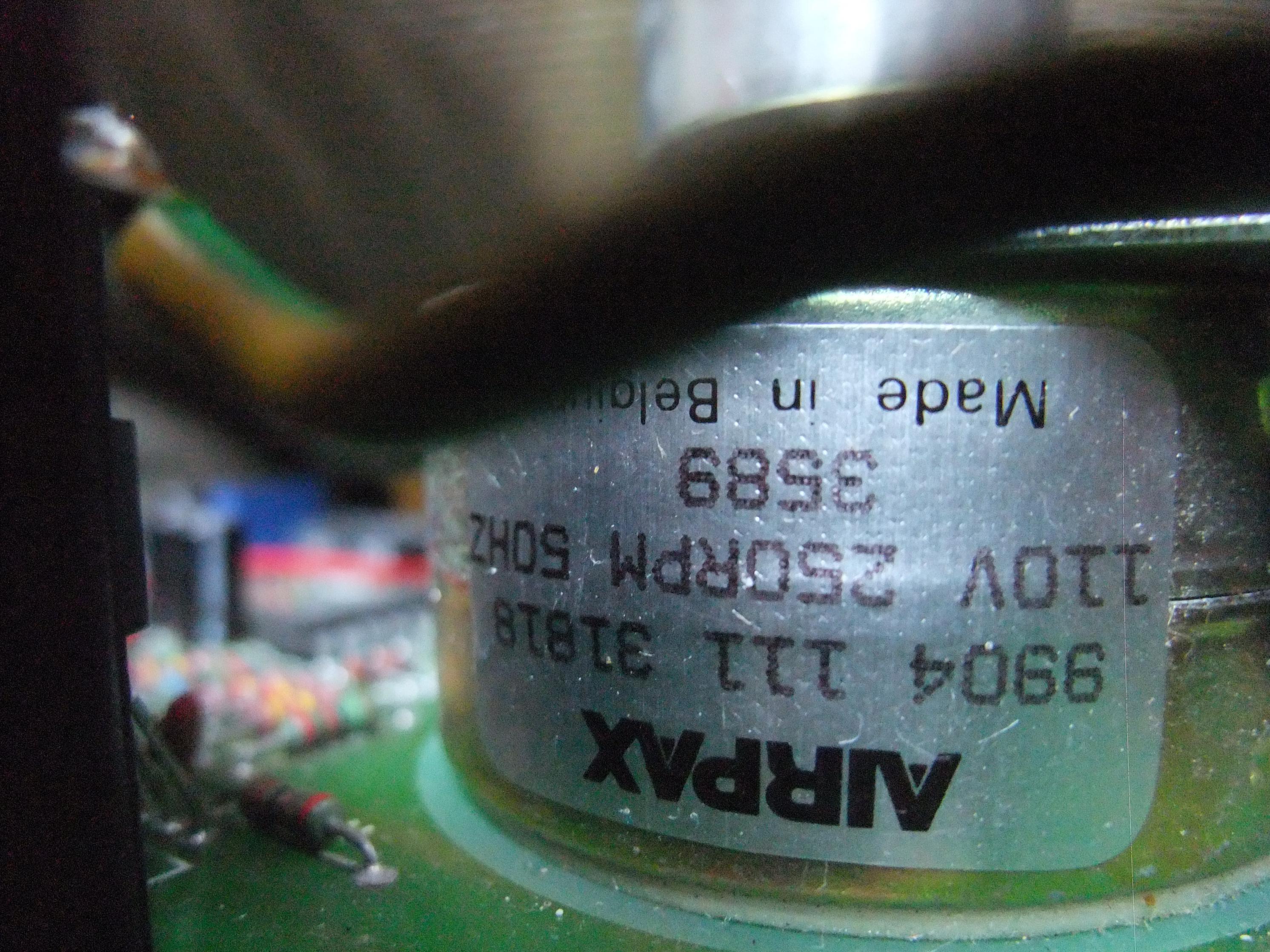

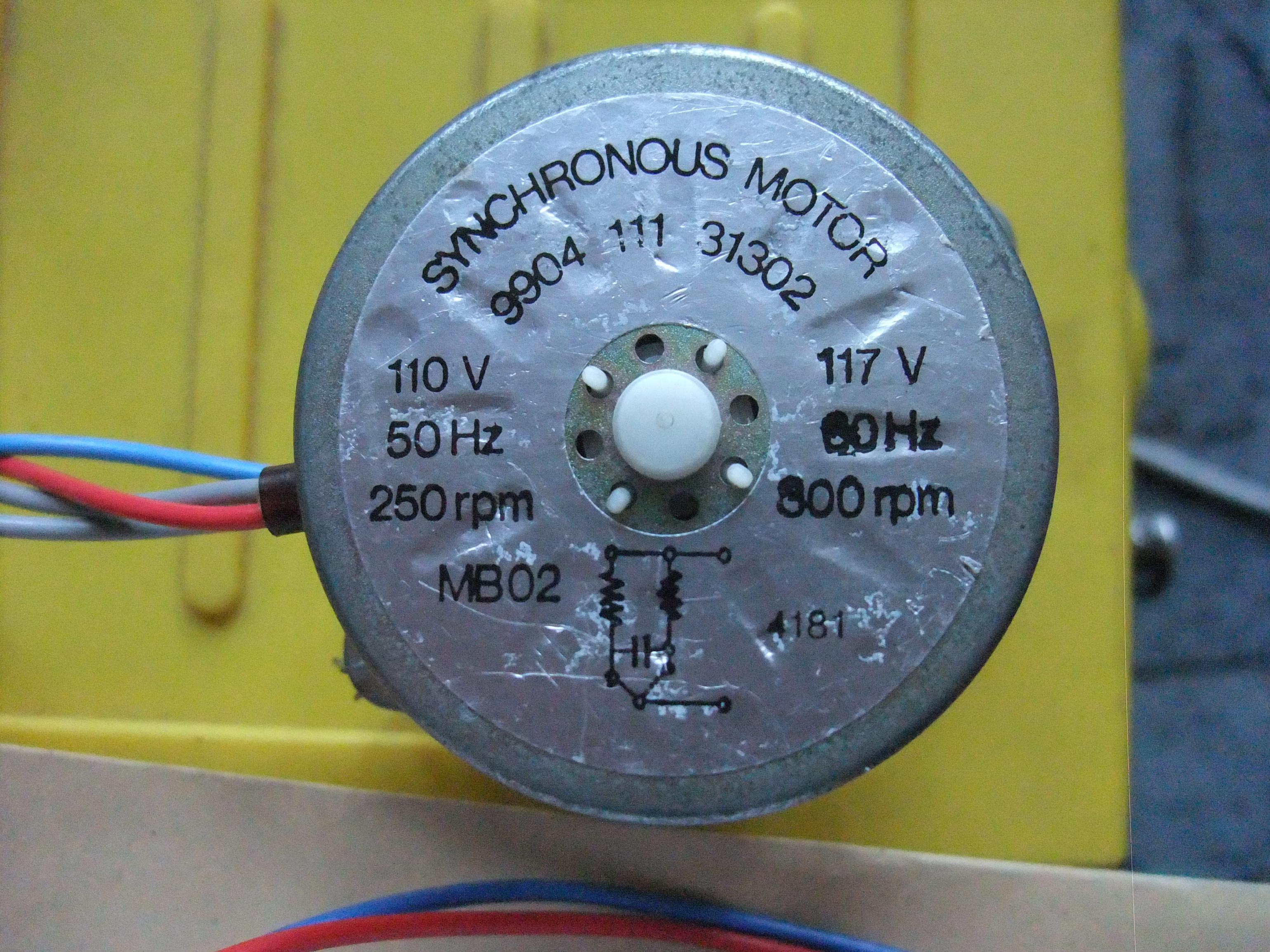

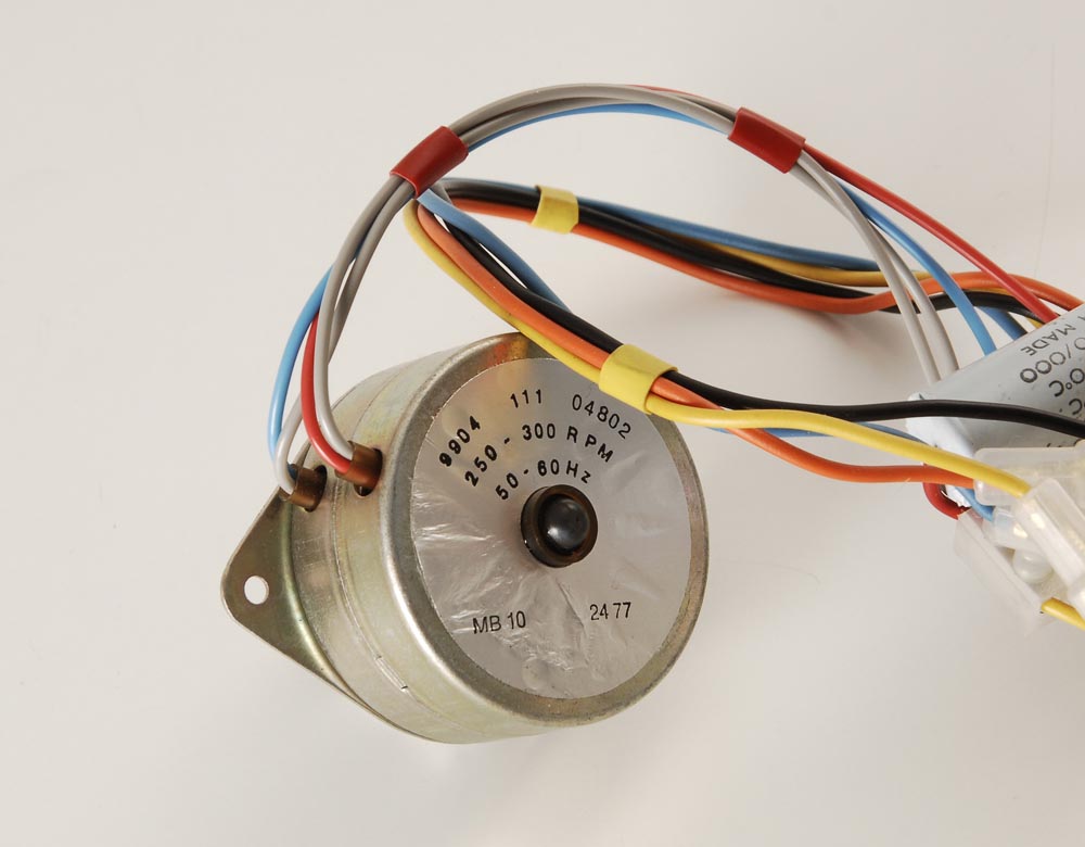

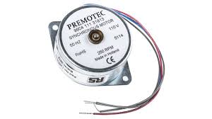

9904 111 31813 Series AC Synchronous Motors by Allied Motion
The question rises up, because with the old Philips/Airpax 110VAC versions (- go to first both attachment) it was really not to be expected that they would already run flawlessly between 18VAC and 25VAC with platter load from turntable.
Motors from attached images:
1) 9904 111 31302 MB02 (30 years old, VALVO/Philips Components)
2) 9904 111 31818 (20 years old, Airpax)
3) 9904 111 31813 (McLennan)/RS/Premotec
4) 9904 111 04802 (without brand naming)
5) original motor without brand naming for US-$ 299

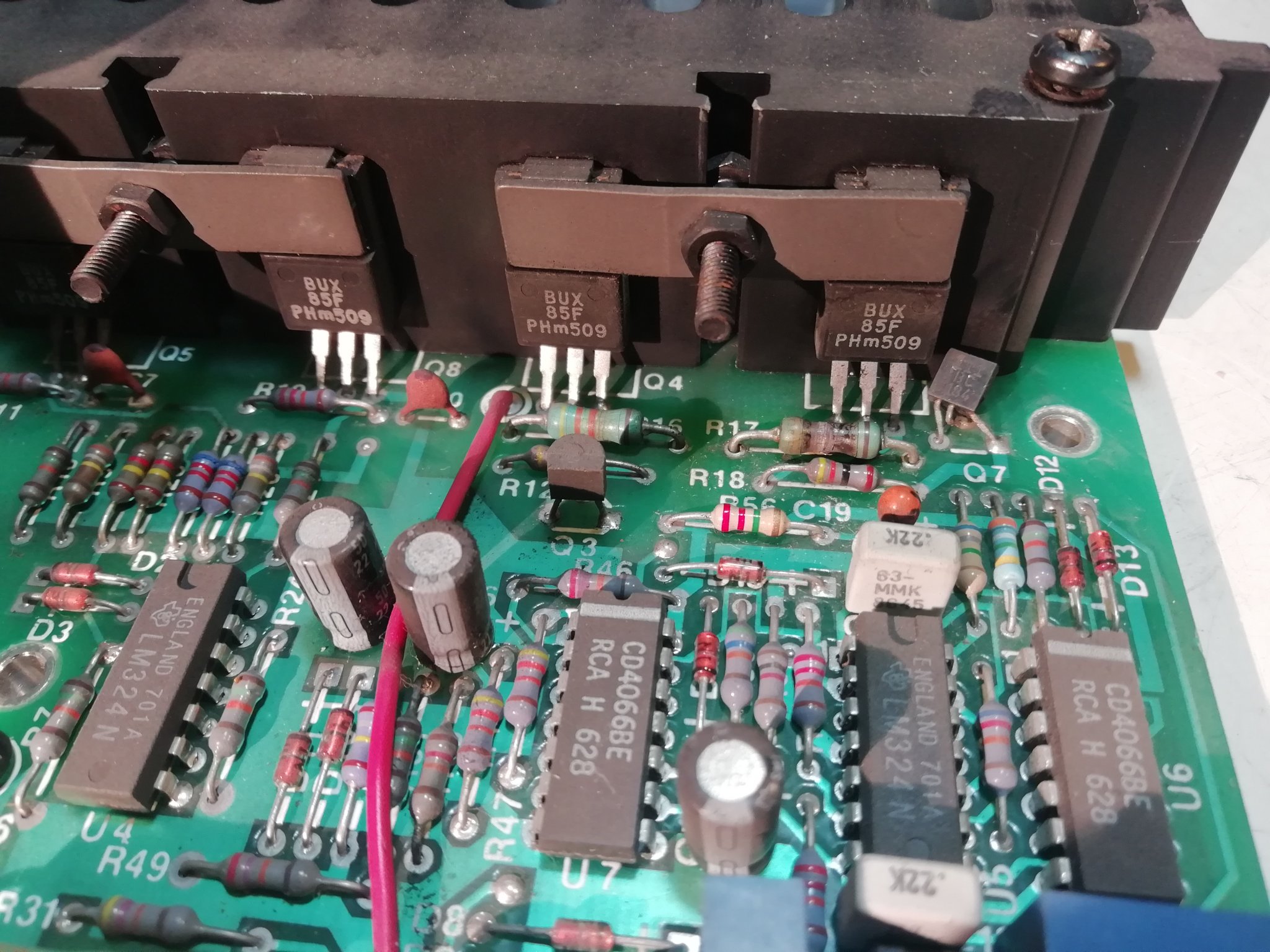

there are various versions of this board. Some versions uses too small wattage for the resistors R17/16 (43K). For replacing use 2W version.
R23/6 is a usual low voltage version on the most boards. Creating high-voltage version is easy to realize. Use serial connection of 3 pcs. 270K or 430K+390K (several versions of this board was equipped in this kind).
BC184 = BC547 (T7/3)
For BUX85F (T4,5,6,8) I don't know exact replacement.
I use BUX84 or 2SC2501.
But please note: Outline is TO220 and no plastic version, i. e. not electrically isolated mounting base like

further the fusion described in my previous of R1 (3w) R12 R16 and R14 I have replaced the transistors destroyed after checking the Junction
Q3 Q4 Q5 Q8 ko
Q6 Q7 ok (after second checking)
I got BX 84 to replace BX84F but It is needed to add mica isolator in sandwich since they are metal not plastic (collector on earth)
I set up mains and check usual 322 v and 13 v in power supply stage but no bright of the red or green 33/45rpm when i press start
The motor "growl" 5 to 7 second but does not turn
I put the scope on O1 & O2 that show the two sine wave 0.1 v (peak to peak ) in standby and 0.3 v (peak to peak ) when I press start and back to 0.1v after 5 to 7 sec
I put the multimeter on WO1+WO2 windings that display 20v
I put the multimeter on WO1+half point 10 v and WO2 10 V
I understand that the motor is not properly fed as a result
Please coud you tell me the additional point of checking either with the scope or the multimeter...
So ,i am wondering if the digital circuit is involved by the trouble since there is not any more lighting of the red and green led.. ( i have checked the two ones on multimeter ok)

Hi, new member here,
I'm fixing up a Linn Axis from 1988 - usual problem of motor not starting or going backwards - and have recapped it although all the elkos measured fine with no elevated ESR.
However bias resistor R17 (43k) is burnt up though the associated transistors Q6 (BUX85F) and Q7 (BC184) seem to be ok.
I'm unable to find a 2W resistor to replace it - apart from the usual Chinesium - so is making up a series/parallel network out of 4 x 43K 0.5W metal film resistors an acceptable solution? The original parts list suggests a power rating for R16 and R17 of 0.25W which seems very low.
Thanks,
Simon
...I'm unable to find a 2W resistor to replace it - apart from the usual Chinesium - so is making up a series/parallel network out of 4 x 43K 0.5W metal film resistors an acceptable solution?
Your proposed solution will look messy, but it's acceptable.
If the motor fails to rotate in the correct direction, there's a drive phase or motor winding failure. Check the motor windings for continuity.
R16 & R17 resistors do get hot during normal operation (motor running), but your picture shows a catastrophic failure. You'll need to find the fault!
The safest method of testing the circuit functionality is to remove the MAINS supply from the PCB and apply 12V DC (observe polarity) across C5 and check operation (12V DC PSUs are available on street corners ALL over The World). Old redundant modems/routers are a ready source of 12V DC PSUs.
If you're satisfied that the low voltage circuitry is fully-functional (observe the changes in LED intensity etc), energise the +320V rail with +12V - it won't turn the motor, but if you attempt to rotate the motor pulley in a counter-clockwise direction, you'll feel it kick back.
Good Luck!
P.S. Don't forget to replace resistor C19 (that's NOT a mistake - tantalum capacitors are the only resistors that I've seen decrease in value). Use a film capacitor.
