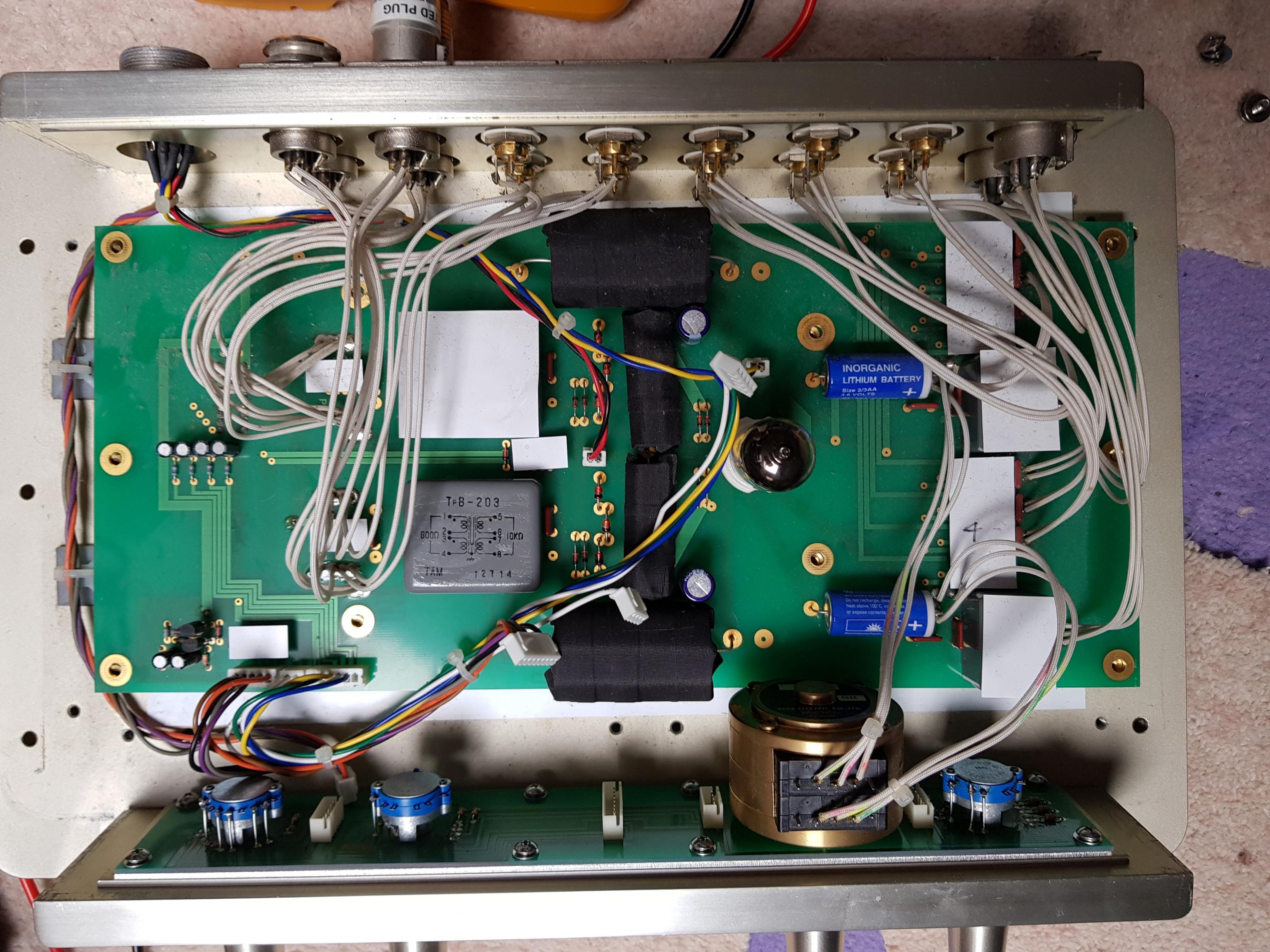

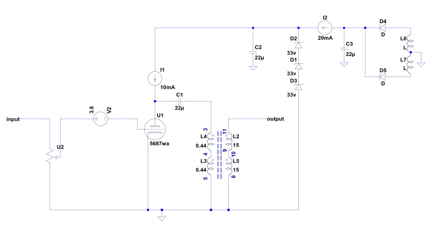

There appear to be separate CCS/zeners/decoupling caps for each channel. Chances are some of the current diodes are still alive. As they are paralleled, a short measured across does not guarantee both are bad. It is a very good idea to have them tested for current. Unless someone can recognise the type.
The batteries definitely need a change after 12 years.

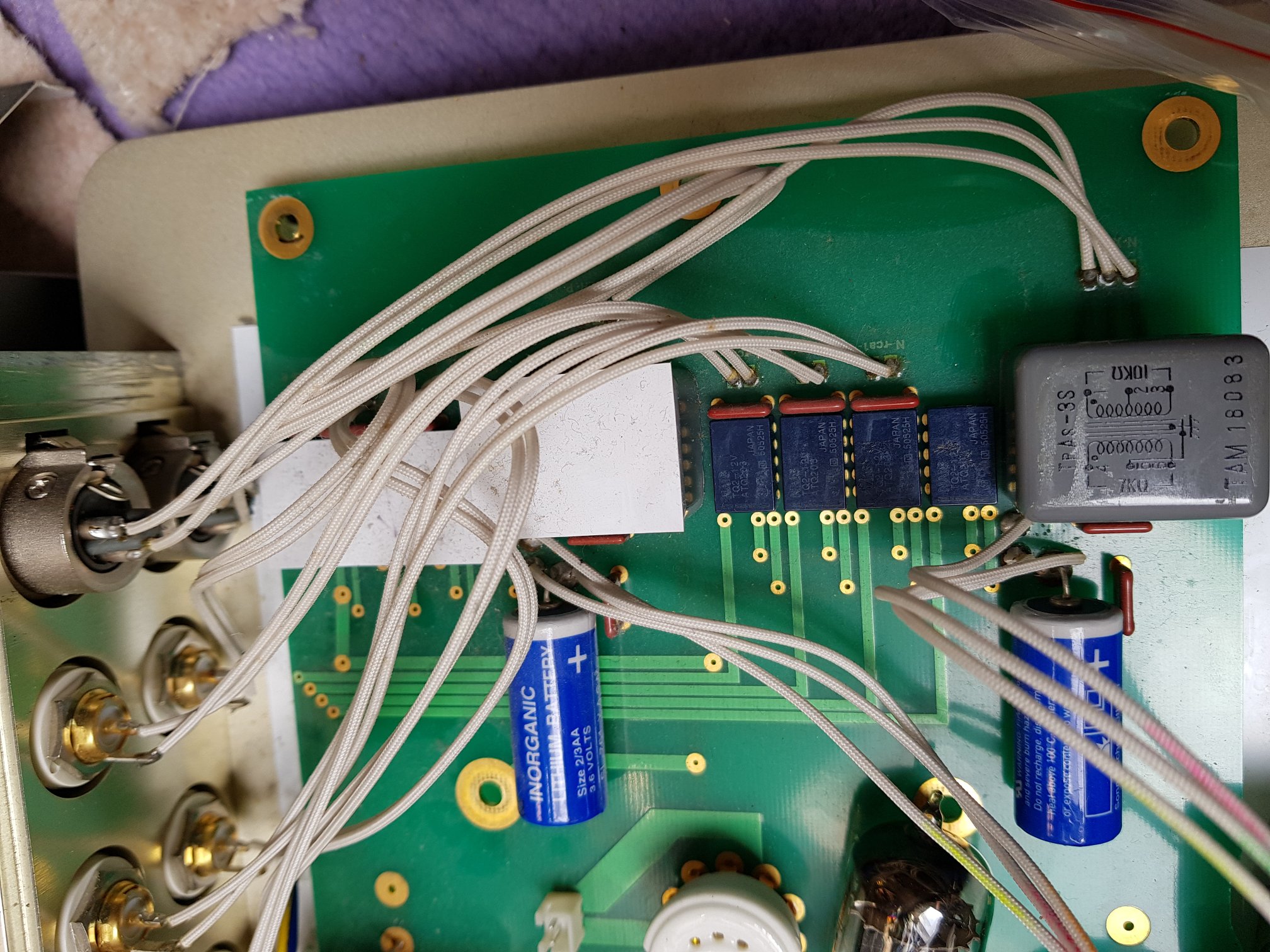

Those lithium batteries are commonly good for 20 years + in test equipment as battery back-up. However, replacing them now that you have it apart is a good idea. These batteries are still manufactured by various companies. I just bought one for an HP 5372A, so I'm certain you can get them new.
Otherwise I agree with you completely as to the probable supply circuit.
-Chris

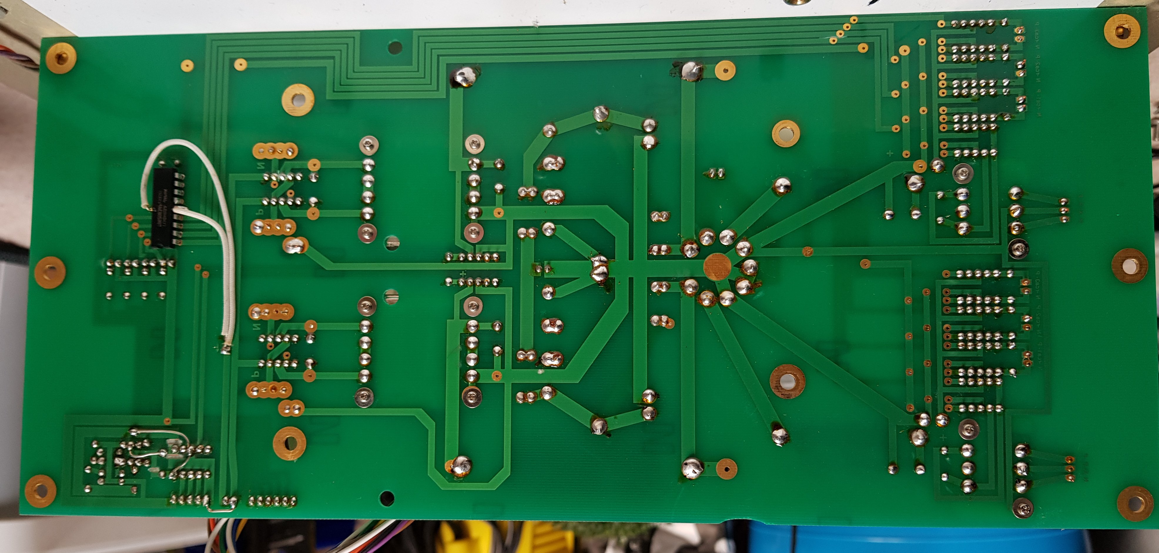

So here's some more info, the power supply box has a semiconductor regulated supply for the 5687's heater. There are relays in both boxes to switch the final power on and provide a delayed power up. I believed the visible transformer and the one in the bottom right is just for balanced input and output (I think I read that in a review). As regards the capacitor values in my original diagram I read them with a fluke meter, generally but not in all cases with one end disconnected from the circuit.
I also posted a couple more images.
Tried again with the images.
Indeed, the input transformer is not used as a means to provide bias. Unless the zeners and current diodes can somehow be identified, these should all be removed and tested with the hope that some still work in order to establish the original bias points.
