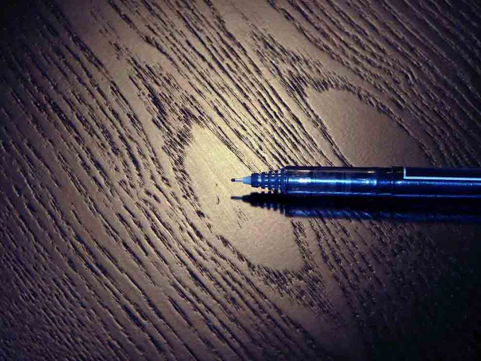

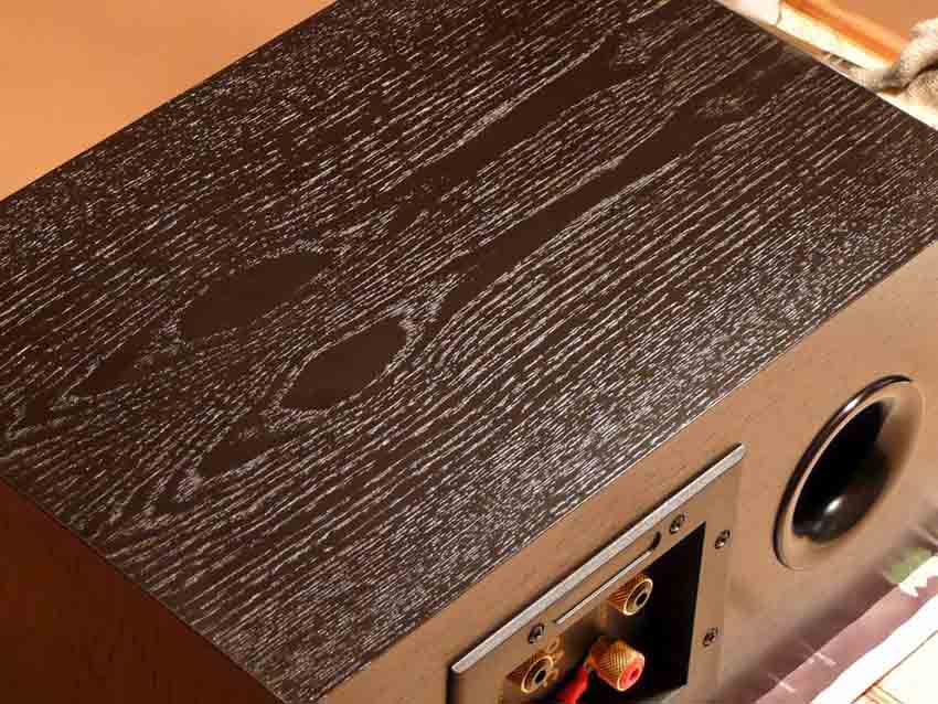

Thanks folks. Hopefully these pictures will convey what I was trying to
describe.
These are shots of good areas of the original finish which I want recreate on
the face I sanded.
It's hard to photograph black but I think it gives the idea.
How can I recreate this finish on the face I sanded?

I'm inclined to agree with R-Carpenter, likely the finish was simply painted on; that is it was 'paint' not stain.
It's difficult to experiment on the actual cabinet itself. I would be better if you had a spare piece of wood. I think the first thing you need to determine is the degree of flatness of the finish; flat, satin, semi-gloss, or gloss. I'm thinking likely satin or semi-gloss. Then see if you can duplicate that.
It is possible to paint with flat black, then coat with clear satin or semi-gloss. Or any other combination to achieve the desire result, like paint it with gloss black then finish it with satin clear.
At any rate, it's a complex process trying to match an existing finish. It would be better to simply put a new finish on the whole thing. Lightly sand, choose your undercoat and spray, then choose your finish coat and spray.
Are you familiar with Candy paints. They are the clear colored paints they put over metal-flake on custom motorcylces. You could spray an undercoat of flat or satin black, then sand it lightly, and coat it with a clear gloss or satin black 'Candy'. That would give the appearance of a very deep finish.
Not worth much. Just a few thoughts.
steve/bluewizard
Think of it this way. 99% of commercial speakers are sprayed in the spray booth. 99% of them use pre catalyzed or regular nitrocellulose lacquer. From the picture, it’s obvious that these cabinets are spray-painted. So, just do the same thing.
Where to find it:
Look in the phone book at “furniture restoration supplies”, “finishing supplies” Call them and ask them if they carry Satin Black nitrocellulose in the form of spray can. In US, it’s about $7 a can.
How to spray:
Nitro stinks; so either do it outdoors or with the fan in the window. It’s also flammable, so no smoking.
Lay your speaker on the side and give it a couple of thin crosshatch coats. If you get a hang of it, you could give a entire cabinet a quick overall. One can should be more then enough.
If you concern about abuse, get a can of clear satin lacquer also and topcoat with it.

That veneer originally might have been treated with a chemical to open the grain more than normal. The wire brush could scratch the summer growth (hard, flat parts), and make a real mess of it.
I would sand the entire side with 120 grit paper. Then 220 grit. Clean with a vacuum or blower, brushing out the grain with a toothbrush.
Then paint it and see how it looks. Worse comes to worst, you completely refinish both boxes on all sides.
Ash as any other wood has pores through out the thickness, solid or veneer, doesn’t matter. You didn’t sand off the pores, you just made the surface so smooth that you can’t feel them. Lacquer or whatever you going to use, will make them reappear again. Wipe the surface with moist rag to see the pores again.
It could be that you sanded the veneer through to the glue line. That would be bad but I hope it’s not the case. If it is oh well - wire brush.
ProAc aren’t using any special lacquer. Any commercial speaker manufacturer, just as if a furniture manufacturer is limited to a cost involved in to finishing. Cabinets have to look as good as possible and as cheap as possible. There’s no magic, no campaign and no secret sound absorbing military grade lacquer. There are also minimum of handwork involved in producing these cabinets. No gnomes running around the factory with witch hazel, opening the grain. I’ve done this finish quite a few times. The variations come from the type lacquer. Some environmentally friendly companies are switching to water base lacquers or polyurethane.

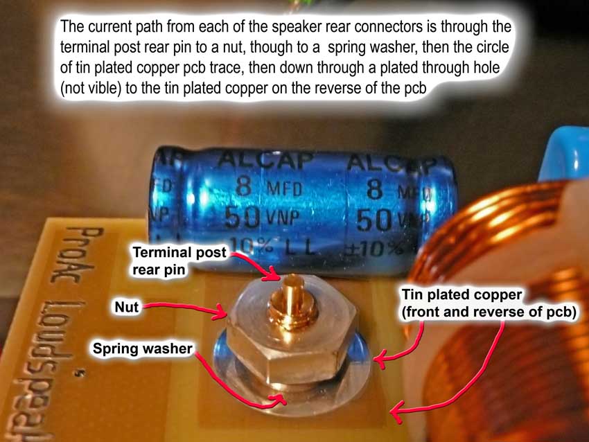

I was particularly disappointed to note that the current paths in
from the huge golden coloured connectors on the back are through
single tiny steel spring washers to the tin plated copper pcb traces!
They're on the wrong side of the pcb too so the first thing a current
has to do is pass back down a plated through hole! It makes
manufacture straight forward but also makes a mockery of the use
of huge connectors and all those 'magical' tweaks people believe
improve their HiFi's! So that makes me wonder if my ProAcs (which I
got dirt cheap by the way due to one having a blown woofer) are
really that good or have I just been hypnotised by the brand
image? I hate the thought I might just be a techno-fashion victim!

Welcome to the wonderful world of commercial loudspeakers. You forget to mention a 15c electrolytic capacitor there.
Car paints have different expansion-contraction properties then wood paints. They are usually more expensive then a majority of wood coatings. Basically, they design to stick to metal and hold up to the sun, rain and bird droppings.
The reason, I suggested NC is because 99% of cabinet factories (and ProAc either has their own factory or sub out cabinet work to someone local) will use it for price-value relationship and easy (in commercial environment) application. It dries fast, gives good enough scratch resistance and it’s cheap. The next step or I should say upgrade is Pre catalyzed NC. The application involves more precision and it’s very sensitive to the thickness of coating. Another words, you spray too much, it’ll spider crack. However, better scratch resistance and only 3 coats needed to achieve a nice finish.
Looking at the crossover picture, I would guess that ProAc is extremely budget oriented and it’s probably just NC. Can’t say a 100% without running a test.
I have to mention that not all of these coatings are compatible with each other. Acrylic lacquer may pill off from NC base after a while. It may not. Either way, wet sanding wood is overkill and you may find out a hard way how good the veneer job on that cabinet is. 220 or 320 are perfectly fine.
