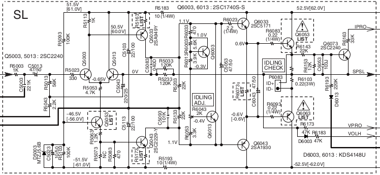

I got this Onkyo TX-SR506 from eBay cheap, as faulty. It looks like a fairly decent amplifier, so I want to fix it.
It will power up into standby with a red LED. Pressing the power button makes a relay click. VFD lights up and works, then a few seconds later, the relay goes out, VFD goes out and the power LED flashes continuously until the power button is pressed again.
Upon disassembling the unit, I found one main output transistor on the SL channel to be failed. This is a 2SA1941. This transistor is obviously burnt, with a hole in it and associated burn mark shot up the heatsink. All of the other channels look good, though I'll probably replace the complementary 2SC5198 too, as I believe that may have sustained damage despite showing no signs of failure.
My question is, what part to use for these? I can buy them on eBay, but they're almost certainly fakes. I can't find them from Farnell, either. I -did- find some other parts, such as 2SA1294 and 2SC3263 from Farnell (Sanken/Allegro parts); would these work well? This amp is "only" rated to 0.08% distortion, and I'm not particularly concerned about the distortion being higher, my concern is simply will it work (and not sound awful?)
In addition, do I need to replace the driver transistors 2SA1930 and 2SC5171 and the 0.33 ohm resistors? The 0.33 ohm resistors are a combined, matched device -- do I need to find an equivalent if they're failed? I'll borrow a good Fluke from work tomorrow and test these as well as the test points in the service manual.
Any advice appreciated
OK, I've just had a lesson in WHY disabling protection circuits is a bad idea.
The amp wasn't staying on for long enough to check the bias voltages so I cut one lead of R6173 -- DC fault detect. I'm not connecting speakers, so I figured it's fine.
As expected the output rose to +52V or so... and a few seconds later, two capacitors blew up. LOL. :eek: They were 50V rated across the bases of the main output transistors and across the drive transistors; and experienced around 100V due to the shorted base-collector/ base-emitter junctions. So they very quickly failed. But at least I know where the fault is: looks like I'm replacing both the driver transistors and the main transistors. I tested the 0.22 ohm; it's fine, along with the other parts including the base resistors.
The capacitors were crappy TK Audio capacitors; I think I'll use Panasonic FC for replacements.

The next problem is finding replacements for the 2SC5171 and 2SA1930 driver transistors -- any suggestions? These are TO220, insulated case non-heatsinked devices.
Schematic of the channel (surround left), for reference.
I think each channel is exactly the same, at least, I can't see a difference.

Ok, I think I'm going to replace all of the transistors in the amplifier -- it's only going to cost a few pounds more, so it's worth it for my personal assurance. I'm getting the main output transistors from Farnell, and the rest from Kessler Electronics.
Q6053: 2SA1294 -> NJW0281G
Q6063: 2SC5198 -> NJW0302G
Q6033: 2SC5171 -> 2SC5171
Q6043: 2SA1930 -> 2SA1930
Q6003: 2SC1740 -> 2SC2240
Q6013: 2SC1740 -> 2SC2240
Q6073: 2SC2240 -> 2SC2240
Q5003: 2SC2240 -> 2SC2240
Q5013: 2SC2240 -> 2SC2240
Q5043: 2SC2229 -> 2SC2705
Q5033: 2SA949 -> 2SA1145
Q5053: 2SC1815 -> 2SC1815
I've made some substitutions (bold), because the particular component wasn't available. Mainly based on the advice I found on the net and careful reading of datasheets, but I'm not 100% on these. Can anyone confirm that my substitutions are OK?
In addition, I need to replace:
C6043: 47u/50V TK Audio -> 47u/50V Panasonic FC
C5053: 47u/50V TK Audio -> 47u/50V Panasonic FC
R6103: 0R22 matched -> 0R22 x 2 (1%) 3W
R6173: 47k 1/8W -> 47k 1/4W (chopped one leg off disabling DC detect)
R6073: 82R 1/8W -> 82R 1/4W (measured 300 ohms in circuit -- probably bad)
Damn the amplifier board is hard to get out! For reference the back AV plate can be loosened by 5 screws and then the plastic retainers can be broken. The front button/VFD connector needs to be removed too -- careful with the tape so you don't break the cable.
