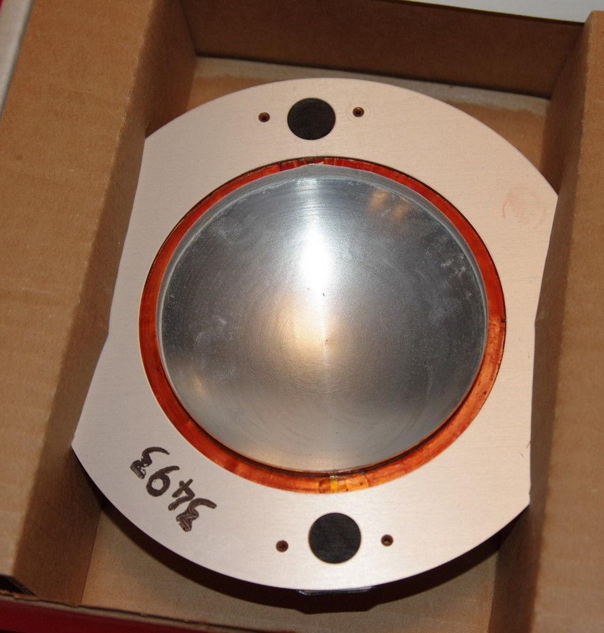

Digging up an old thread -- does anyone know if the diaphragm for SSD3302-8 would fit SSD3301? Renkus Heinz CD3302-8 Diaphragm - Speaker Exchange
I could not find any datasheet for 3302, but it appears that it too is a 2" CD. Thanks!
No, that's a RCF (D)M-82 diaphragm, as used in the RCF N-850, EAW 15410082 and RH CD3302. It's a Titanium diaphragm with Mylar surround.
The diaphragm of the SSD-3301 is made of Aluminum and looks like this:
