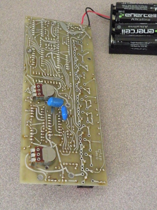

I've gotten my Hafler Iris remote control working again, just too well. It uses what I assume is capacitive sensing to start and stop transmitting the positions of the volume and balance pots. When I touch either knob it correctly changes the volume of my preamp to what the remote's knobs are set to. It just doesn't quit transmitting when I let go. Sometimes it stops after 10-30 seconds. Sometimes I have to take out a battery to stop it.
Now some background. It was tending this way a few years ago, especially during the summer. Finally it went on by itself, ran the batteries down and made them leak. I cleaned up the electrolyte and replaced a corroded IR LED. The battery pack wires had corroded and broke while I was handling it. Things got more complicated when I wired the new battery pack backwards and blew a power diode. I've replaced the diode with one that I guess is equivalent. I guess that the IR LED is equivalent too. I have no idea if any other component is damaged. The other IR LED (there are 2) has a little discoloration on the leads inside the package, but it may be working. Could the IR LEDs be part of the capacitive sensing circuit? That's hard to believe.
There's nothing obvious to adjust the capacitive sensitivity. I now see a spot or two of dried electrolyte that I missed. I'll try to clean it up with some distilled water on a flux brush and dry it quickly. Any other suggestions to troubleshoot this problem? Any other forums that might have experience with this kind of circuit? I've asked around about a schematic, but I'm not sure that it would help me and nobody seems to have one.

Sorry, but I can't find the mechanism for creating an album described in the FAQ, so no photos. I'll just have to tell you that this circuit in no way uses a membrane switch. This has to be a capacitance sensing circuit. The shafts and cases of the volume and balance pots are connected through RC circuits to the inputs of a LM8030N Op-amp transconductance amplifier. I can't figure out any more than that.

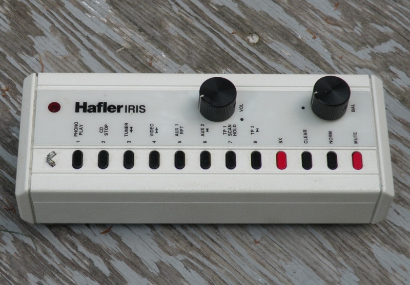

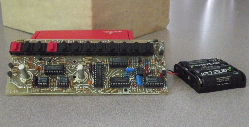

Thanks for the pics... now that is one oddball remote for sure. So we have push buttons for certain functions and true analogue pots for the volume and balance.
I don't think there is any capacitive sensing going on as it seems to detect where the pots are (resistance value) and code that in some way.
Do you position the pots first and then press a "send" button or is it working all the time and you just move the pot and the one on the amp follows suit ? Thats an important question because it eliminate a button and the possibilty of a problem in that area.
Without seeing and getting a feel for this I don't know, but would suggest basic handset repair tatics. I used to see hundreds of remotes in the course of the day job and a favourite tatic was to totally wash the PCB with foam cleaner and a brush and then rinse and dry. As long as there are no "open" parts there isn't a problem but I see you have all those switches. To wet them without knowing their construction could cause a problem. You could do everything else though.

It's not necessary to move the pots to make the remote xmit; just touch the metal knob or the bare shaft or the potentiometer case. Even if I touch any of these with a piece of wire, it xmits. There is definitely a trace from the lock-nut to a cap and then to the op-amp. I am convinced that this is a capacitance sensing circuit.
Thanks for the suggestions. I'm sorry to learn that you don't suggest cleaning the board because of the open switches (& pots). I have already done a careful rinsing of visible corrosion spots with distilled water on a flux brush. I don't think that any got into the open components. Now I'm going over it more aggressively with reagent-grade isopropanol and blowing off the liquid with compressed air. I hope that if any rosin flux gets carried onto contacts I will be able to clean them with Caig Cramolin R-2 spray.

I haven't gone as far as removing the IC's. Maybe I will. This is starting to drive me to distraction. Every evening, as the humidity rises, it starts acting up. Or maybe it's after it has been powered for a few hours. Controlled experiments are difficult to run. Could it be a capacitor getting leaky? It only has some kind of plastic (metalized polyester?) ceramic disc and tantalum.

The small "compressed" ceramic discs are a favourite for leakage. Old tantalums can be a problem to although often its because of the design not observing the working limitations of them. For example the rate of voltage rise time across the cap. That said they do just fail. Small poly caps very unlikely to be leaky.
Has to be worth swapping the caps. You would have to see what the tants are used for. If its as a sample and hold then low leakage is vital and would need like for like replacement. For most other uses I would guess that these days small electrolytics could well meet the needs. No harm in trying them anyway.
The IC's are the least likely suspects but could suffer from any atmospheric film that absorbs moisture... a good wash of the chips would sort that. The sockets could be a problem if you be 100% sure they (and the PCB) are clean underneath.
