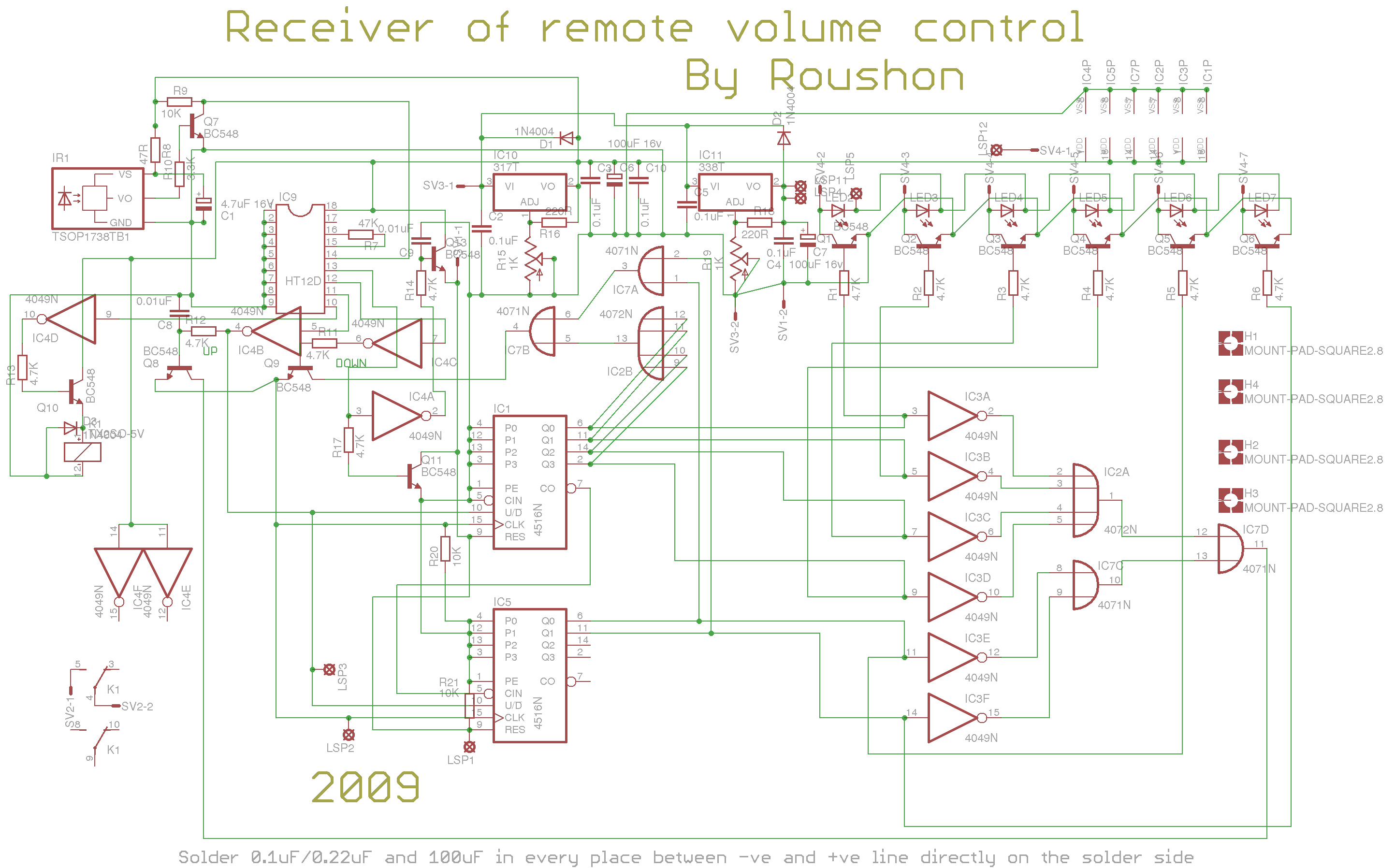

Think about it. What is the chance that a random spike causes exactly the right code to be output from the receiver/decoder?
The overwhelming possibility is that a spike causes your control systen *after* the receiver/decoder to react. Whether it has anything to do with the power supply is just a wild guess. (You can search for your keys under the streetlamp because there's light there, but if you lost them in another place it's pretty useless ).
So we really need a schematic to say anything intelligent about this.
jan didden
jan didden

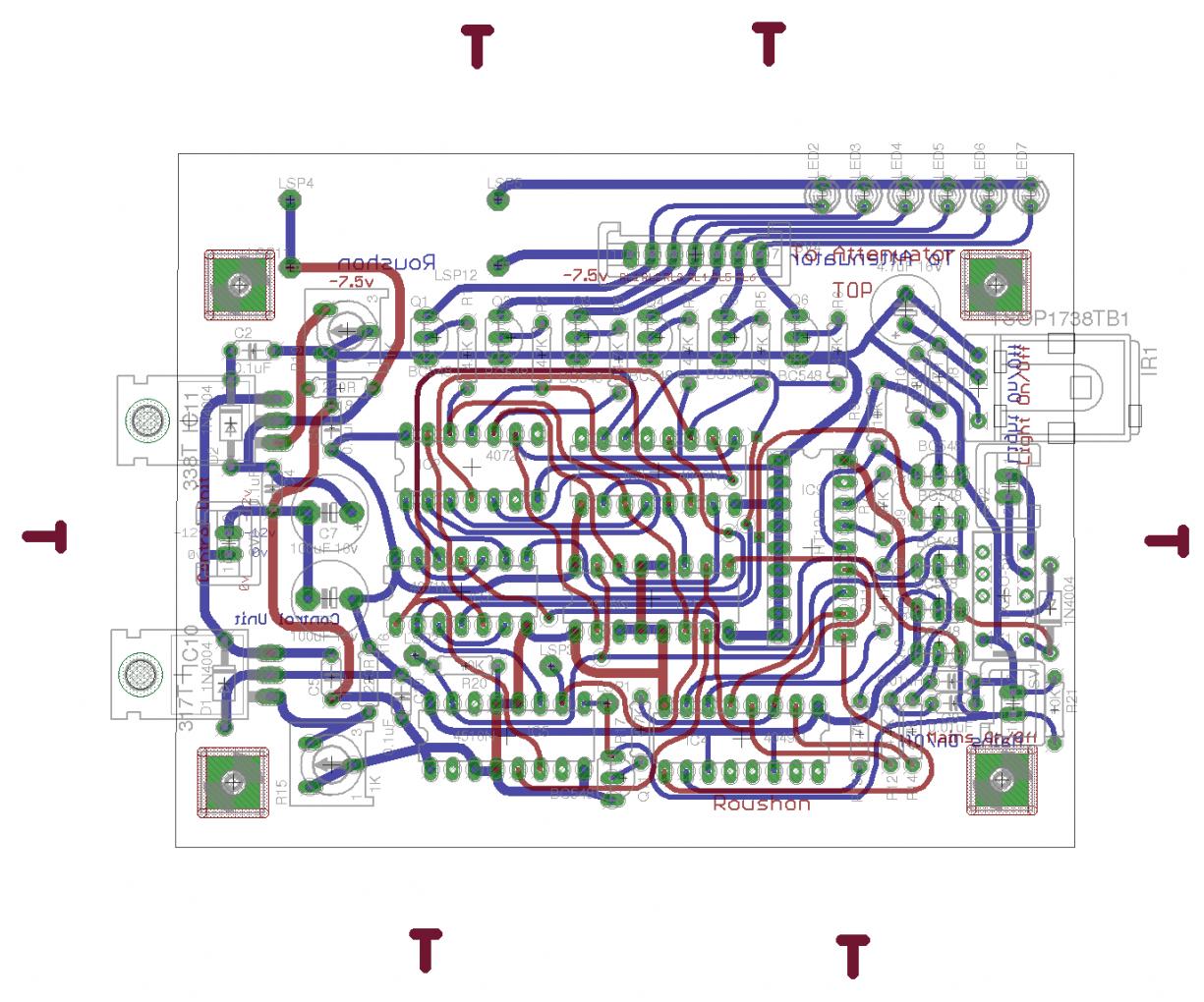

Hi Janneman,
Sorry for the weekend break! We know that the problem is with the
circuitry after the decoder. That is what we are trying to solve. There are several
logic circuits involved and the wiring in the amp cabinet is also under consideration.
The main receiver/decoder and the relay driver circuit is attached with its pcb design.
(The drawing is not very clean as I was only interested in making the pcb)
The circuit works very well except the occasional interference as I described above.
There is a recent modification to the attached circuit. I am not describing it in great
details as the problem was there before and after this modification.
Thanks and regards
Roushon.

EMC is the problem.
Adding decoupling caps to each IC's gonna help.
I would try and lay it out with as much ground as possible, a ground plane would be best, but if not well gridded and power connections, ground being the critical one. I would por ground copper round everything and stich it togethyer with vias.
Both fans and flourecent tubes are a source of noise and spikes tah can cause all sorts of problems with circuits.
