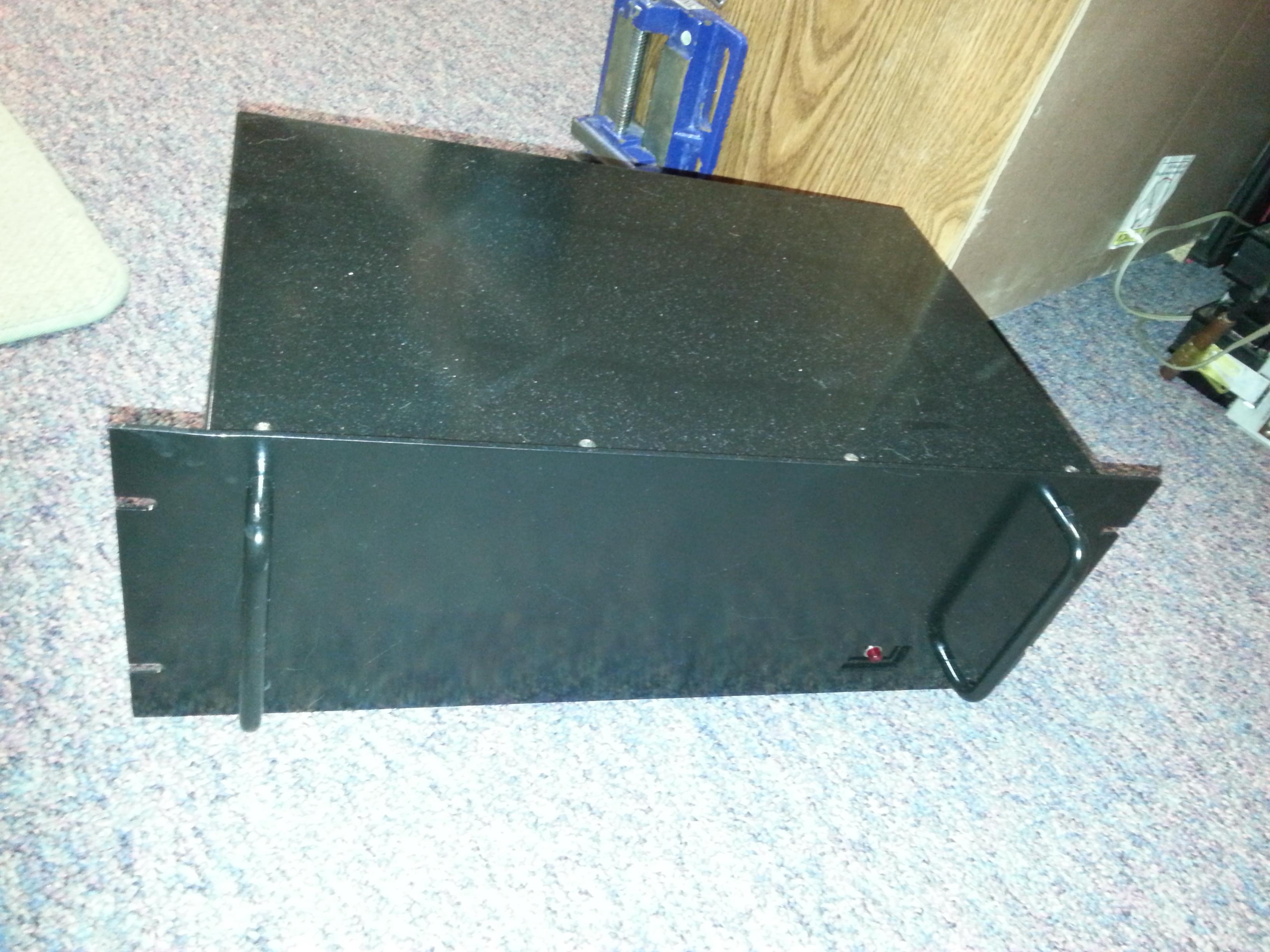

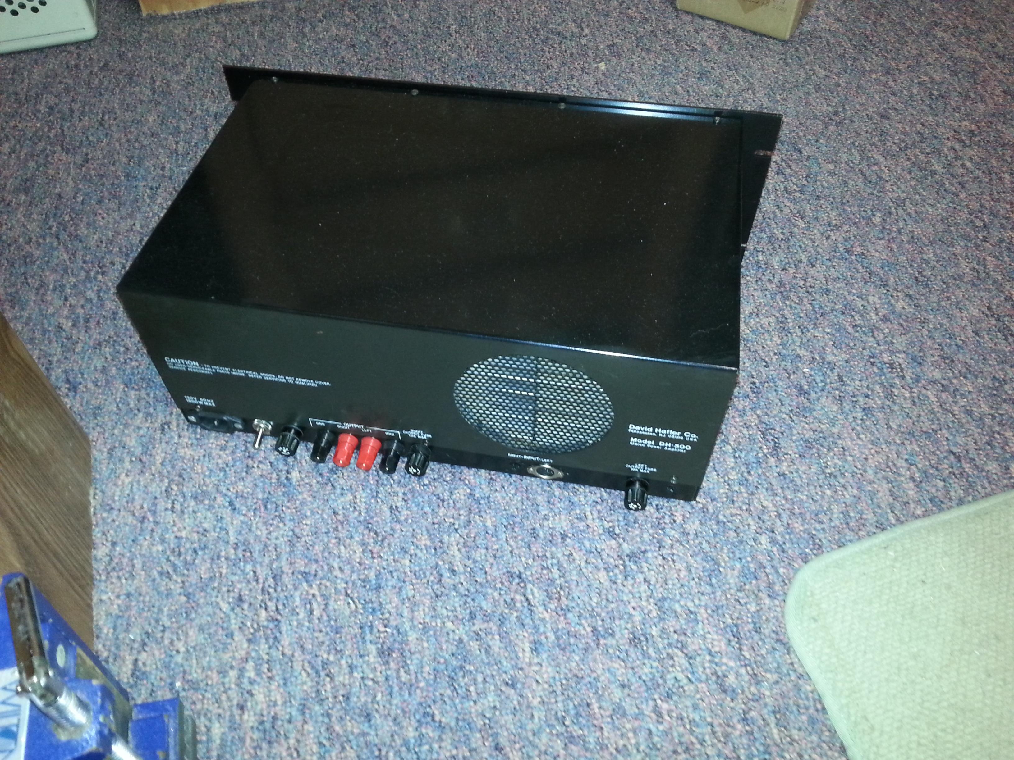

Stuart, just noticed your output stage power supply. 113kuf -- per channel?!. Nice! :)
Pretty close. Actually it's hard to see, but there are 15 x 4700uF caps per rail, three on the bottom board with 10uF PP and 0.47uF PP bypass caps. So, 70.5kuF per rail, 141kuF total.
Guess it's a hair shirt approach.......
Also, the rectifier bridge is a Schottky deal.
The power switches on both of my units failed (while stock), so new, rear panel HD toggle switches have been installed and indicator lamps put on the front panel where the switches were.
IEC connectors for easy power cord changeouts.
Stuart

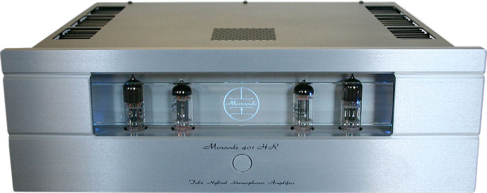

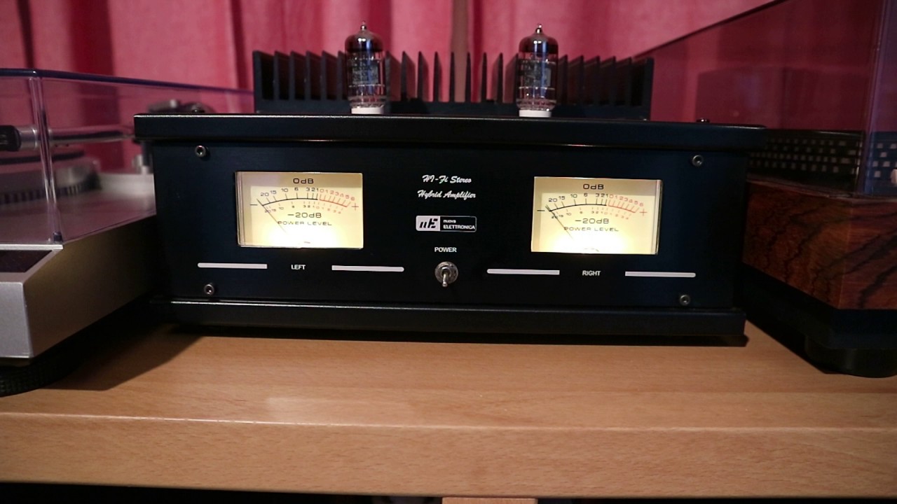

I seek a casing idea for mine all plate hybrid. where the valve is on front outside the case.
someone ideas?
Idea like pic 2 cooling plate mosfets behind the tubes. stainless steel casing? high shining.
The case do housing 4 tubes for stereo, or a mono blok who has two.
This design sounds very good, much better as the others I have, new idea no feedback on tubes, therefore the use of the 6C19 who has mu of two and high current and low impedance.

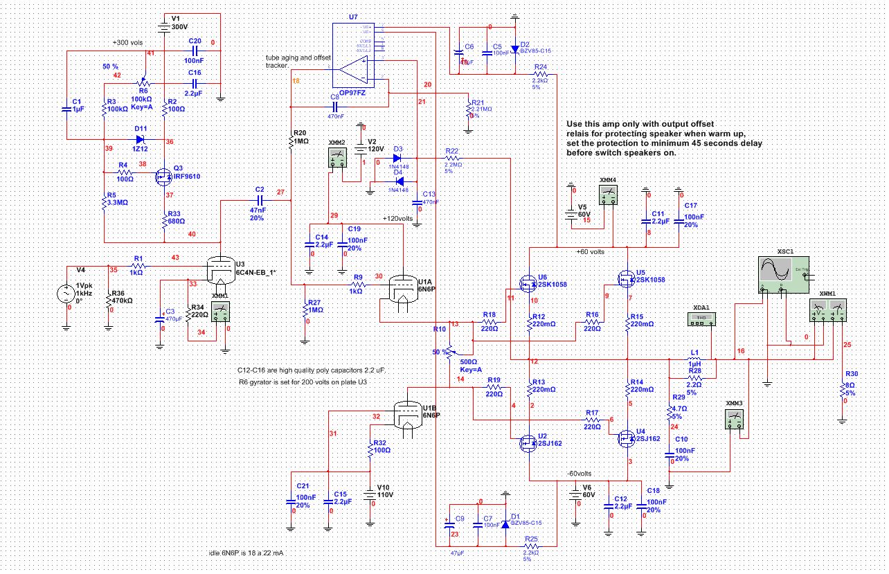

more on the Lazarus H-1
Here's the reverse-engineered schematic on the H1A - originally designed (apparently) by Allen Wright. I have a 1A and a 1 that I modified to the A. Amps sound VERY good - first drove quad 63's (best I used); now my LS50's / subwoofer combination.
Particularly like the inclusion of a servo which really seems to work well - now only need to have one control to set the bias. Also like the simplicity of the input circuit. Did simplify the upper grid biasing circuit to a DN2540 cc source feeding the 62V zener - one for each channel. Been working fine for ~20 years!
Charles
O yeah - did add two muffin fans (240V in series) - fit to /right underneath the top
  • Lazarus H1A.pdf
I have a hybrid amp now for over 15 years, no defect, did design this myself, but in fact it was already designed as 90 procent of audio amps are a wheel already invented multiply times.
Thsi does nice, dv coupled tubes, controlled by a servo for correct tube temperature drift, and a speaker protection who is set on a longer on time because of dc on speakers while warm up, it is not much but still some volts.
I have this not yet on LTspice.
regards
