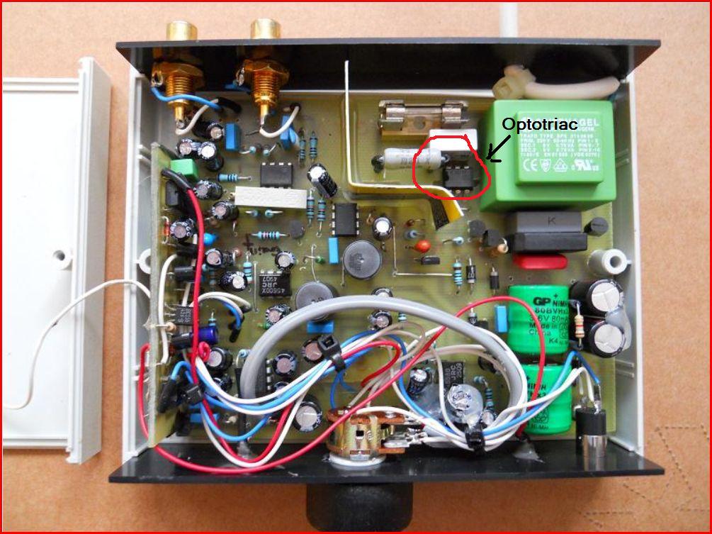

What about using the MOC3061. This will power up the amplifier clean since it is start at zero crossing of the AC. Attached it is the technical data. Also you can use a zero crossing relay Omron G3NE-220T-US. I found it no too long ago I am planning to using it in my new design.
Very useful devices are the opto-triacs. I used one to directly power a (small) transformer. Works brilliantly. Power is applied when audio is present and has a 5 minute switch off timer when audio finishes.
On the subject of zero crossing switching. Switching a large toroid at the zero point can actually be the worst condition for generating a large inrush current. How large depends on how much residual magnetism is left in the core (which depends on where in the cycle it was switched off). It's better to apply power at the peak of the mains cycle... which goes against initial logic.
I believe once large reservoir caps are added into the equation all that goes out of the window though, and the inrush current is large whatever point in the cycle the transformer is switched. Haven't seen much info on that anywhere.

It seems that a simple relay is the go. If I was to use a relay. Nice notes on the zero crossover problems, until i read that article i was contemplating using one. I have been reading about triacs they do seem to be a bit noisy unfortunately.
