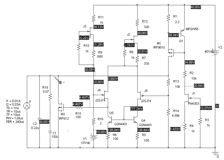

I've been messing around with simulations in preparation for breadboarding a regualtor for use with my "All American" RIAA preamp for MM cartridge (see thread in analogue). Attached is a schematic.

Attached is a simulated response to the load step shown in the schematic. What I want to know is, how are other high-speed regualtors(Sulzer, Jung) with a similar load step?
This is quite high performance. The change of just 1.5mV at a step response of 20 mA (25mohm) is good, with a step that has 100nS rise- and fall times. A Jung goes down to a few milliohms at 20kHz, IF you do remote sensing (the wire/pcb track to the load will have more than a few mohms).
What would probably be more relevant to audio is the response to a step with say 10uSec rise- and fall times, or the PSRR with a 20kHz load.
Jan Didden

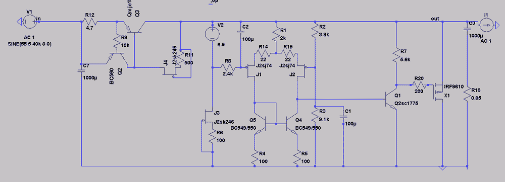

Hi wrenchone,
both nice design and interesting topic! Even more because I'm experimenting on a similar field at the moment. My second task is to compare a diff-amp reg as yours with an open loop 'regulator' both specwise and sonically, for intended lineamp and phonoamp use.
If someone could give some advice how I can perform your step response sim in LTSPice, I could repeat it for my circuits even with the same frame parameters. Is it just to connect a pulsed voltage source to the regulated line and watch Vout?
But first, I have a few questions regarding your design.
1) EDIT: <saw my mistake>
2) How is the voltage reference (R16/V1) made in the real circuit? I've found the actual implementation of the reference will 'top or flop' a regulators performance.
3) Both a cap across the v-ref (better still: R-C- filter) as well as R13 will seriously improve the overall performance, at least regarding noise and output impedance.
Is the impedance between both diff-pair inputs matched? The R of the mentioned R-C filter might provide help, if not.
4) I've seen somewhere elaborated (when memory serves me well on Rod Elliott's pages) that you don't gain advantages by using a CCS in a diff-par tail when using a current mirror. What is your reasoning for still using that CSS?
5) What is the purpose of R2?
For reference, *not* for dragging the thread OT, here is one of the circuits I'm trying at the moment and we could compare. V2 is a LM329DZ. I have an open loop shunt in the pipeline which I could post as well once I build it in reality.
EDIT: replacing Q1 with a mosfet betters performance about 20kHz throughout the bandwith, at least in sim. I'll try that out as well!

Onvinyl -
I have several choices for Vref - a TL431 with resistor network, a reverse biased base-emitter junction as zener, or a stack of 4-5 green GaP LEDs. I'll probably use a big cap across the reference in any case as it slows up the output rate of rise at turn-on to reduce thumps.
The current source on the diff pair tail pins the bias current, even if it isn't strictly needed for comon mode rejection.
R2 reduces power dissipation in the JFET below it.
I may try replacing the bipolar diff pair with a couple of JFETs to allow more latitude in an RC filter for the reference. In that case , I may add sanother stage for more gain (depends on simulation results).

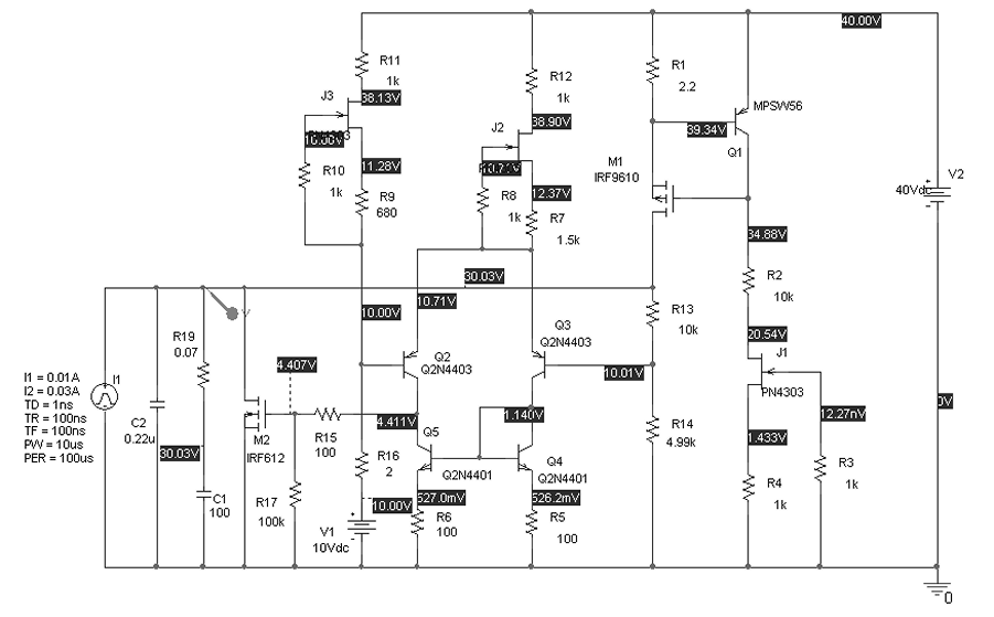

Here is the same regulator with some nice jfets in the diff amp. Tail current was boosted to cater to the fet characteristics. I tried putting a current source loaded emitter follower between the diff stage and the output fet, but that made the simulation really weird and granular, even when the reltol was upped by a factor of 10. I went back to plain vanilla.

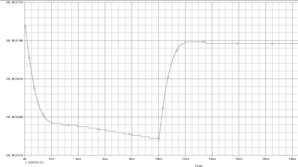

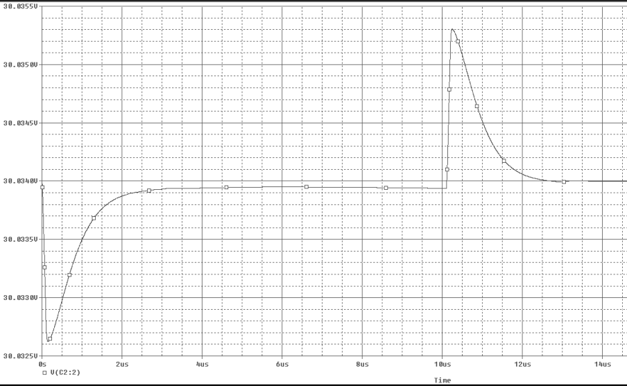

This is the output response with attack and decay times slowed down to 10 usec each. The plot shown is just for the attack. The next thing I might try is to add some gain to the output sink stage with a P-channel mosfet or PNP booster. Some global feedback (compensation) would also be interesting to try.

I had to download LT Spice to have a look, but what you do is right click on the current source, use advanced settings, and configure it as a pulsed current source. That's what I'm doing in PSpice, it's just that the pulsed current source is explicitly available in the sources menu without having to dig for it.
I don't think that referencing the current sources to the output will make any difference in the response, but the reference and tail currents will be a little quieter in practice. I'm going to do a some more messing around with sims, but I think soon I'll be ready to spin a prototype.
One more note in passing - the current source on the diff pair tail is still needed for line rejection. It's true that the current mirror will tend to force equality in the pair currents, but unfortunately, the signal output from the diff pair is single ended, and any twitch in the tail current will appear at the output.

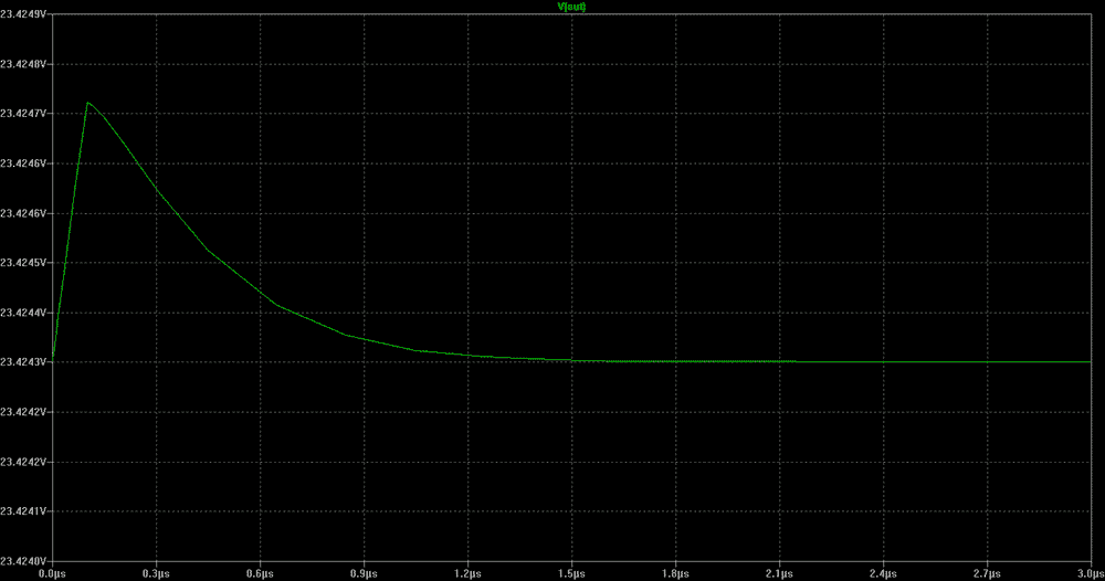

Hi wrenchone,
originally, I was looking for an explanation, why the simmed performance was the same both for CCS and resistor in the tail. I might have chosen the wrong tests, though.
attached is the response for the shown circuit. The pulsed CS (I1) sat at the output of the circuit.
rise and fall time are 100ns, stepsize is 20mA.
It is not very pretty :whazzat:
The effiency of the reg at 10Mhz is -53dB
Rüdiger

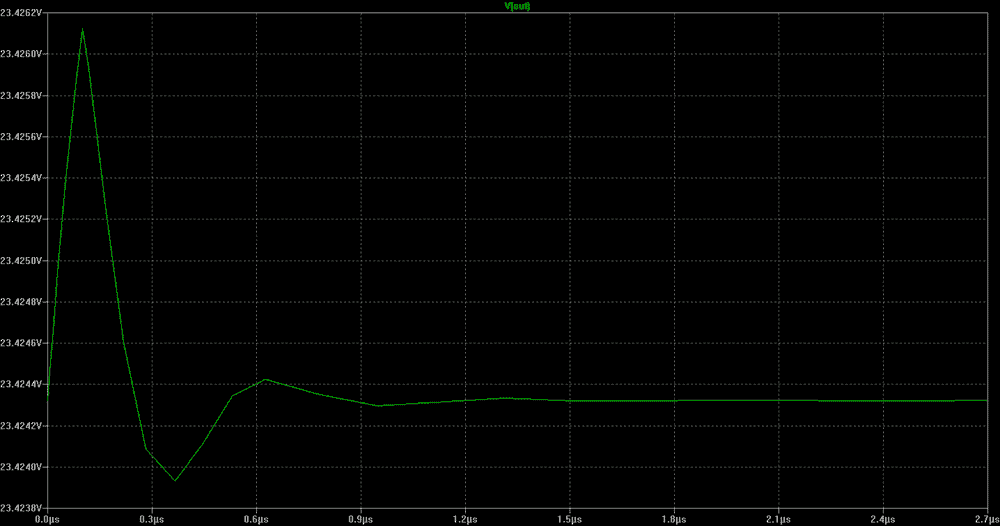

I saw that the response is superimposed by the ESR you allow for the output cap.
My last post was with 0.05 Ohm, with 0.01 things look considerably better. Now, what ESR is reasonable or achievable with paralleling smaller caps?
Rüdiger
EDIT: other screenshot
