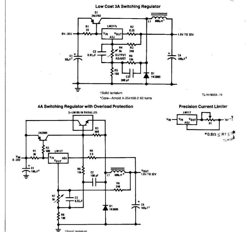

In many old National Power Databooks you can find step-down switching regulators using linear ICs like LM317/337.
blmn,
I know that but as i said earlier those are lenear regulators, I am planning for SMPS type regulator, for higher efficiency & lower Heating + Smaller Heatsink requirement.

I think you misread him. Those supplies blmn mentioned ARE SMPS, but they use linear chips (317) as the switching elements. Those supplies have all the advantages (and disadvantages, of course) of SMPS.

Under tons of dust I found something that might be interesting.
See below two of these circuits.
