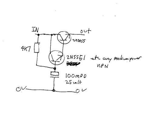

Did you try to connect only one channel and see if it still hum, as Nordic suggested?
Two PSU's indeed - two totally independant channels...
I did try a single channel but unfortunately hum still features.
Also connected the transistor B-E as zener but no noticable difference...
D
Hi GD,
When you dangled the B-E junction over the 100mfd cap in the multiplier did you re - read the voltage at the amps themselves. It should have dropped to around 7 or 8 volts. This would "prove" it was working OK as a zener. It would prove a lot as to whether it really is a PSU ripple issue ! You ask about overvoltage. That in itself will not affect the hum. I am a little suprised it made no change at all, I think we could do with making sure the multiplier is working correctly. If you disconnect the 4.7 K resistor the voltage to the amps should drop to zero. Could you try that as well. Something does not sound quite right here.

Whoa-hey!! What did I tell you??
All the amplifiers needed were a simple regulator.
The sound, using the mains transformer, is now breathtakingly brilliant. Dead quiet background - ZERO hum or buzz.
I am using a 1A, 7812CT regulator with a 400mfd cap on output. Works like a charm!
D

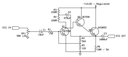

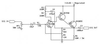

keantoken said:Hmm. I appear to have missed something!
Is the end result different enough to post a schematic? I must have a schematic of everything that sounds good...
- keantoken
Hi Kean
I'll draw up a detailled schematic of the stereo amp including the regulator circuit and mail it to you.
Drop me a mail at: dewald (AT) greenlizard (dot) co.za
I would also then be honoured if you can build the amp and tell me what you think of the sound.
Dewald

Mooly said:Hi,
Now something like that does need clean supplies
Are you after building a few different RIAA amps to compare.
No... just one very good one that I can use every day. The EAR 834P that I am cuurently using is on loan from a friend. (think I might clone it... he-he!)
D
