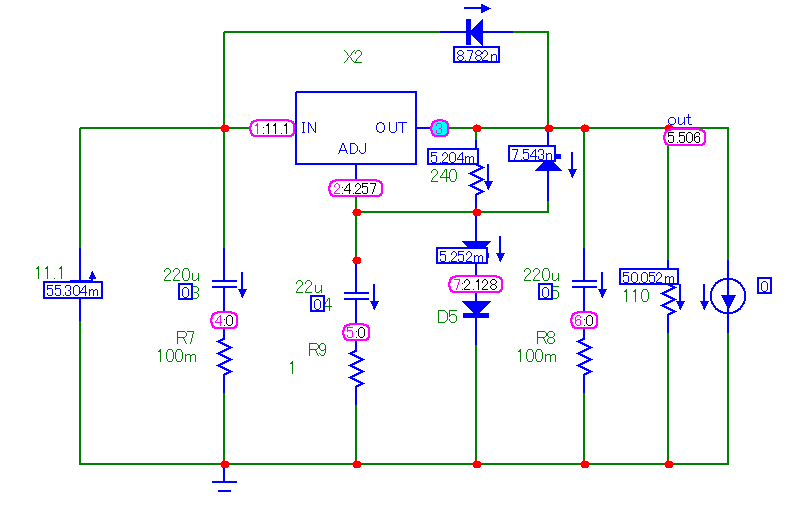

Two circuits for discussion
Hello,
Please forgive me to reopen this old thread.
I'm looking for the best yet simple regulator to feed a TDA1543 @ around 5.2V
I'm looking for low Impedance, Low noise, low cost
The voltage source is a 3S LiPo Battery Pack 11.1V.
Here are two designs, one serie using the venerable LT317 as Voltage Serie Regulator and one using a discreet Shunt regulator along with their respective Zout.
Please could you comment on which one would you pick and why or eventually propose an other option taking into acount the cost issue.

Since TDA1543 is a dual 16-bit DAC, I think your decision to use a linear regulator is appropriate. You don't want high frequency SMPS artifacts on the supplies of your DAC.
I recommend choosing the shunt regulator topology, but with two changes: (i) use a TO220 packaged device for the PNP shunt transistor Q2, so you can get the heat out. (ii) size the two 45R input resistors for the worst case scenario: battery is 99% discharged AND the DAC is drawing its maximum possible current, driving two full amplitude 20 kHz sinewaves.
to save on battery power I suggest you consider a switching Buck regulator.
This is a good idea, but also consider a SEPIC topology which can be work with equal input and output voltage, and is capacitively isolated from input power lines, so no risk of input to output short circuit (Except a bad cap). Any sim`ple driver as UCC3804 will perform excellent, and using coupled inductors ripple is very little at input and outputs lines.
For battery operation I would recommend a series regulator. The shunt regulator will draw the rated current all the time.

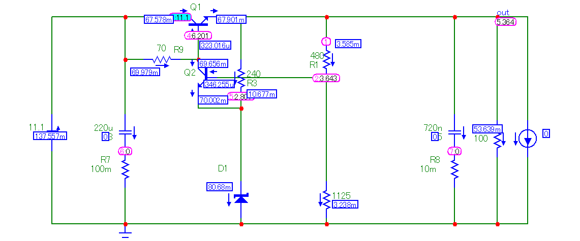

No. Series elements and shunt elements are equally 'in the signal path'.mszerg said:My guess of the main difference between shunt vs series regulator is that shunt is not on the signal path (assuming its path starts from PSU), while in case of series you always have +1 component on the signal path.
Good point. However, as the TDA1543 is fussy about resistor values vs supply rail voltage (at least when used for resistor I/V in a typical NOS DAC) you don't want the voltage changing too much.SamAnytime said:Note that a slow drift in the power rail, while difficult to filter, is also difficult to hear.

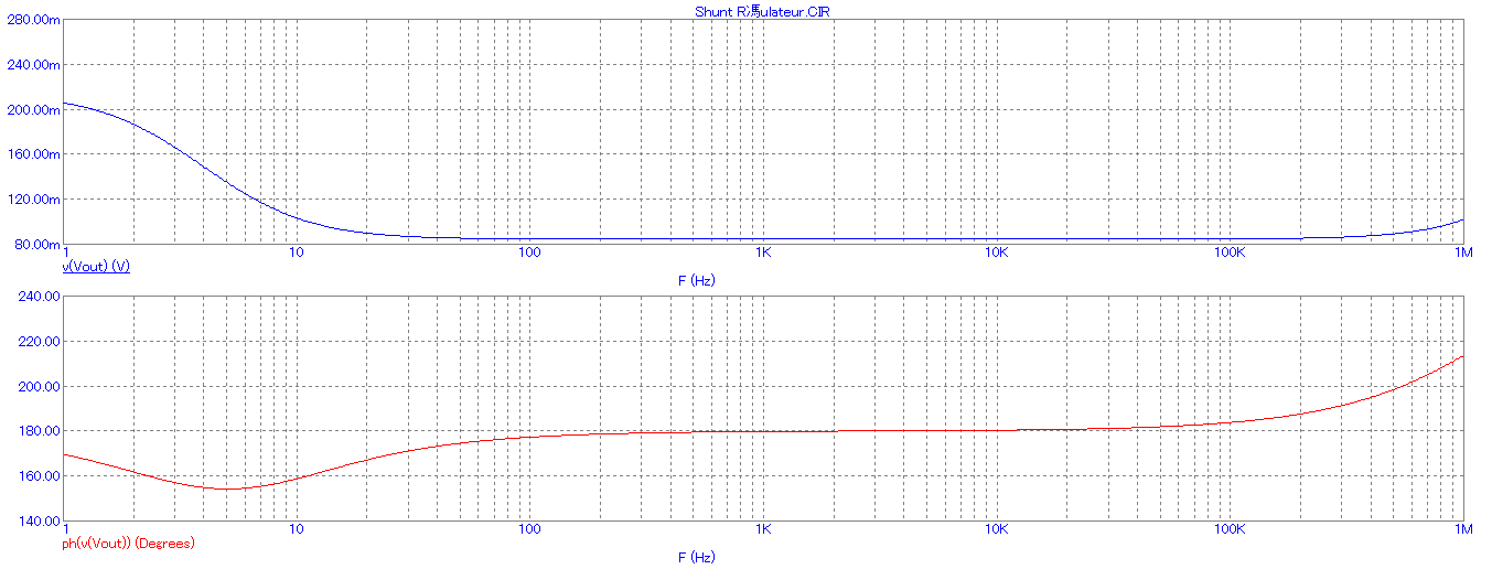

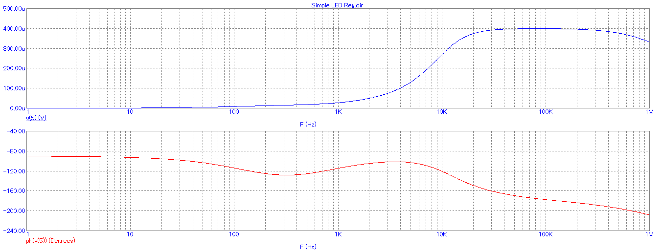

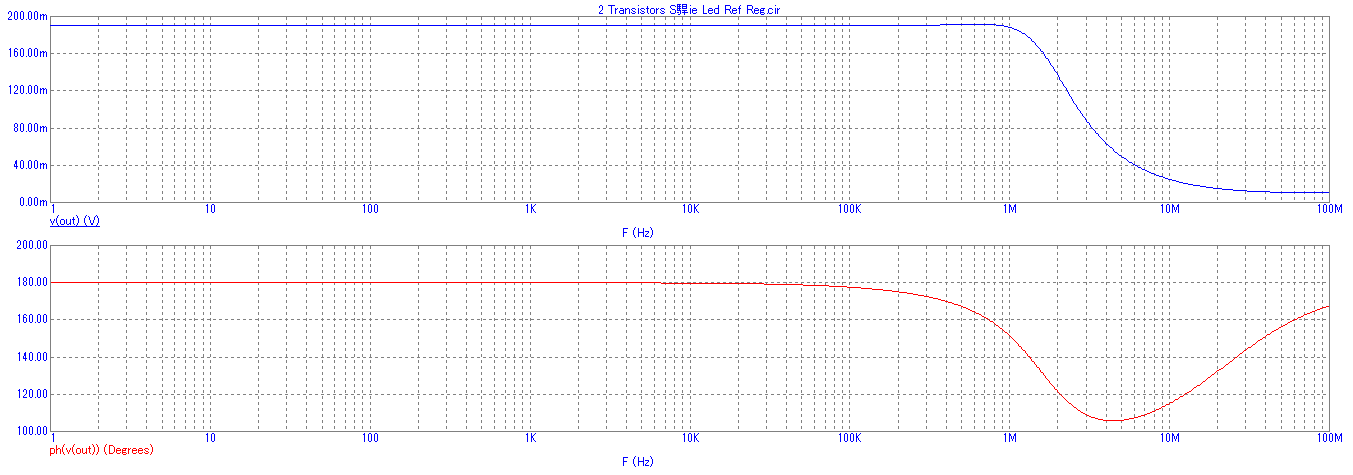

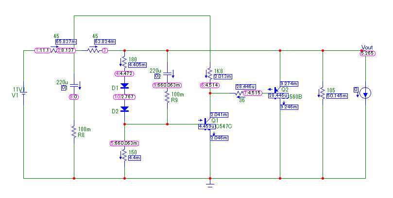

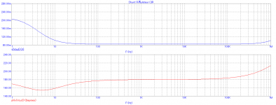

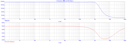

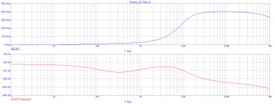

Let me propose a third schematic, a very simple discrete Serie to compare with The LT317 Serie and the Discrete Shunt.
It is the one that draws the most current, and has the highest output impedance at 0.18 Ohm. Possibly, also it is noisier ?
What do you think ?
At first, I didn't want to use switching Reg, as I fear that It will not sound as good although I could filter with a gyrator.
What do you think ?

SamAnytime, Don't you think that the DAC will always draw around 50 mA as per the data sheet ?For battery operation I would recommend a series regulator. The shunt regulator will draw the rated current all the time.
So here, the current draw will allways be about the same whatever the regulator type.
Agreed...If it has an "error amplifier" it's in the signal path.
If the error amplifier is not low THD, distortion artifacts appear on the supply rails.
Taking into acount large current variation if I'm not using Pre DC-DC regulation, I have banned the shunt.
So, taking cost and space into consideration, the options, for the complete system are now :

Back to the serie regulator.
Does it make sense to replace the 2 green diodes at the Adj pin of the LT317
with a 4.096 V voltage reference LM4040A41IDBZT @ 2,53€.
The Dynamic impedance should again improve vs 2 leds
BUT What about noise ?
There is also the MAX6126A41+
Here, Noise should also improve but price is high @ 5,29€
Any audible improvement ?
