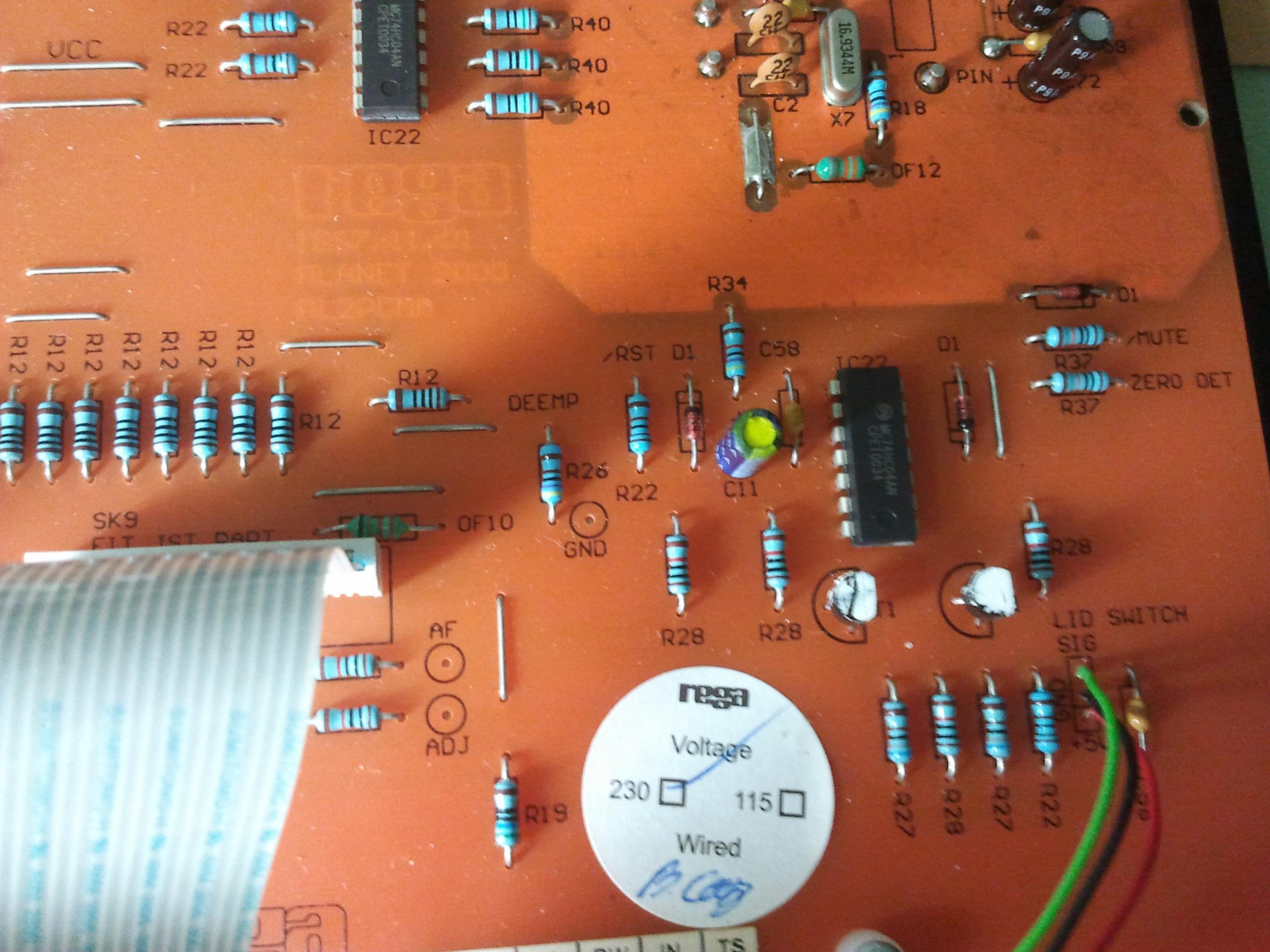

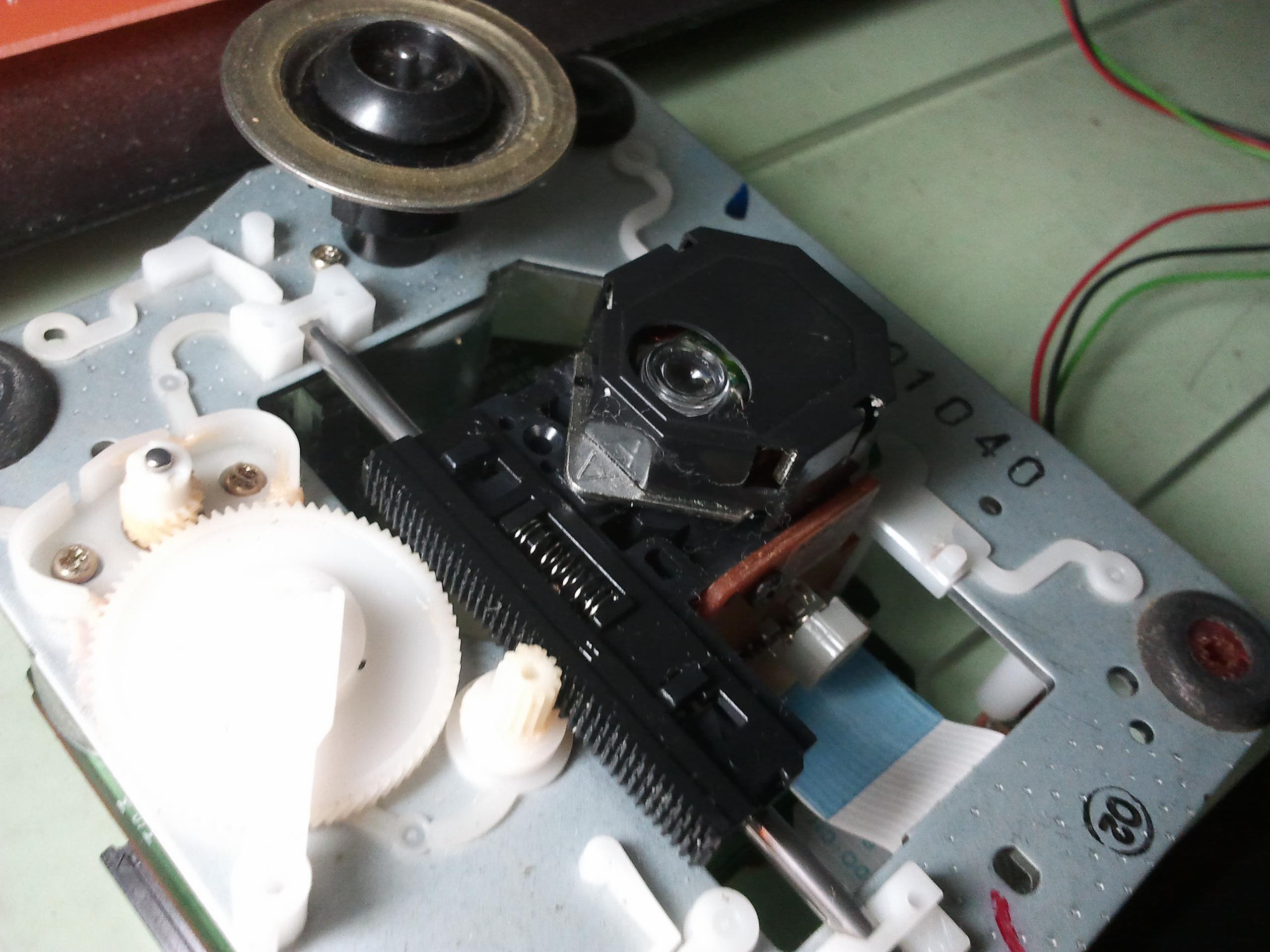

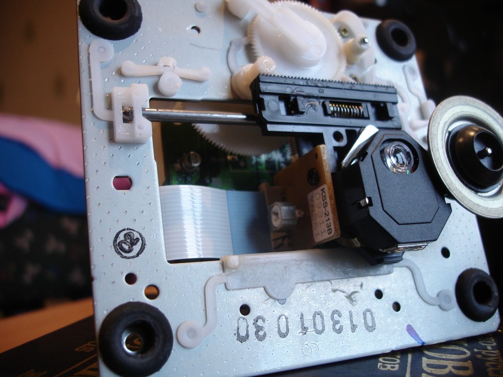

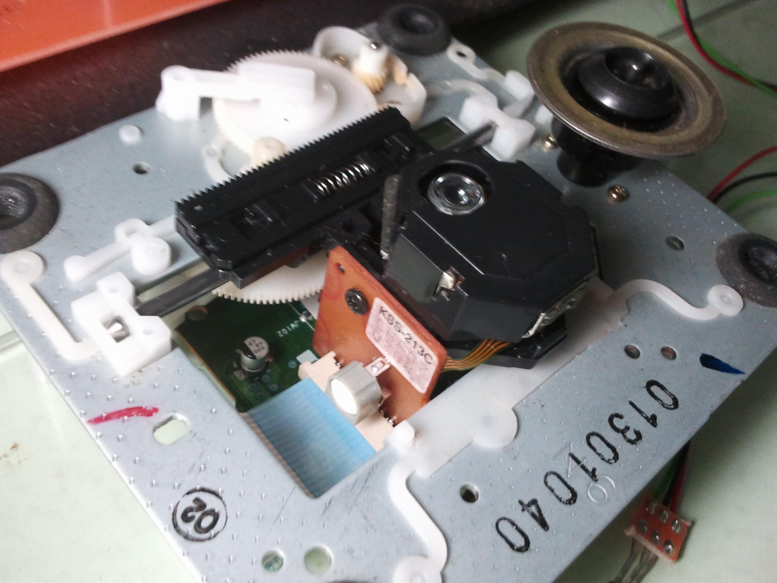

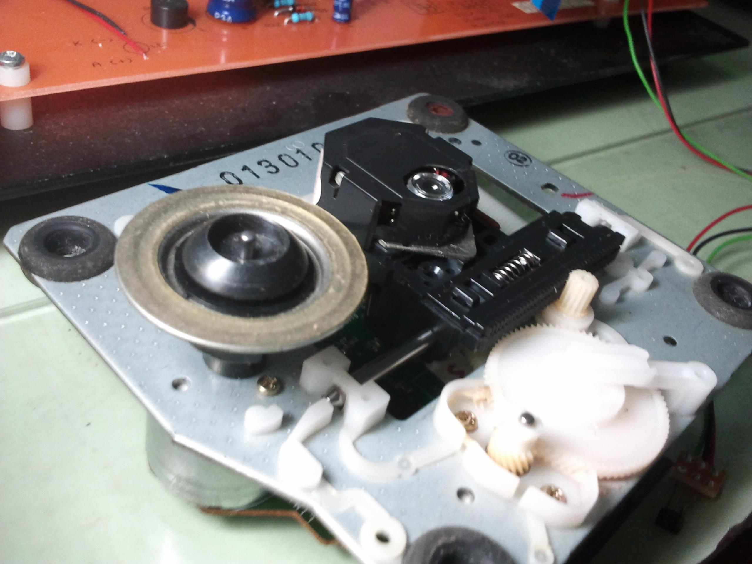

My Rega planet 2000 has not been working for quite some time and recently I changed the pick-up to the sony kss 213c. I have also changed the 4 units of 1n4003 to 1n4004 as mentioned in post 5 of http://www.diyaudio.com/forums/digital-source/128300-rega-planet-power-out.html.
The problem remains and this is the problem:
1) The player does spin the cd when a cd is put into the tray and the lid closed. The front panel instruction reads "no disc' when I push the play button.
I have sent it out for repair before this and the repairman said there was nothing wrong with the motor but he wouldn't figured out what was wrong. Does anyone know of this problem?

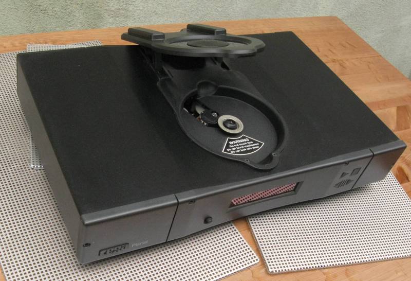

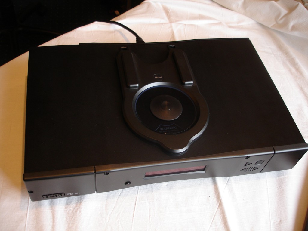

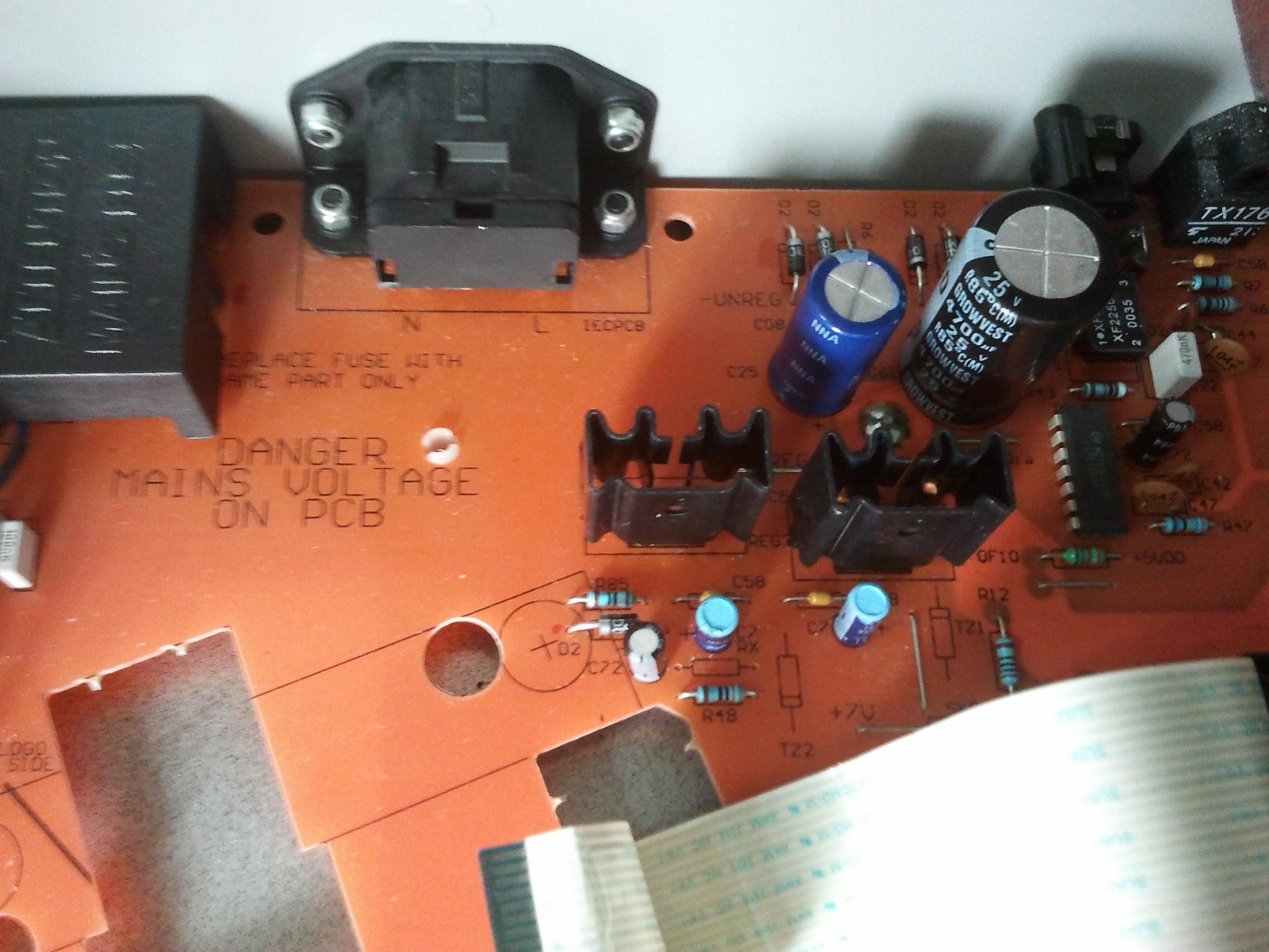

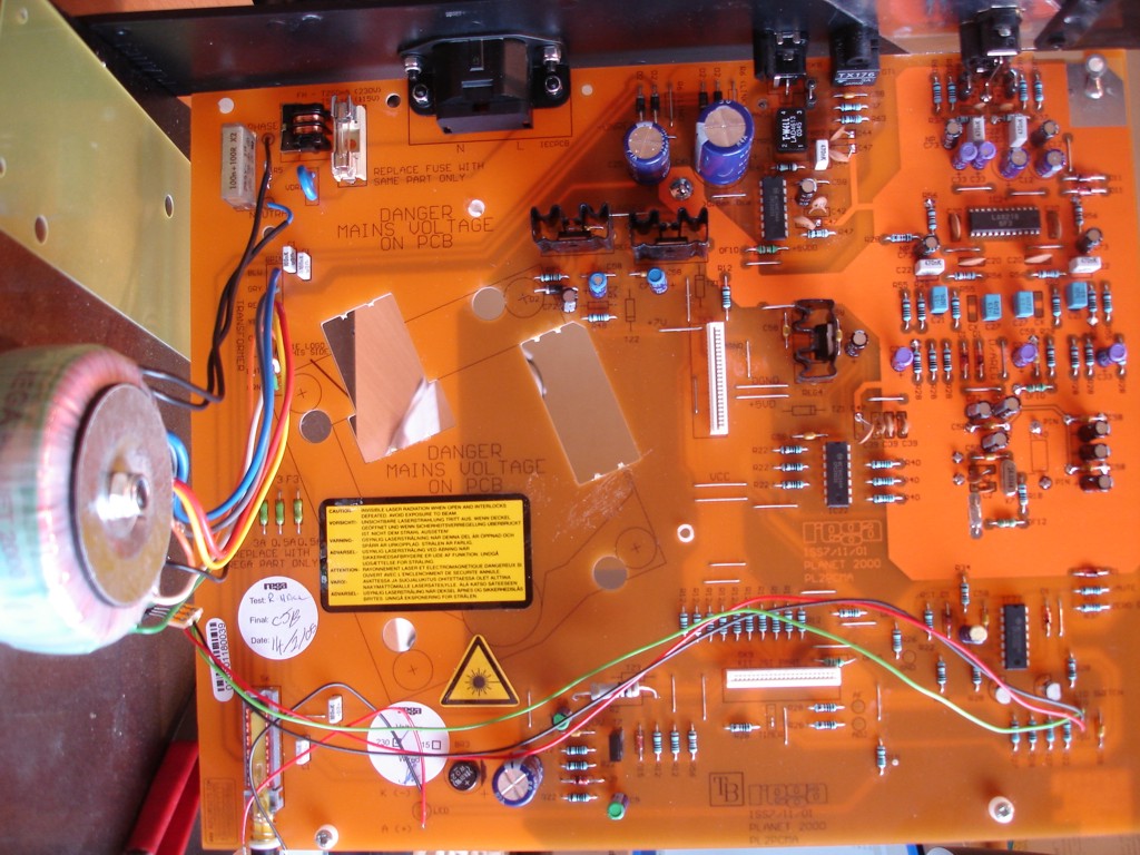

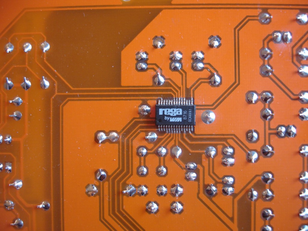

I don't understand this term:
"when a cd is put into the tray"
As I know, the Rega Planet is a top loader without a tray, so you must close the lid with your hand to get the same funktion than by usual cd players with trays and "Tray-In" resp. "Tray-closed" mode.
So I assume, you mean "when a cd is put on the turntable (pulley) of the spindle motor"

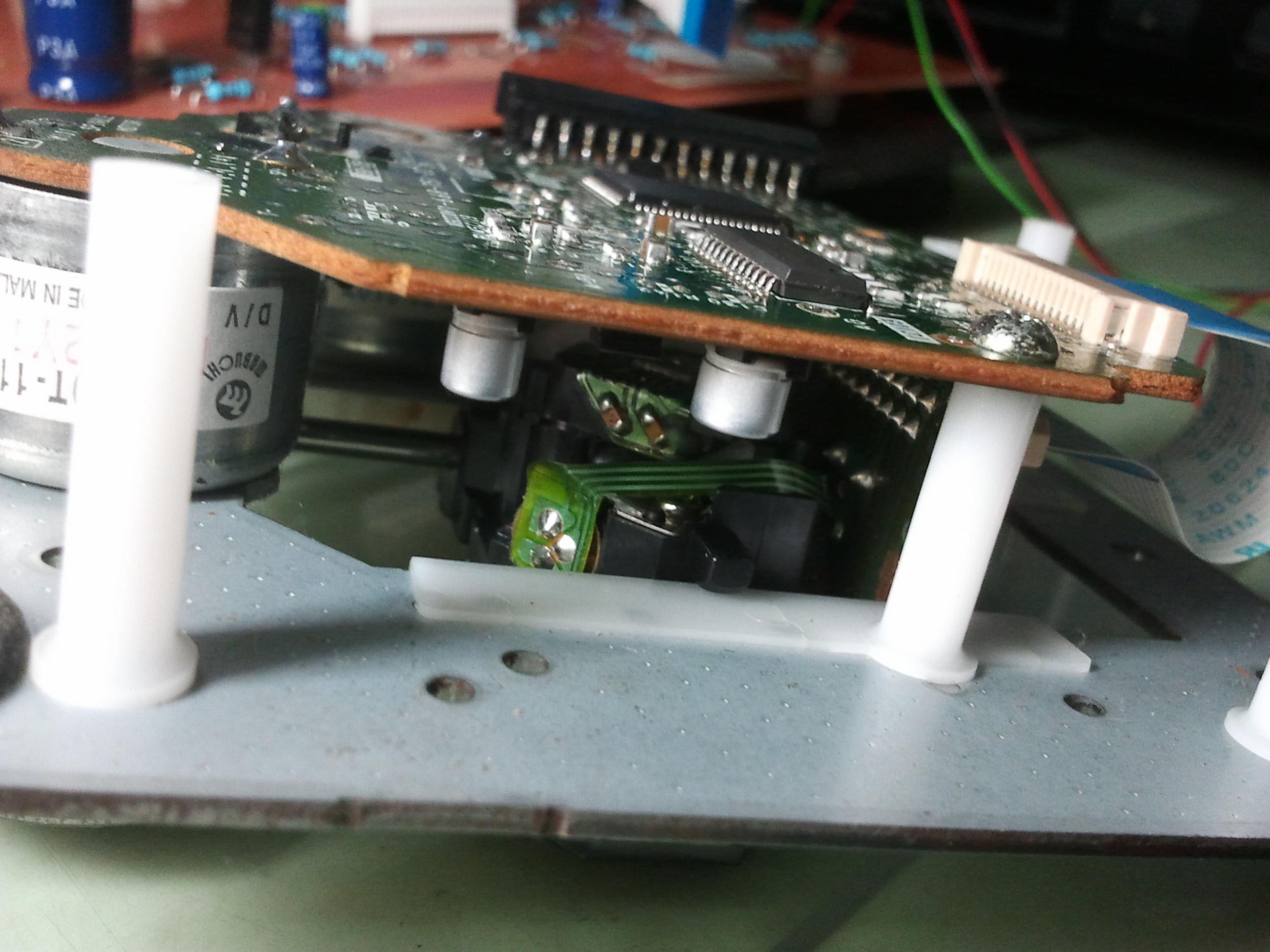

Because the player does spin the cd for read-in try for the TOC, laser light is present and the FOK signal goes out to the MCU.
Now the question is follow:
How looks the RF signal while the CD does rotate?

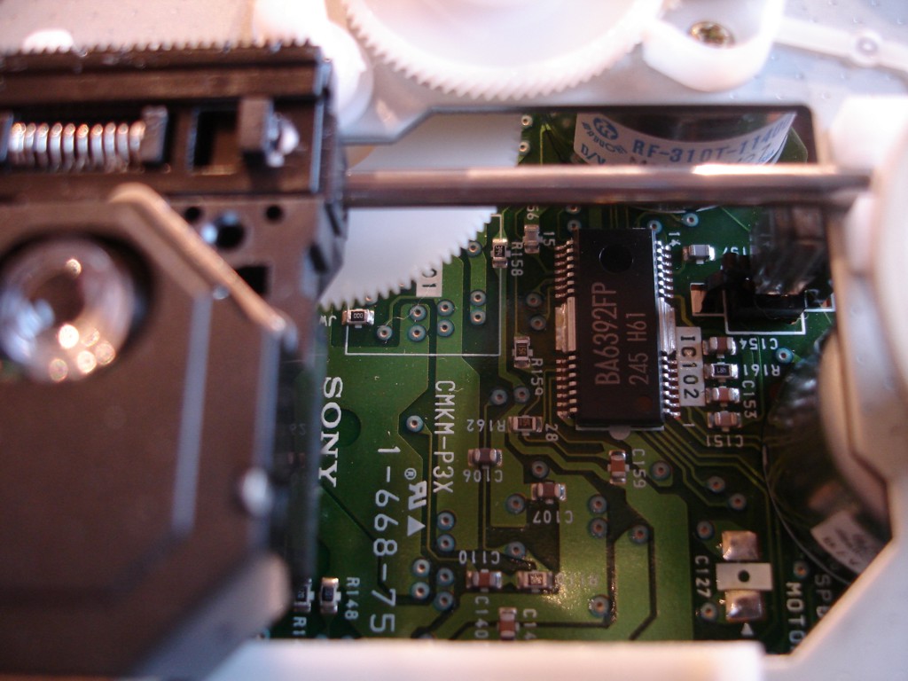

Try to get datasheets of the RF-IC, the PCM-decoder (perhaps CXD2500Q) so as the servo processor (all placed on the integrated PCB of mechanism KSM213CCM successor) for finding the appropriate checkpoint "RFO" resp. "RF-out"
Check also the flex connector (white flat ribbon cable) from main PCB to mechanism so as the data bus signals of the Subcode datas to the MCU.
The best solution is a second player of the same model for exchange all the devices for clearly isolating the error causing devices so as the compare of the measuring results while rotating of the compact disc. If the optical pickup is new, the most likely reason is the flex connector and the PCM decoder PCB inside of the mechanism.

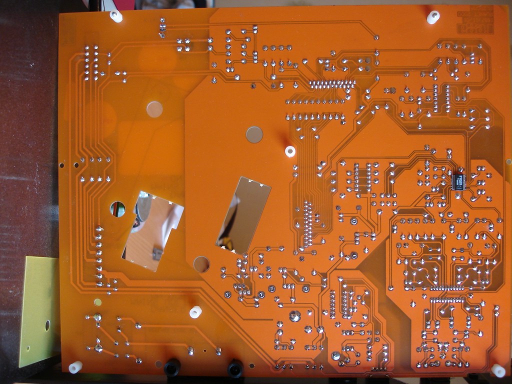

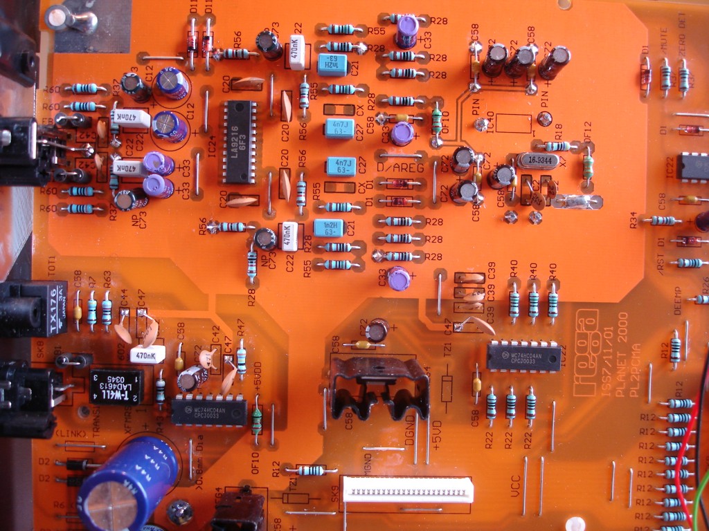

I have change the LM317t, all the L7805cv, all mc74hc an to hd74hc04p, change the bd140, the two BC546 except the LA9216. I couldn't find the LA9216 or its' alternative. The cd still doesn't spin.

Actually follow things must happen (to find of various flow charts by service manuals):
1) laser light goes on (controlled by the APC circuit, mostly integrated on the RF-amplifier IC).
2) laser lens goes up and down several times at the same time (to create the FOK signal).
If one of this both things troubled, the disk don't start to rotate.

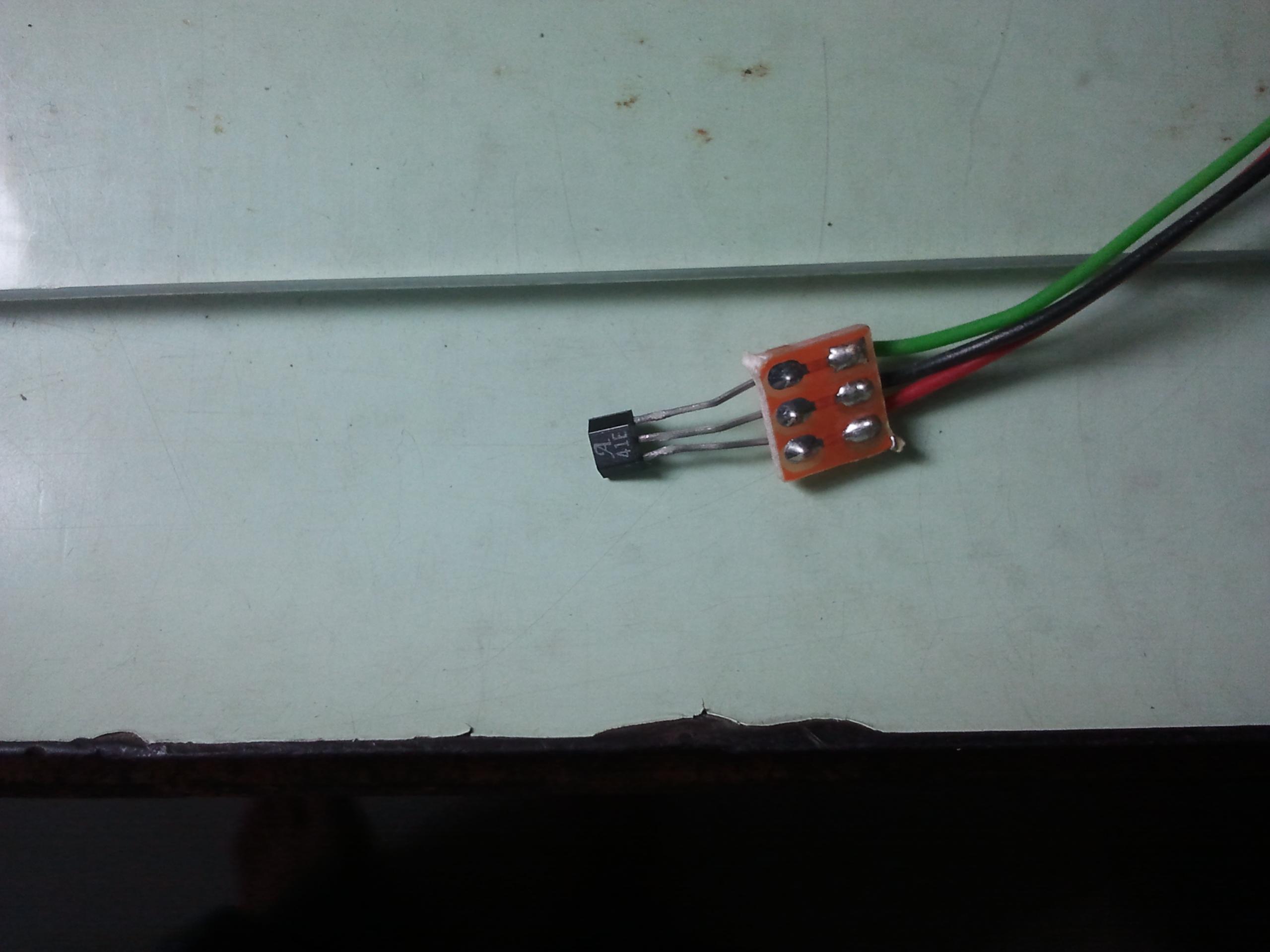

To check this carefully, remove the lid resp. the completly cover and use the swich separately, that is coupled with the lid.

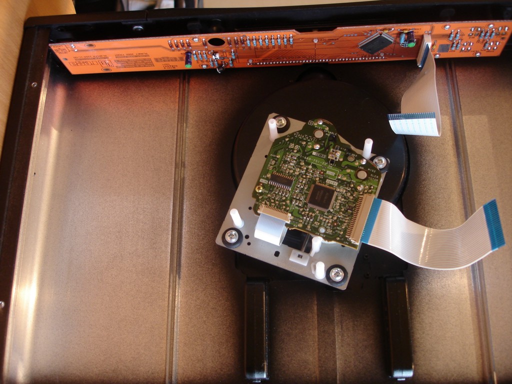

What about the connection quality of the ribbon cables (see image number 4) ??

3)What about the connection quality of the ribbon cables (see image number 4) ??
1) Nothing happens when the lid is closed.
2) As answer above (1).
3) The ribbon cable is new as I replaced the old one.
The front panel display reads 'no disc' when I pressed the play button. If I do not pressed any of the buttons, it will still display 'no disc' after several seconds.
Thanks.
If the lens doesn't goes up and down, the focus buffer amp and/or the focus servo front-end don't work (or the connection between focus buffer and the focus coil in the laser head is faulty).1) Nothing happens when the lid is closed.
