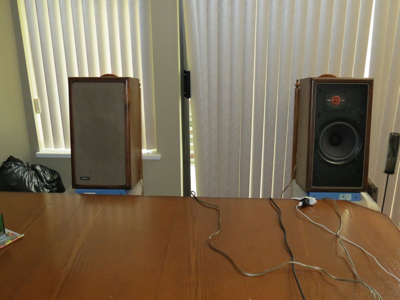

And oh, did I tell you about the lonely Large Advent cabinets I have? There's a member here, I forget his name right now, but I think it begins with ph or something, has offered to send me a pair of woofers? I couldn't believe my luck. Outta the blue this fellow just up and volunteers them. First he gave them new surrounds, then he broke them in for me and the latest I hear is that they are packed and ready to be shipped. Can you believe it? In this day and age, this kind gentleman has simply gifted them to me.
Thank you Fred, I am really looking forward to them.
Well since my post was a show stopper, how about we have a look at what showed up today. Hey Fred, these Large Advents are a classic sound. I'm only a few songs in and can I ever hear what was so popular about these puppies.
