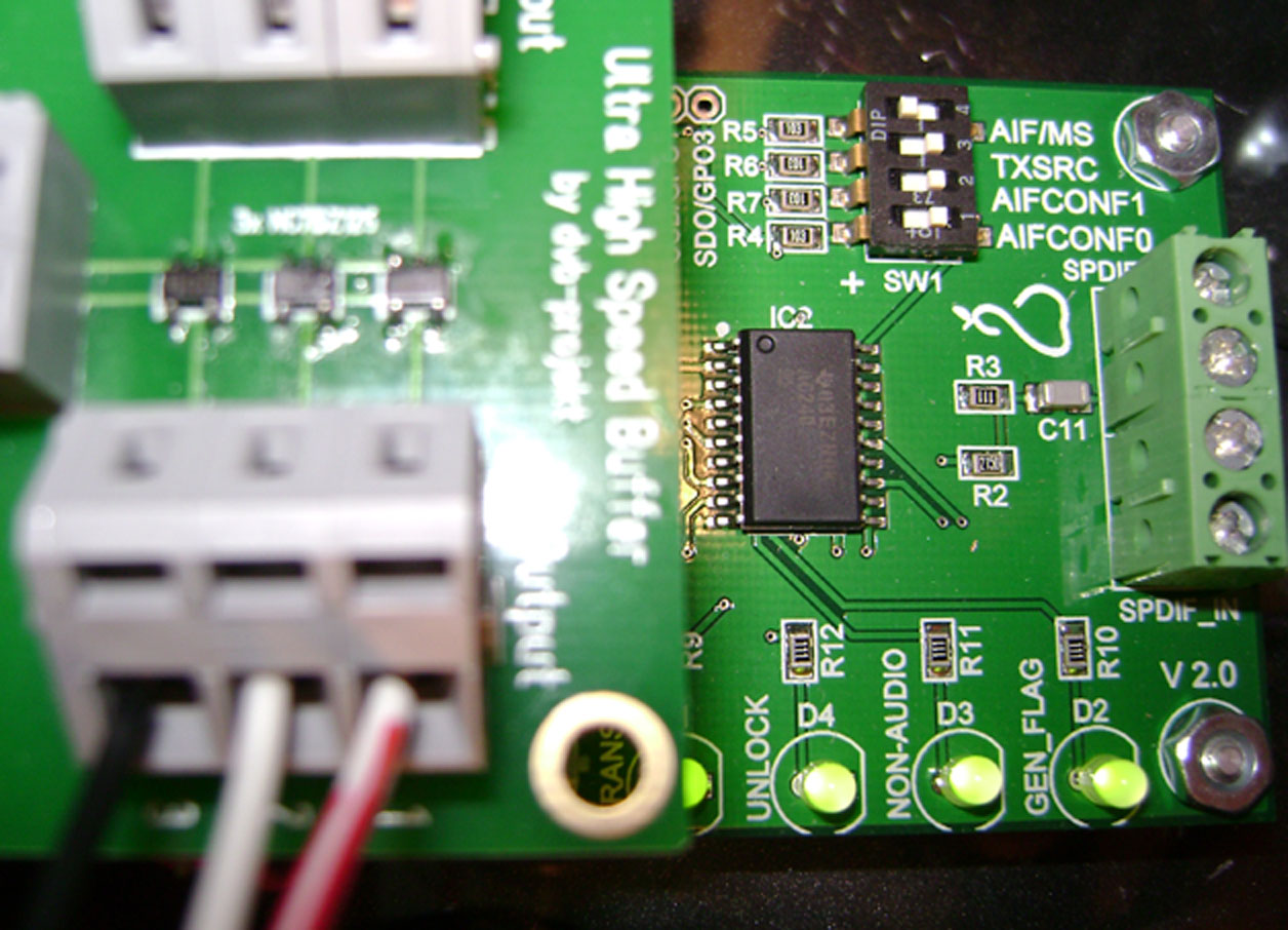

Hi Ned,
please post some pictures of your setup. I would like to look especially to the DIP-Switches on the TP SPDIF converter.

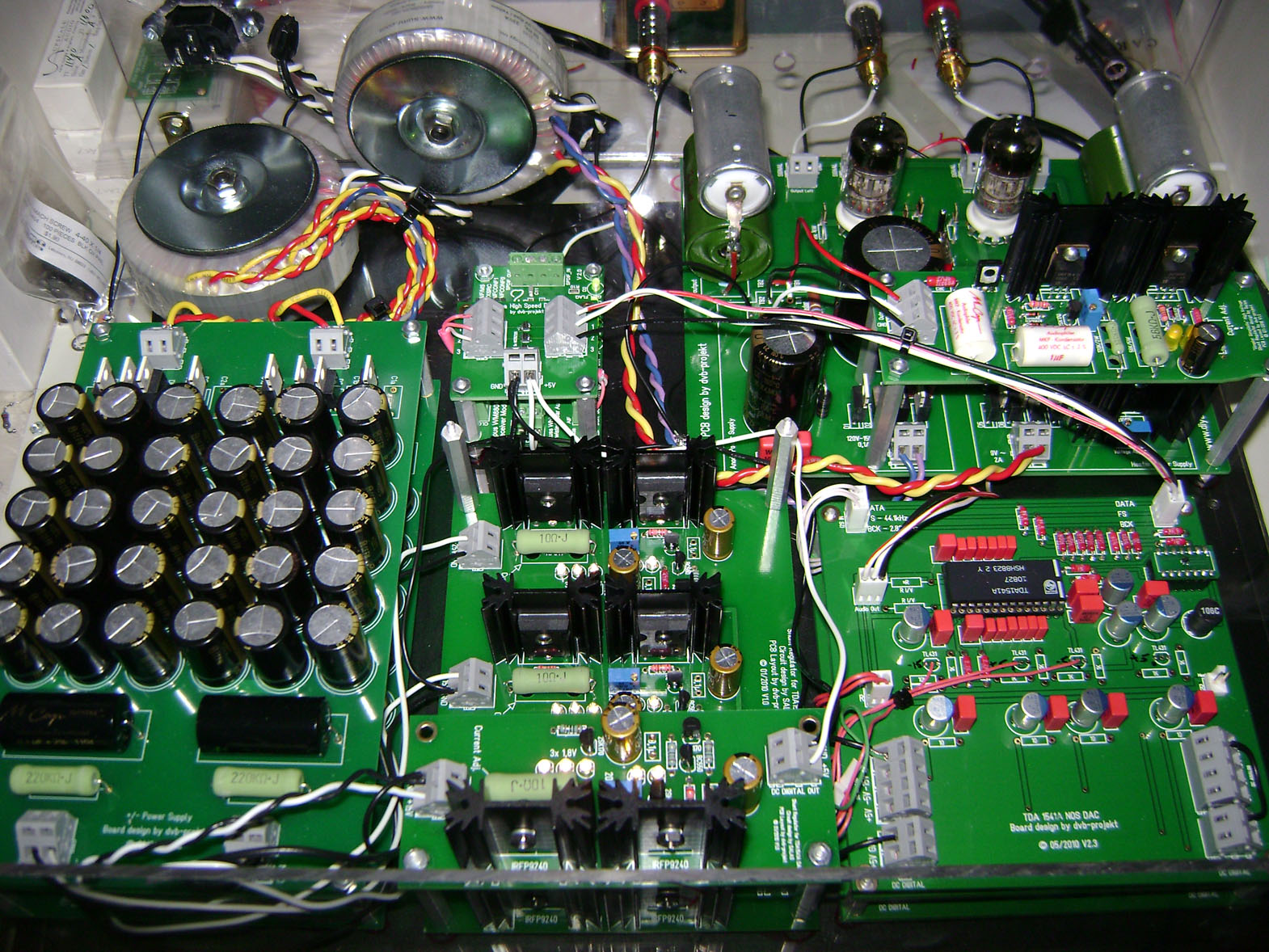

Hi Oliver,
When I touch the meter probe to the BCK terminal of the buffer board I get distorted sound from both channels. Remove the probe, and I get clear sound from left channel only.
I can advise you here neda, as I have also faced this issue.
This is related to the use of two sets of shunt regulators. The Salas shunts are more than capable of supplying excellent, consistent and ripple-free supply to the DAC, but the TL431 shunt regulators that are in the way make things less simple.
Essentially, you have two options.
Option one, which is by far the simplest, and something you should try until you get a chance to operate and go with Option two, is to turn the Vout of the Salas shunts up to around 7vDC -7vDC -17vDC, which will supply the TL431s with sufficient voltage that they have some work to do. This should solve your immediate problems (but do check their output voltages are around 5v -5v & -15v).
Option two, is something that I was the first to do with this project. Remove the TL431s and all associated Cs & Rs. It is all discussed in great depth in this thread, and Oliver gave some great advice on where to "inject" the Salas shunts after removing the TL431s. The improvement is considerable. Several people have tried this, and all have so far recorded improvements. Oliver's latest V3.0 DAC board is basically a neater version of the de-TL431-ed board, with some refinements, I believe.
Hi Lucas,
As you can see from the photo, I'm using option two.
The second +5v line is bridged from underneath the board.
Ned
Joined 2009
Hi Ned,
Hi Oliver,
Hi Ned,
looks real great!
The settings on the TP are correct. Two questions:
1. Did you power up the whole DAC with an SPDIF input signal or without anything?
2. Did you try to disconnect one of the DAC modules?
:wave:
Hi Ned,
looks real great!
:wave:
Hi Oliver,
First I powered it up without the transport, and set all voltages then powered down. Next I connected it to the transport, powered it up, and everything worked fine.
The next day, like a fool, I decided to play with the dip switch settings to see if it had any effect on the sound, cycling on & off between switch changes. That's when my troubles began.
Could I have possibly burnt something out by cycling to quickly?:headbash:
No, I did not try to disconnect one of the DAC modules. Should I?
Ned
Thank you Oliver & Lucas for your help, I found the problem!:D
It was what we learned on our first day of electronics 101.
Make sure your GROUNDS are tight!!!:yell:
The input gnd to the converter was loose.
We're back in buisness, and sounding good, but still have a long way to go.
