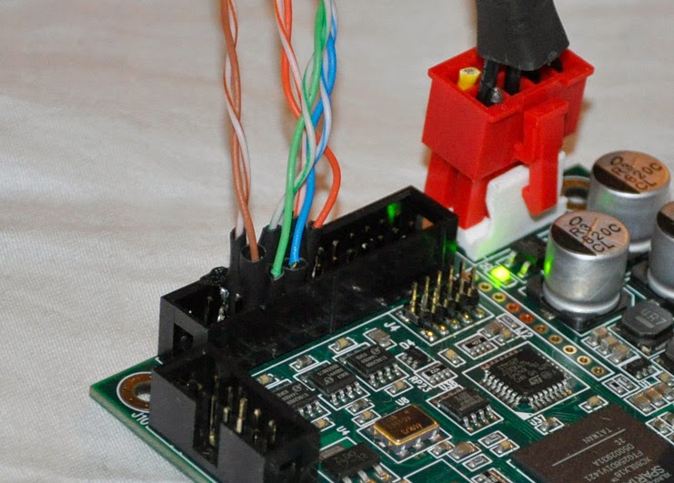

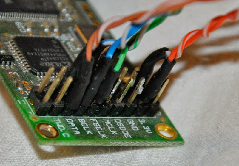

BTW: In my experience the Amanero is prone to clicks & pops when changing either sample rate or tracks - mostly so in foobar and less so in JRiver (although it's still there to some extent).
I have never experienced any clicks or pops w. SBT, Amanero and my R2R dac.
Thanks for the info Sebastian ... Wonder why it's on mine then :confused: ... It's been there on all the PCs I've tried (3 very new ones).
Things to ponder ... :scratch1:
Jesper
Can you post close up photo of your connections, quite a few of us will be using amanero.

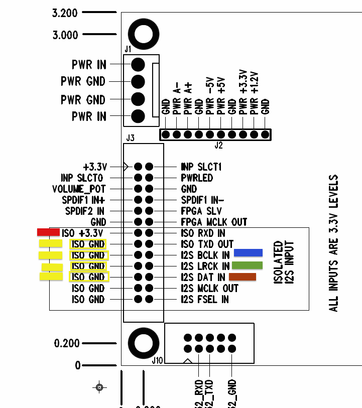

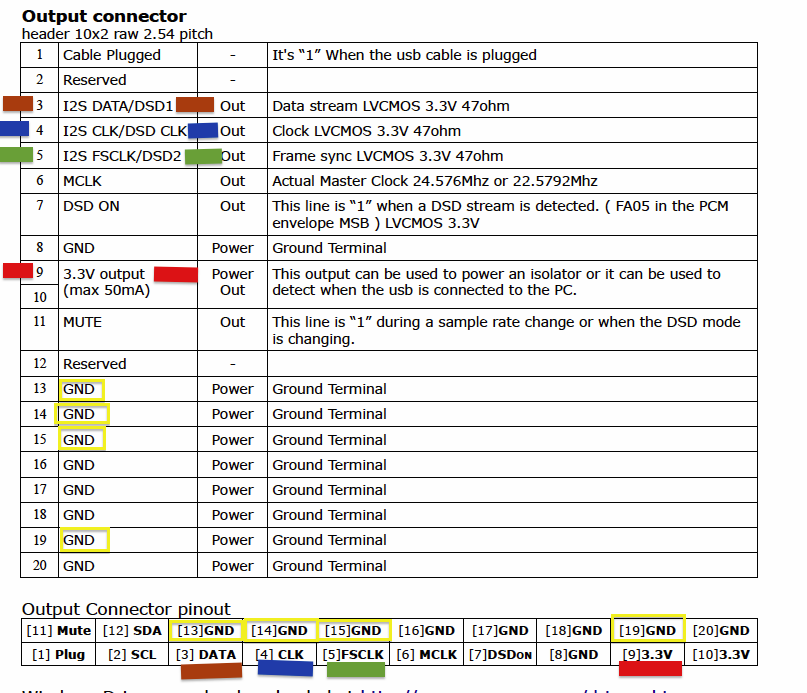

Well, here are some photos. I doubt they're very useful as it's quite hard to see what is going on. On the Amanero board the solid color leads are aconnected to DATA, BCLK, FSCLK and 3.3V. The other leads w. white stripes are all used for the corresponding GND headers.
I'll try to mark the connections on the Amanero and DAM1021 diagrams.
