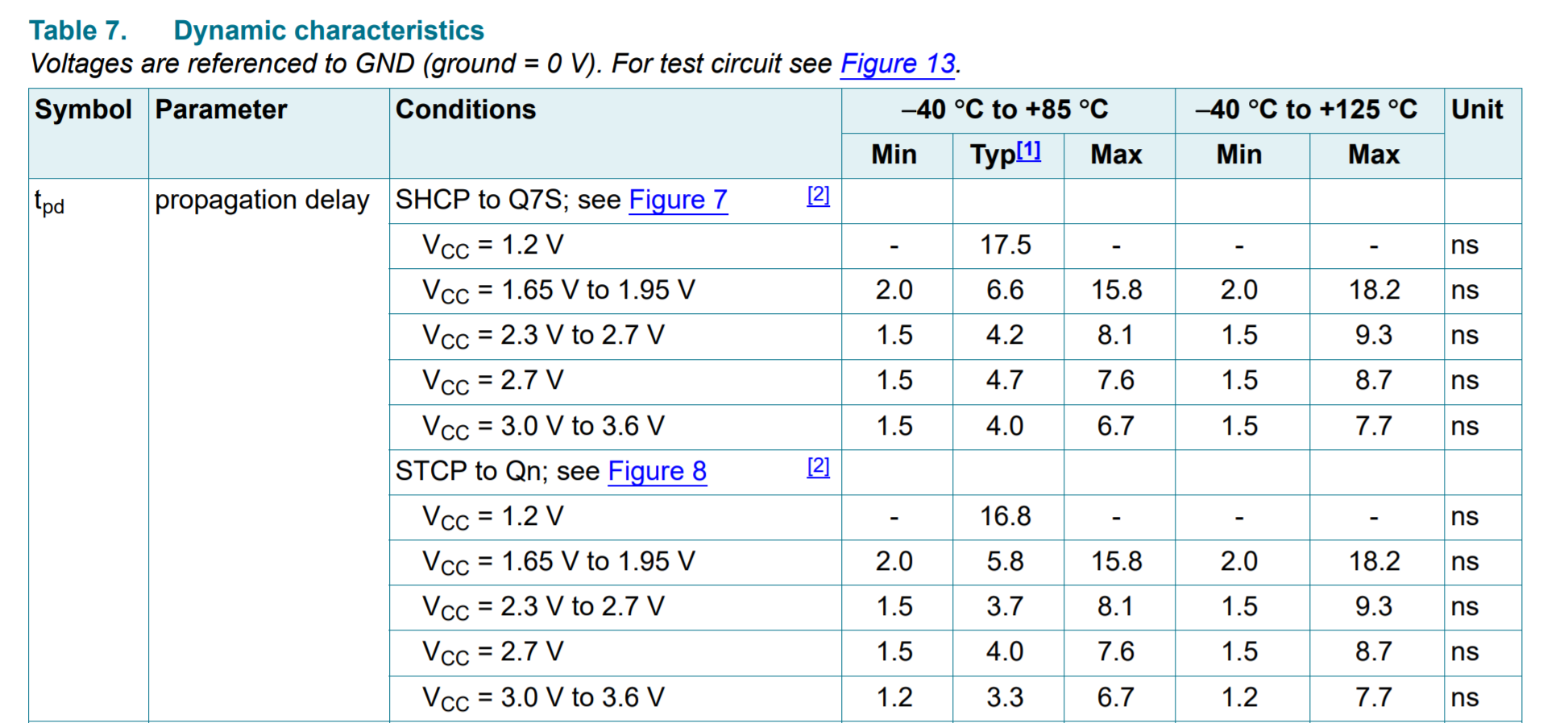

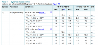

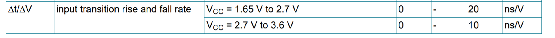

Just a reminder of the LVC595 electrical properties. Those are all in the nanosecond range. None of it seems to show up on any of the tests, does it?
I wonder what happens in delta-sigma systems. They use terrestrial transistors like anyone else I suppose. I don't know whether any of this is audible, but it sure feels nice to have a system that is pretty transparent to our understanding - maybe it's a luxury :)
