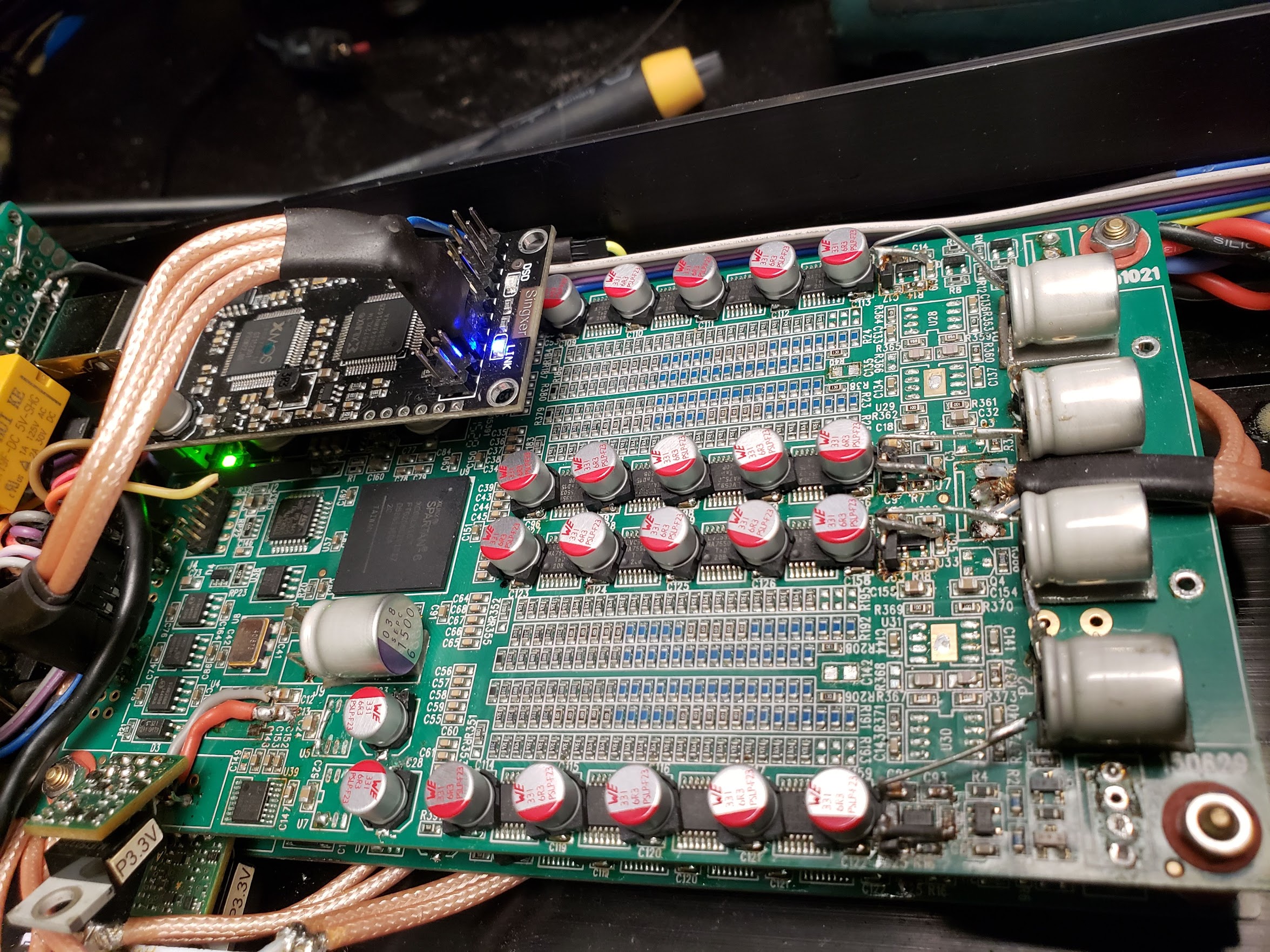

I killed it by being tired and doing the (just this last tweak for today). And by connecting ground of the battery to the circuit and then touching with the plus 3.3v wire the metal case of the clock. Just a small spark and then.... silence. For a long time

Yes, probably firmware is stopping us. But honestly, I dont think it is a big difference between 514 and 570, there are more important tweaks as mentioned before.
Yes, that's why I am reluctant to go the battery route completely, too small everything. But I will try it for the clock though, letting the battery act as a huge cap being charged constantly by the inboard regulator. I did this with the USB board with very good results.
Might be the traces on the board that's "limiting" the jitter performance we can get. If you're confident performing the mod it's probably okay
The funny part is my original dam1021 that I did the 16 cap mod to sounded similar to what I hear now, I felt I lost something since going dual-mono and adding less capacitance to vref on the basis that it wasn't really needed, but it certainly is all back now! Running roughly 3200uF per rail now factoring in the ceramics. More caps you can tie closer to the shift registers are likely better than a few single larger ones. The smd caps I used specifically digikey part# 732-6399-1-ND

Congrats on the success! It does make sense. Longer trace = more ESR ESL probably. And even large electrolytic caps don't have the ESR that multiple paralleled small polymers do, though the shift register internal resistance limits what we can get out of low ESR according to Soren. Also interesting that adding 1300uf improved things when there's already 1500+uF each rail. How much capacitance did the caps have in the 16 cap mod?

Looks fine to me. You can potentially get to <10mR or >1500uF with Nichicon/FPCAP but if they're harder/more expensive to get then don't worry about it. Do make sure that the leads are 0.6mm if you're using it for dam1021, not sure what is best for 1121 maybe 0.8mm is okay too.

The original 16 cap mod was 4x 680uF per rail with those surplus Sanyo purple things, can't remember exactly. It was roughly double the 1400 I had and connected to those same pins. ESR likely plays a big role in this as you said with the parallel caps, maybe go for a larger ripple current rating also.

It's probably nice that you have different kinds of caps paralleled and in very good locations. But we probably need actual simulations to tell for sure how much difference each specification makes, if the change in sound can indeed be reflected in available measurements. For me, there is something really unappealing in pushing my ears to hear subtle differences and trying to make strong statements with it. However, the change this time due to vref was simply impossible to ignore. If my standard of naturalness/musicality is, as I believe, more or less true to the sound of musical performances, then this mod really takes the DAC to a different level.

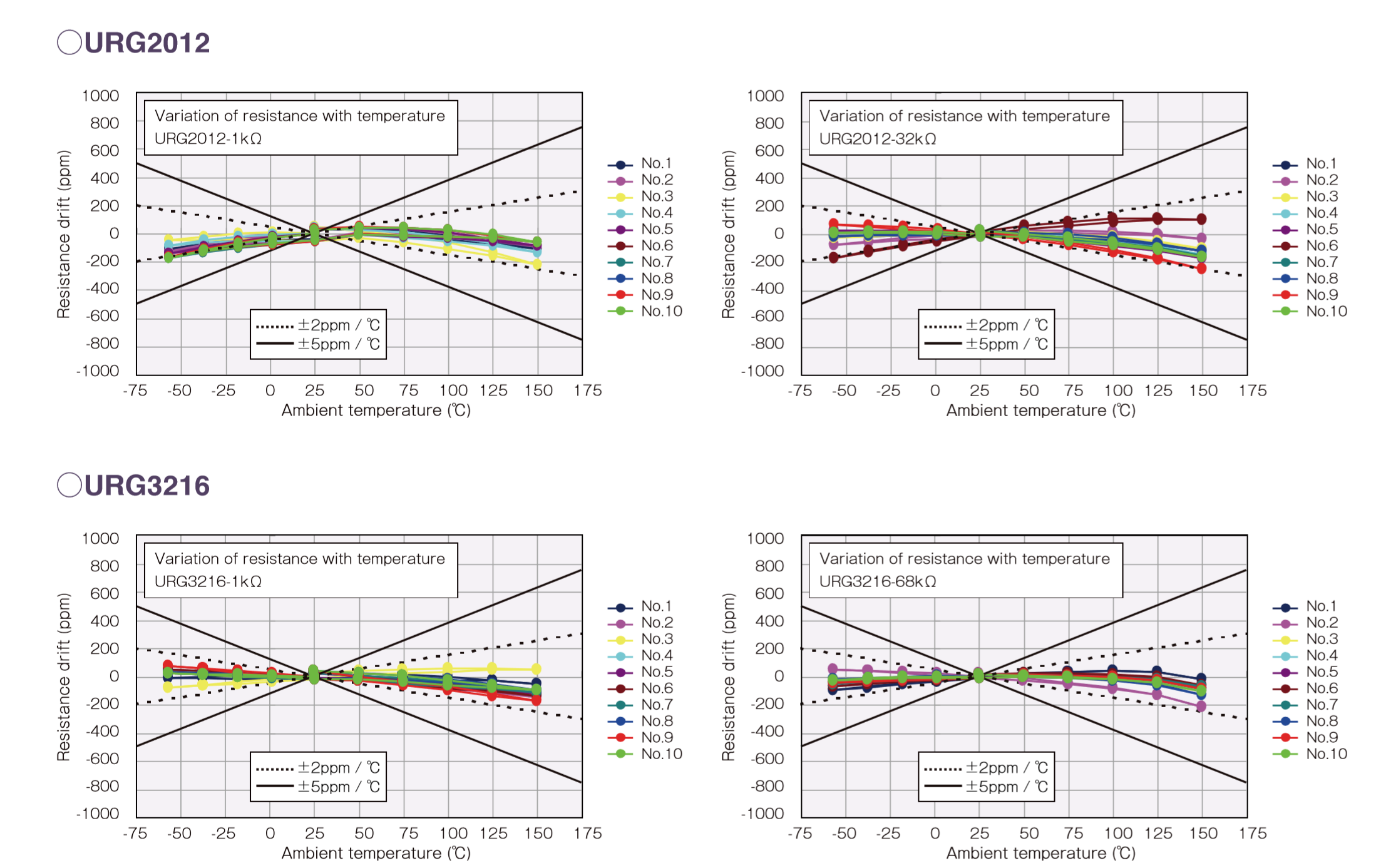

Temperature coefficients of quality thin film resistors usually follow a parabolic curve, so the max spec is usually at the extreme ends, which for the used resistors is -55 deg C and + 125 deg C, so a little elevated temperature is nothing to worry about....

The goal is to get the vref impedance low over the whole frecuency range, the opamps take care of the low end, the ceramics take care of the high end, so adding electrolytic capaitors is to handle the mids.... More capacitors should have low ESR and low ESL, polymers are very good, so is large low ESR regular electrolytics....
It's a good thing to do simulations, assuming you have good models, you want to end with a constant low impedance over DC to 1M....

I thought they could drift in different directions.. would be nice if ours happen to not do that though.
That's helpful information. I couldn't find much on thin film resistors but here're some measurements from Susumu parts. Note drifts in both directions. Though these thin films don't have the tight tolerance parabolic that Vishay metal foils do, it's fine I guess given the price point. It might be somewhat true that at temps closer to 25C TCR is a bit lower than spec and maybe a lot lower in some products. I would still recommend that temperatures be kept as close to 25C as possible, but unfortunately there's not much I can do in my build since I use buffered out which probably makes 9V DC minimum. Can't improve air convection much at the moment but if I ever get the chance I'll open up some slits on the top/side. There're slits on the bottom. But alas, who knows if this will create more imbalances... At least everything is probably equally toasty now.
Soren, are there TCR test curves for the resistors used in dam1021?
