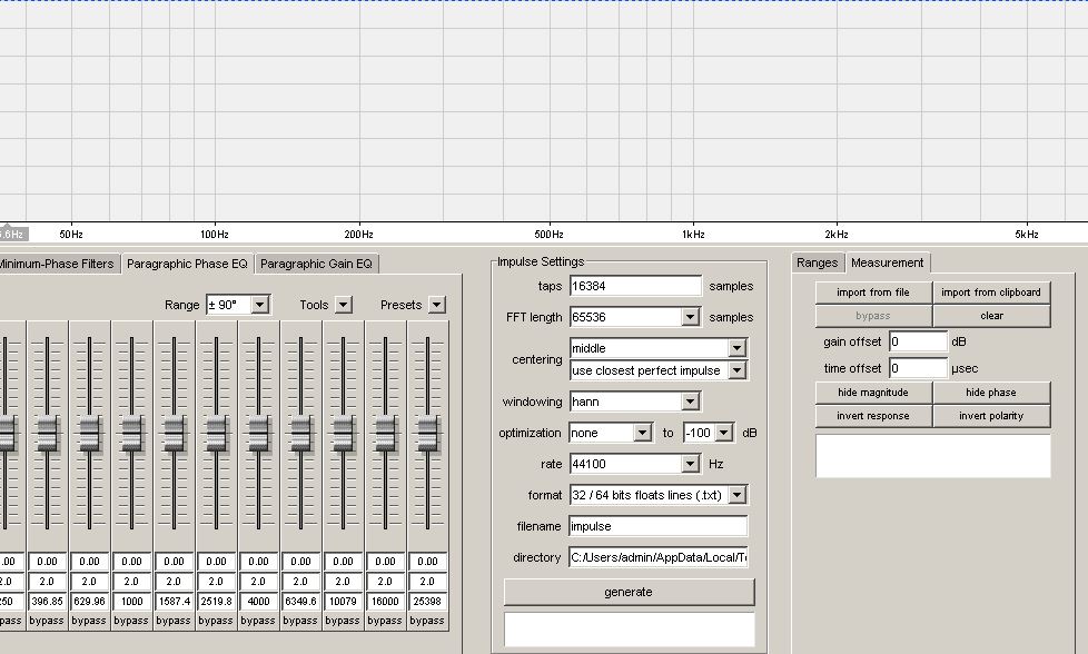

hi bambadoo how did you use it any specific settings that you are following for the best performance?Yes. Rephase is a great tool. I have used it for the dam1021 many times
Hi Soren can we use rePhase FIR tool from rePhase to generate FIR filters and load them in the Dam 1021 or any other series?
Yes. I did all the stock filters in rePhase.
