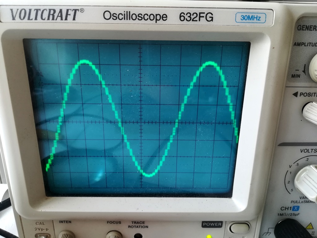

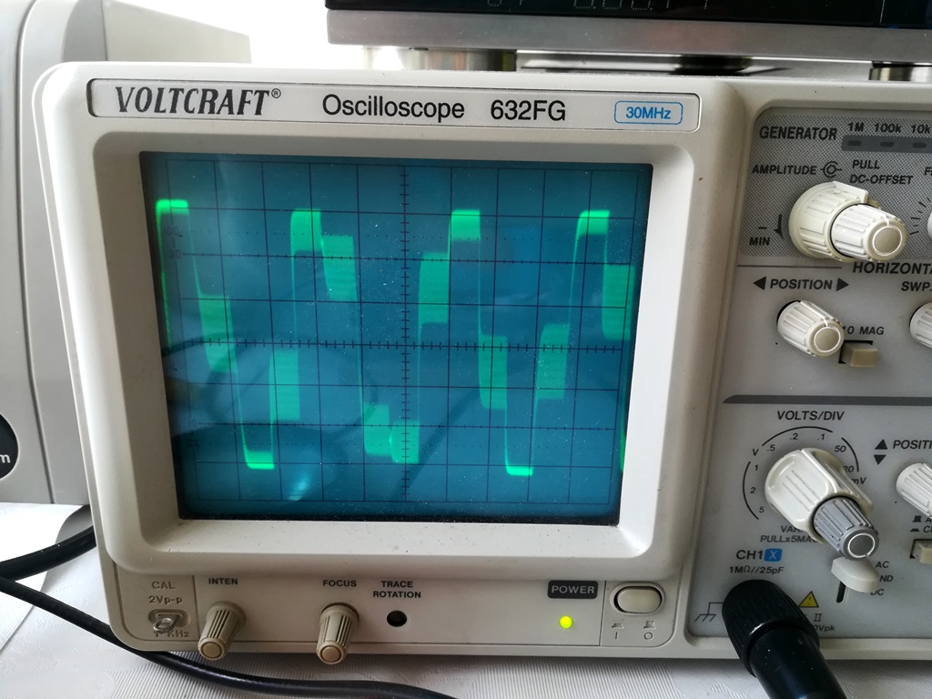

Today i made some mods for my friend to soekris first revison of dac board, that you recomendet.
I did some measurements with 1khz and 10khz sinus wave. Can anybody tell me what is default filter settings for Soekris board...this looks like it is in NOS mode? He has less computer skills as I so he didn*t reprogramed any filter. Can*t be true that when you buy that board default setting is NOS... because that is not even close to specification for thd. I am not interested in NOS dac and i read that is R2R dac with proper measurement specifications. If you listen to that filter and describe how good sound is ... no comment.
Can anybody give me some hints how to change that ...i am not computer specialist.
Which filter should i choose or what do you recomend...i am not fan of a sharp filters.
Sorry for maybe hard words but i am very disapointed with measurement and sound is also ...

AFAIK there has never been a "factory installed" NOS filter in any DAM.
Regarding the built-in filters, from the manual:
"FIR1, upsampling from incoming sample rate to 352/384 Ksps in one step, with different filter lenght based on incoming sample rate. All FIR1 filters are basic Parks-McClellan "brickwall" types, designed with http://t-filter.appspot.com/fir/index.html, but still shorter than your regular DAC.
IIR, bank of 15 biquads operating at 352/384 Ksps, with one used for the CD de-emphasis filter, none otherwise used for the basic DAC.
FIR2, upsampling from 352/384 Ksps to 2.8/3.1 Msps, reasonable short and soft but still using same design as FIR1.
All filters are using 32 bit coefficients, with up to 67 bit MAC accumulator."
Are you 100% sure that your board has the original filters set? Did your friend buy it direct from Soekris?
Did you try selecting one of the other available filters to see if the measurements change?

Stock filter should definitely not look like that...NOS on the other hand does. So either filters where swapped on that board or the software is defective, especially since there is no NOS in the original factory bank...
