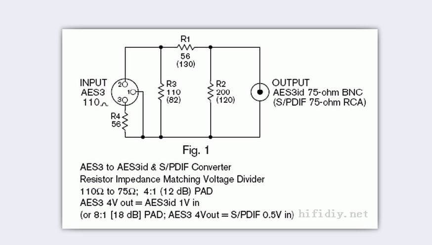

I use this one (the values in bracket), it works.Is there a schematic for AES input? It requires different voltage and resistor values, correct?
